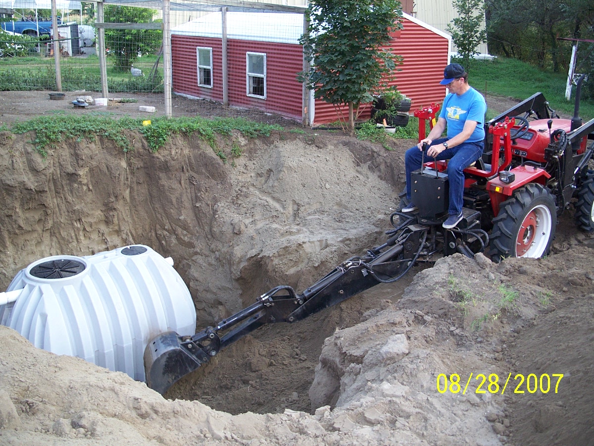

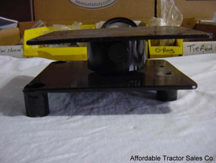

As to your seat problem. The seat you have looks nothing like the one that came on my tractor. When I bought it, I had a choice of swivel seat or not. Since I was getting the backhoe I opted for the swivel. There is a plate that mount to thr top of the hydraulic tank and there are two two sleeves that overlap with a hole going all the way through. You pull the pin and the seat swivels 180° for backhoe operation. I have the frame mounted backhoe and the swivel seat is completely worthless. When it is turned around there is no way you can get it to slide far enough to the rear to be able to adequately reach the controls for the backhoe, and I am 6'2"! What I wound up doing is folding the ROPS bar down and sitting on that. I even made a little clamp on pad to sit on. That also gets me up higher to be able to see into the hole better. 100_0846.JPG

Yup, that is the base that came on my tractor. The swivel works great but the seat is way too low to use with a frame mounted backhoe. See the picture above. The problem when sitting on the seat when reversed you can not adjust it far enough back to easily reach the controls and you are so much lower that it makes looking into the hole difficult.
It might be OK for a 3 point backhoe but I have no experience with that.
I was sitting on the back of the seat but that was terribly uncomfortable for any length of time. I have seen backhoes where the seat swiveled and was mounted on a folding mechanism that allowed it to rise up and move towards the back at the same time. I considered making something like that until the ROPS folding came to mind.

Built my own swivel seat for my frame mount jw-03 hoe...
