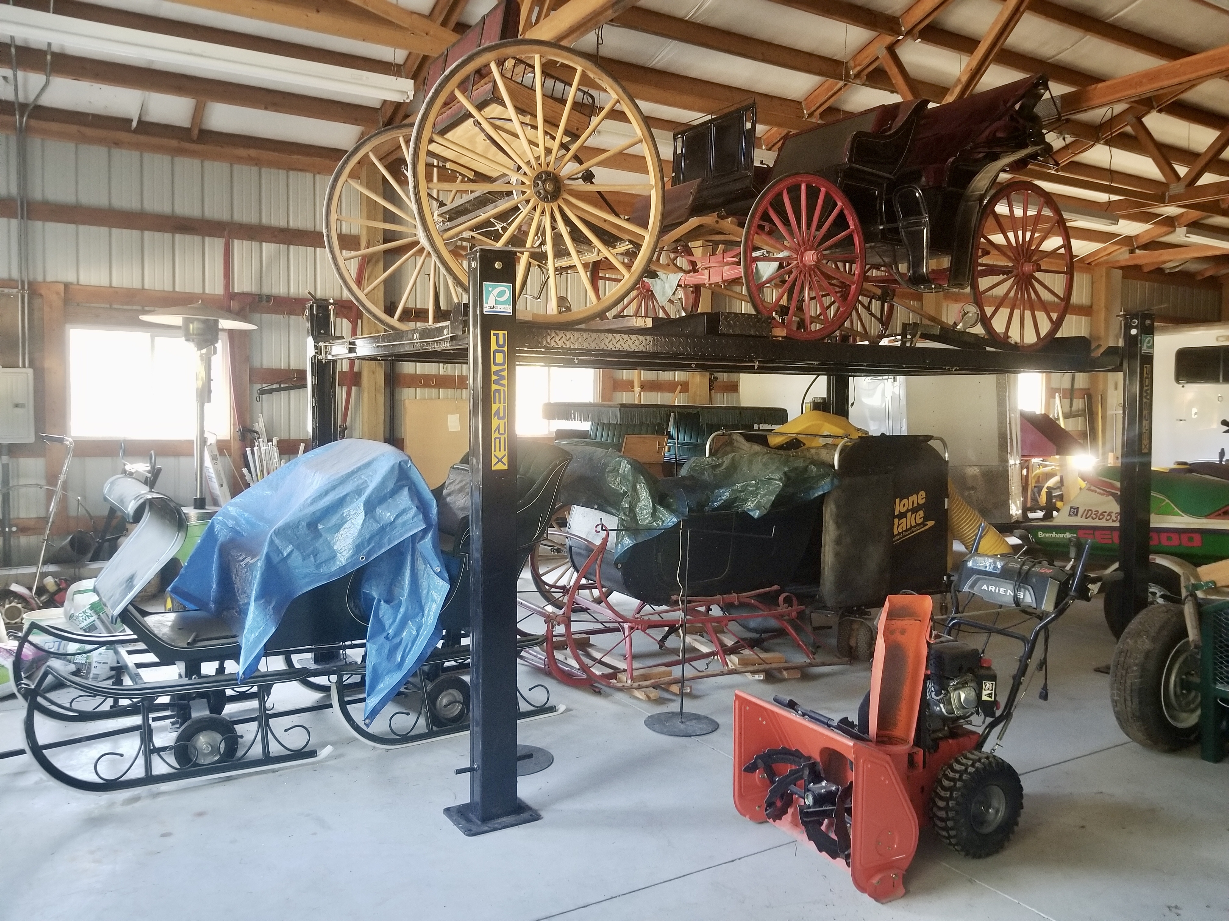

   / Two Post 12k pound vehicle lift #9
Right now, my new lift is temporarily being used as an amish carriage lift….until i can relocate it next year to a better location. I sure wish it was a 2 post.
But it does free up some winter storage space for me
