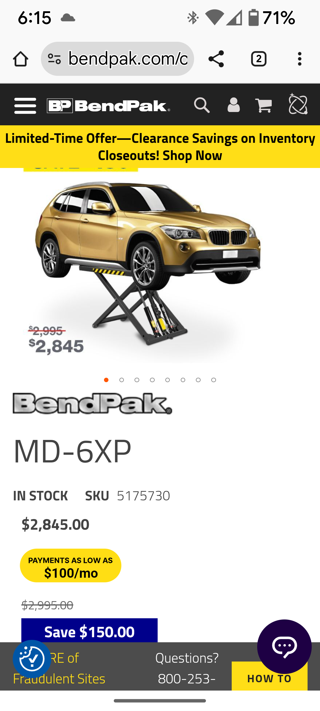

I bought one two years ago, not as nice as yours, but keeps me from working from the floor. I bought a Mid rise and I can now do everything I do on a car from a rolling chair or standing.
I do oil changes, tire rotation, radiator replacement, couple radiator drain and flush, brakes (about to do my 3rd complete brake job) and anything else I don't want to pull a jack out for.
Come to think of it, I haven't used a Jack since I've bought it.
If you add up all of the work I've done and numerous oil changes. It's probably already paid for itself.

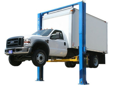

Pouring the concrete in my shop today... I have a footer prepared for a 2 post 12k pound capacity vehicle lift.
This is the lift I have coming.
ATLAS PV-12PX
Those of you with lifts, what do you have? Would you do anything different?
