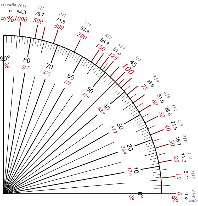

I suppose this is nit picking but you are not taking any tractor over a 45 degree slope other than to slide down it once if you are lucky. A 45 % slope, sure, but NOT 45 degree. A 45% slope is roughly 24 degrees. A 40% slope is "healthy steep" for a good low profile 4WD tractor and 50% is a sensible upper limit. A 45 degree slope is a 100% slope. See chart below.
Thanks for the chart-I think its more like a 25 degree slope based on the chart attached.
