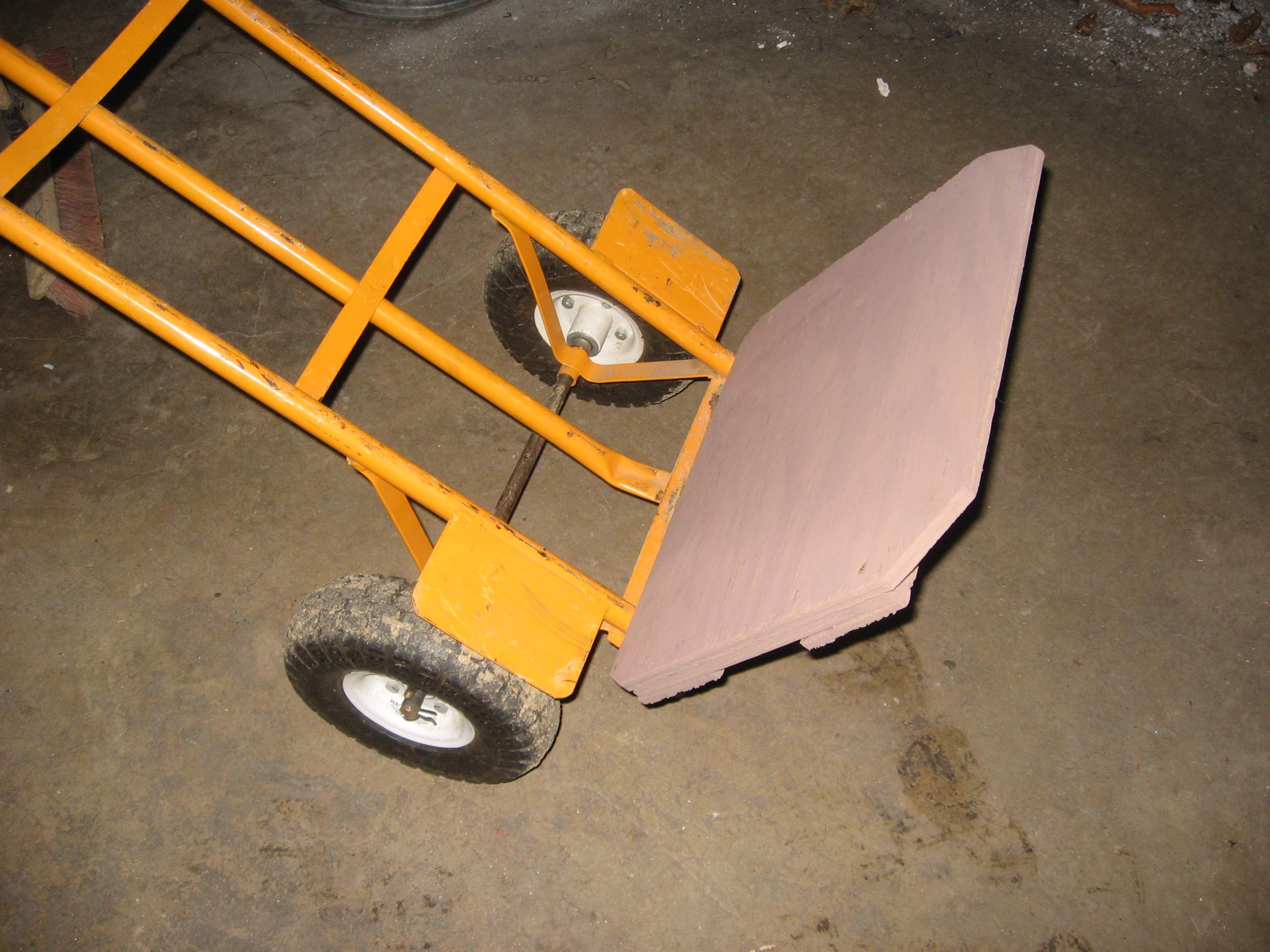

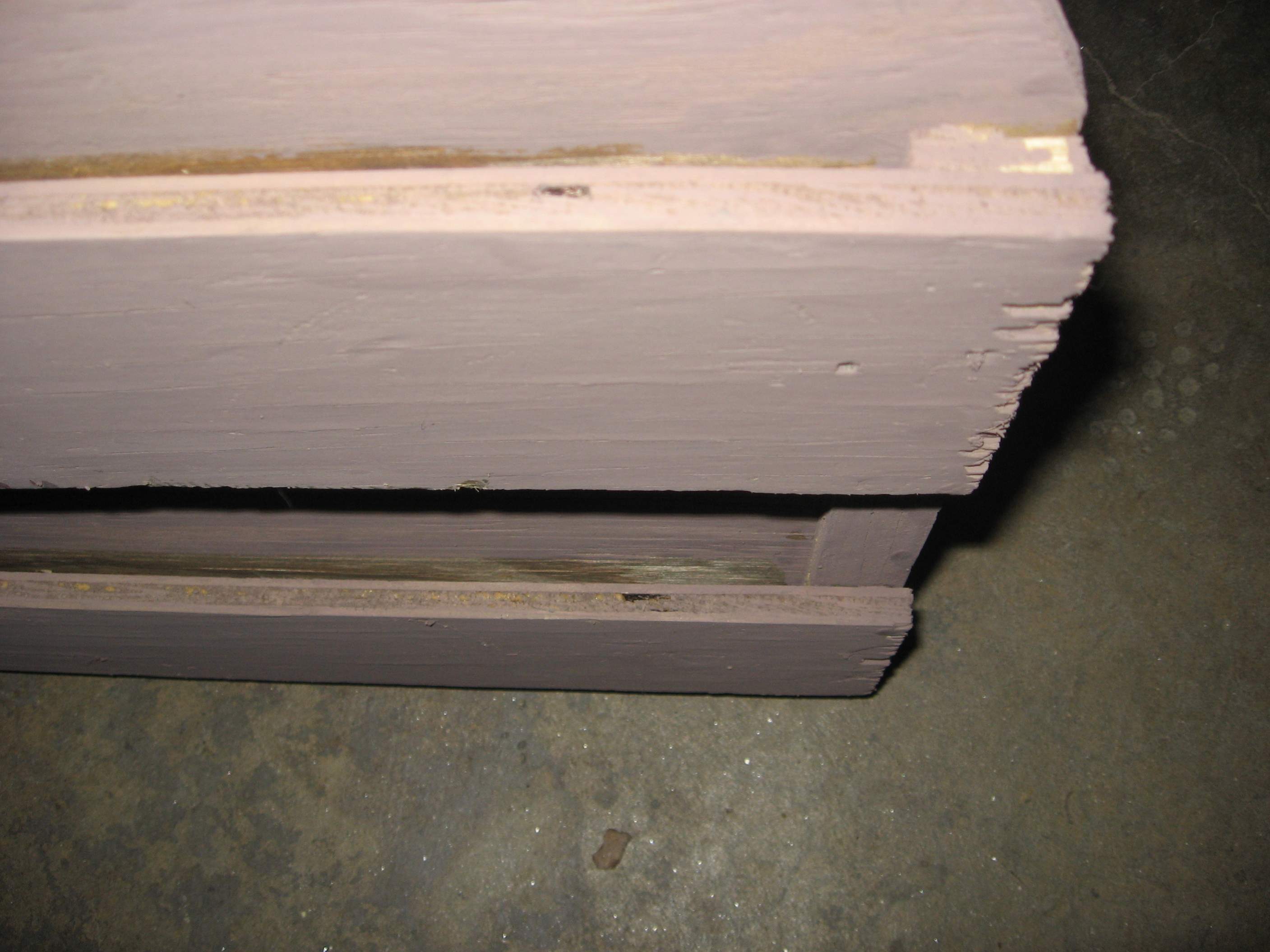

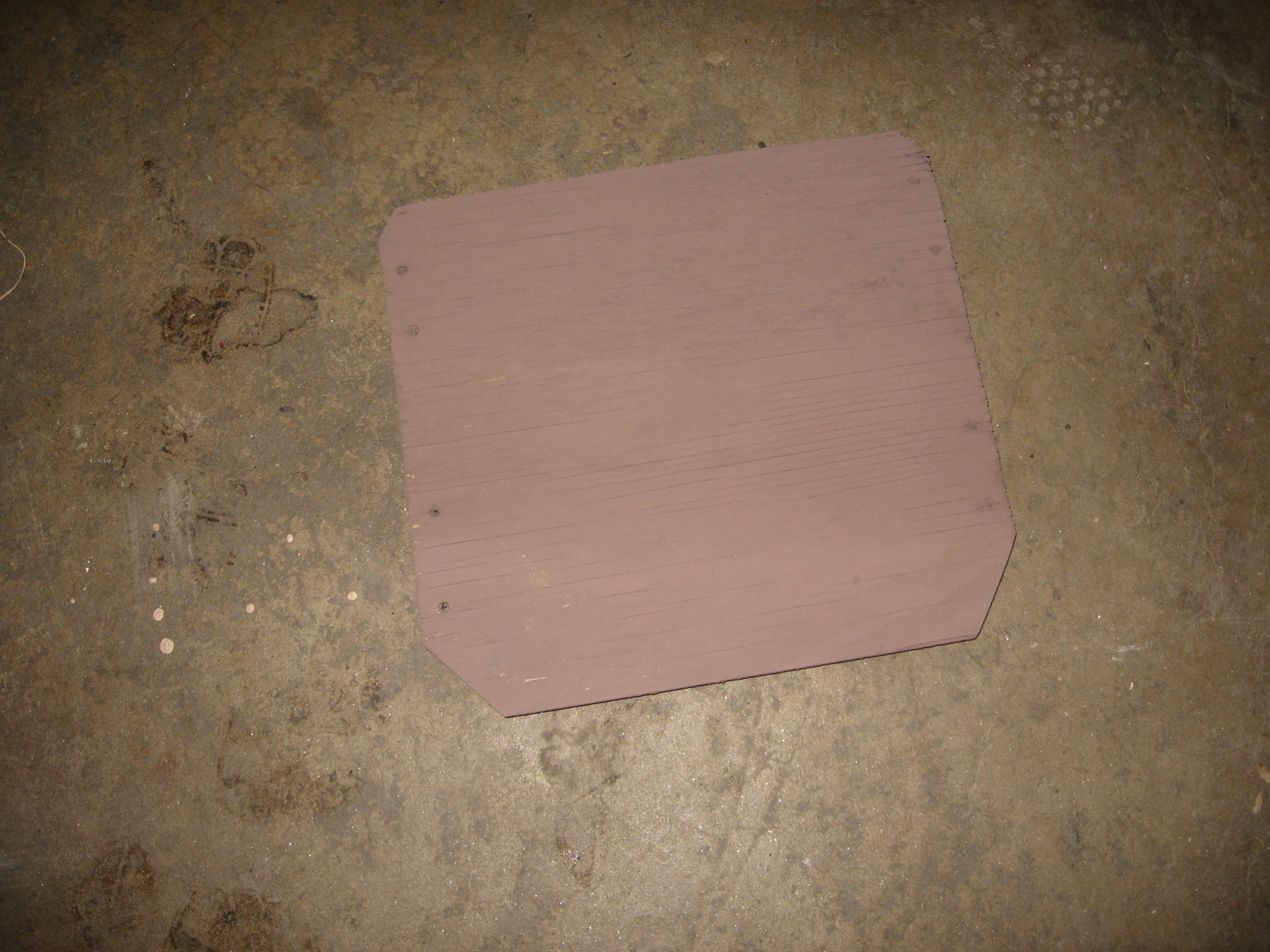

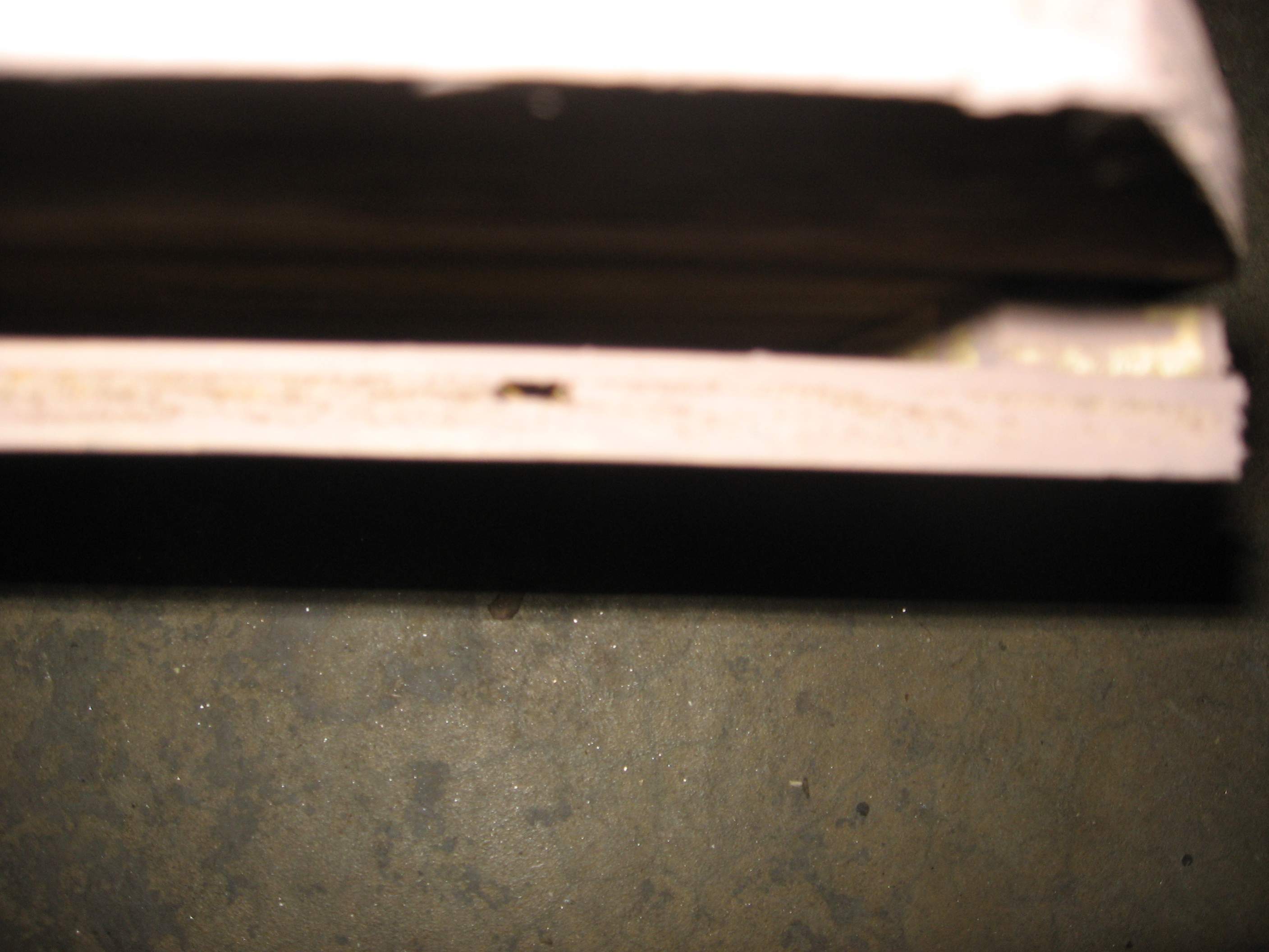

Just wanted to pass along this small thing I made for my two wheeler. It was so simple to make yet so handy, I make several more to have things mounted on it. Such as a blower fan, and a box for driveway sand for the winter, trash barrels
Its nothing more than a piece of plywood with two cross sections on the bottom spaces out ny a couple of strips of 1/4 inch plywood.(the spacer is the to accommodate the metal blade of the two wheeler.)
I plan to make a larger model to handle tires.:thumbsup:

I've used metal on a couple of those, but only the ones that had solid tires. They work great especially if you add a strap or 2 on the arms for awkward objects.
   / Two Wheeler mod #4
nifty... might just have to steal that idea... ;) hope you don't mind, thanks
