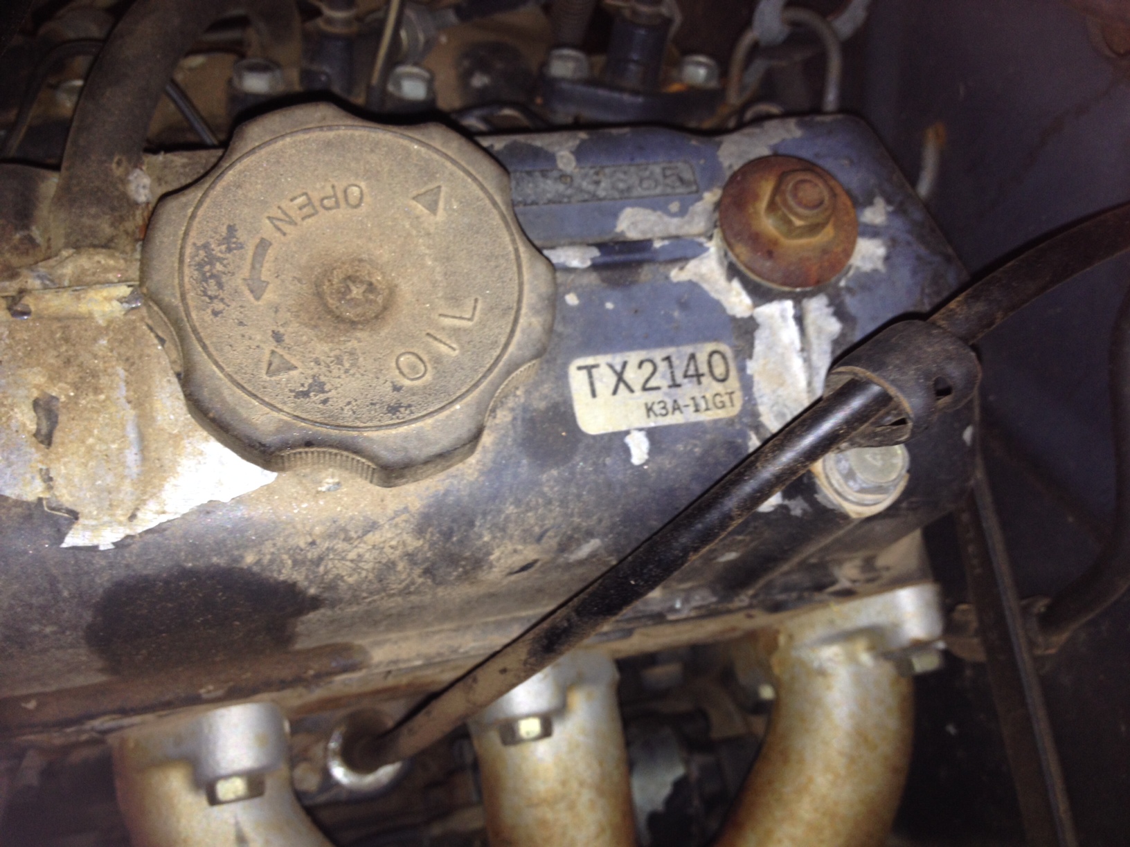

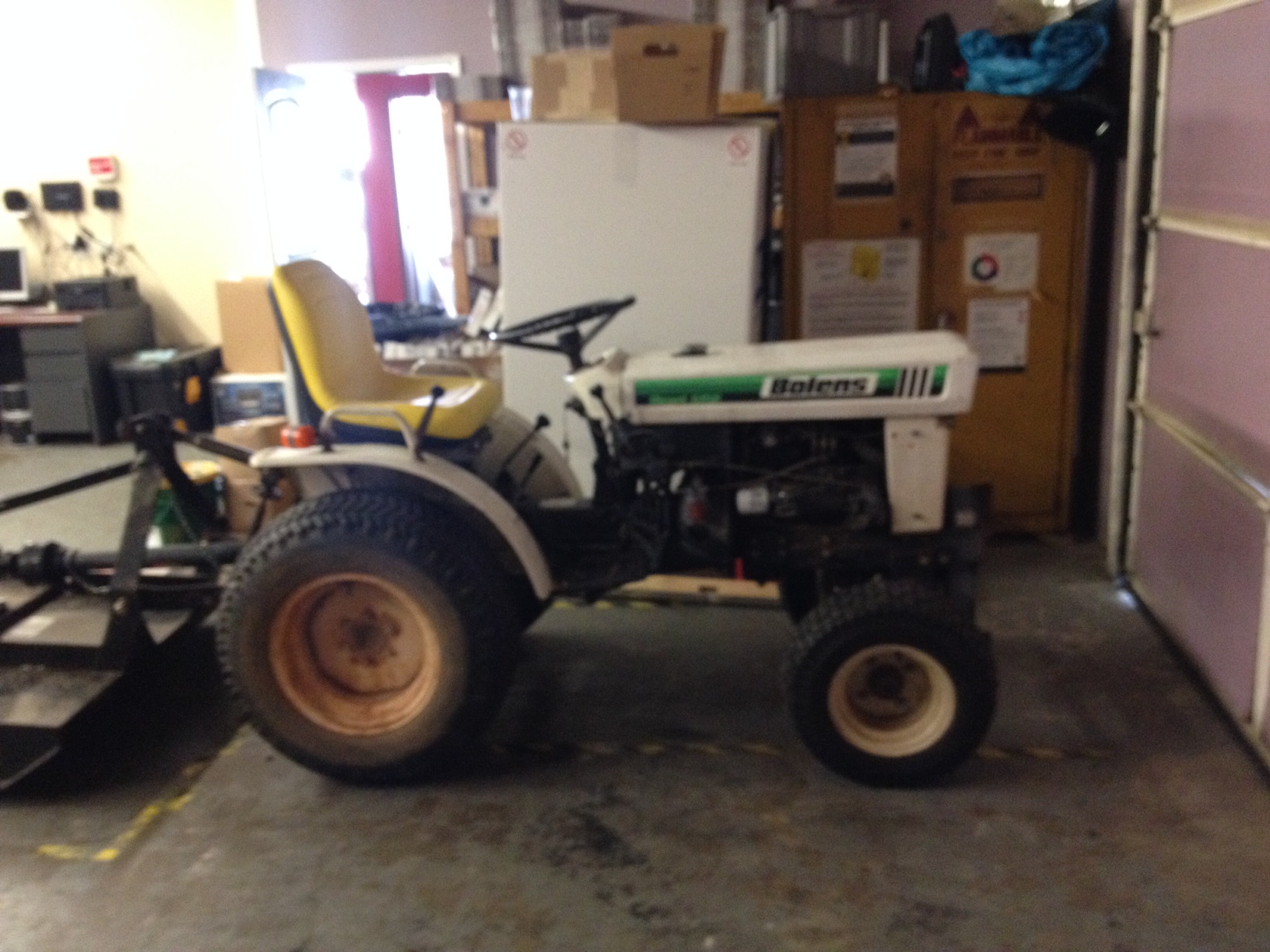

   / TX2140 with FEL 80w Gear Oil or UTF hydraulic (Tx2160,g154,tx1500,tx1300) #14
Hi Dave,
So, I believe You have a
Manual Transmission with Clutch,
2wd,
The little HP engine, (15HP vs 17hp)
3 cylinder Mitsubishi K3A engine (vs 2cyl Iseki engines)
This means you have a relatively newer (Bolens imported) unit late 80s-90s
One of the last ones Bolens imported.
I think you nailed it!
The Engine is a K3A-11GT
Thanks for the great info! Yes, the boot is cracked a bit and I'm sure it got some water in that way. Someone on another forum recommended using ATF in it but just didn't sound right.
Pick up a 4' bush hog and got it on last week and tested it out over the weekend up at the farm and was really impressed with what it could do for such a small tractor.
I'm located in Atlanta, GA

Hi Dave,
   / TX2140 with FEL 80w Gear Oil or UTF hydraulic (Tx2160,g154,tx1500,tx1300) #16
Warning:
With the Brush hog you may want to get and external override gear for the rear PTO.
I had a Big Brush hog on mine and the inertia from the big high speed heavy blades
would keep Mine driving the wheels for a long time.
The clutch stops the engine driving the wheels but the PTO is hard connected to the rear wheels.
Doesn't seem to be the case with this one, when the clutch is depressed the tractor stops while the blades free wheel to a stop when testing it in the shop. Was cutting some fairly heavy weeds/grass/briers that was knee deep at 2400 RPM 3rd gear low range and the PTO in second and did a really nice job and only a few times could you hear the engine needed to power up on the governor in some spots.
Ended up changing the tranny fluid and used the recommended 80# gear oil as described on the decal under the hood. Hadn't seen it before as it was covered in grime!
The original fuel filter assembly was leaking and the plastic bowl was so old that you couldn't see through it so replace it with an OEM from Sam's Bolens parts last fall. Changed engine oil with Shell Rotella T and a Wix filter along with flushing the radiator and new coolant. Also replaced the low oil pressure switch that no longer worked along with the seat that had rotted out and 2 new front tires.
May replace the 2 rear tires this fall as they are dry rotted with some AG tires possibly this style Two New 29 12 50 15 29 1250x15 Carlisle 6 Ply Compact Tractor AG R 1 Lug Tires | eBay Haven't spent much time looking at tires so there maybe a better alternative out on the market.
