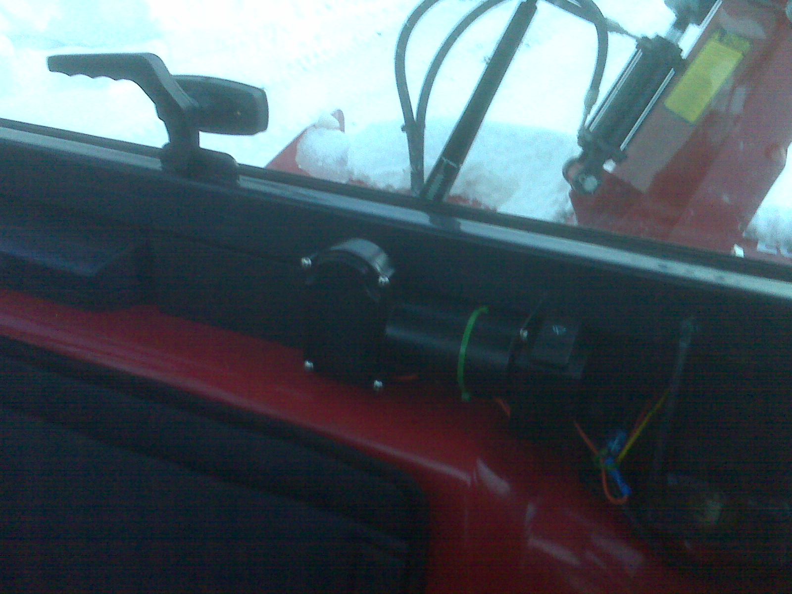

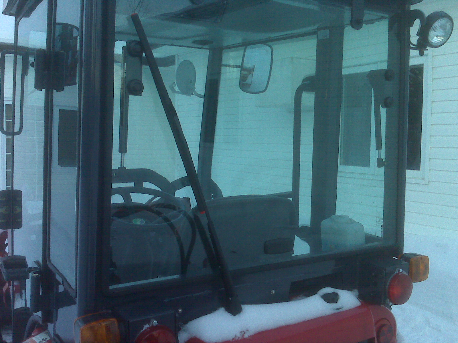

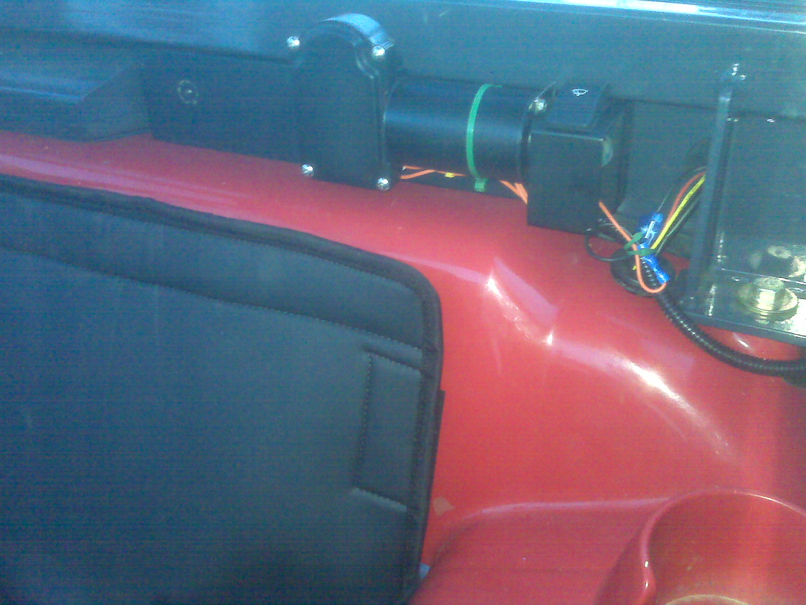

Hi,
I've purchassed a wiper motor from a car parts store in town. It's a boat wiper motor with a 2-3/4" shaft and a 80 degree sweep. I had to build a support made of hard wood for it because the way the cab is made, the motor would not fit by itself. With the correct wiper arm, I was able to fit a 18" blade so I cover a good part of the window area with it. The motor+wiper arm+blade+switch cost me a bit under $200.00 I know it's not cheap but when I compare with the dealer who wanted $465.00 to install one, I think it's not too bad. And I'm pretty sure I have a better window coverage with my setup than the one they would've installed. I've attached some picture of it. Hope it worked.
Thanks

   / Tym 293 HST with factory cab #17
Hey Crazytym,
Nice installation.
