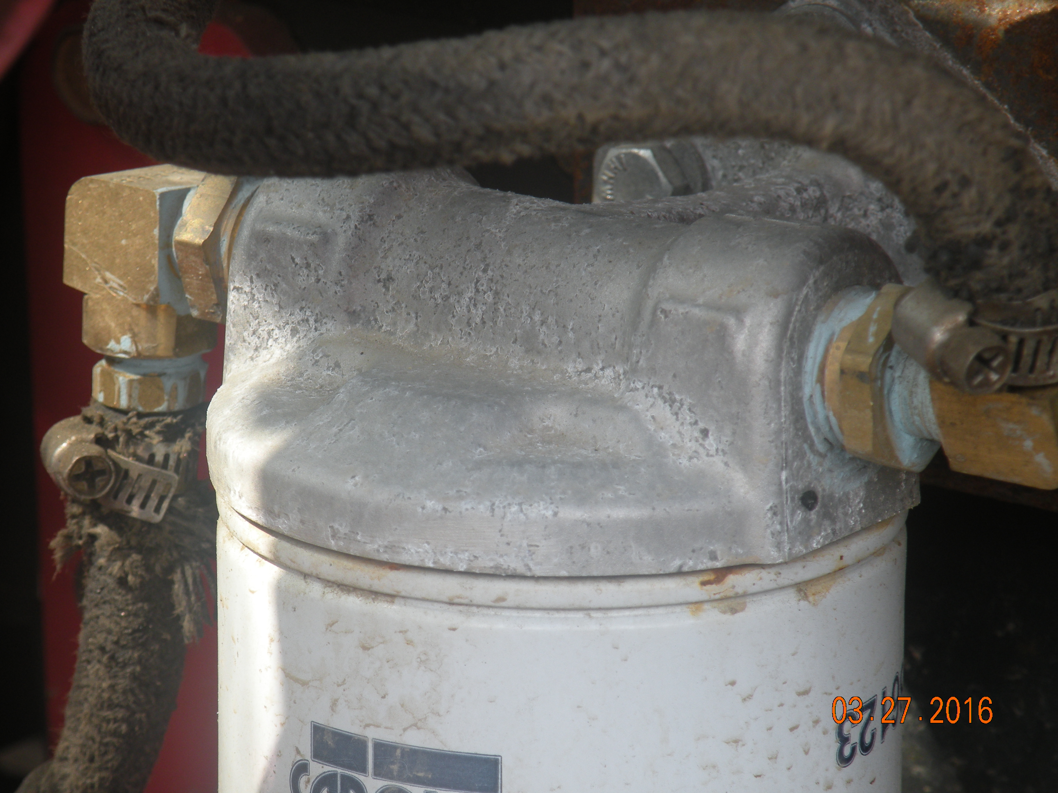

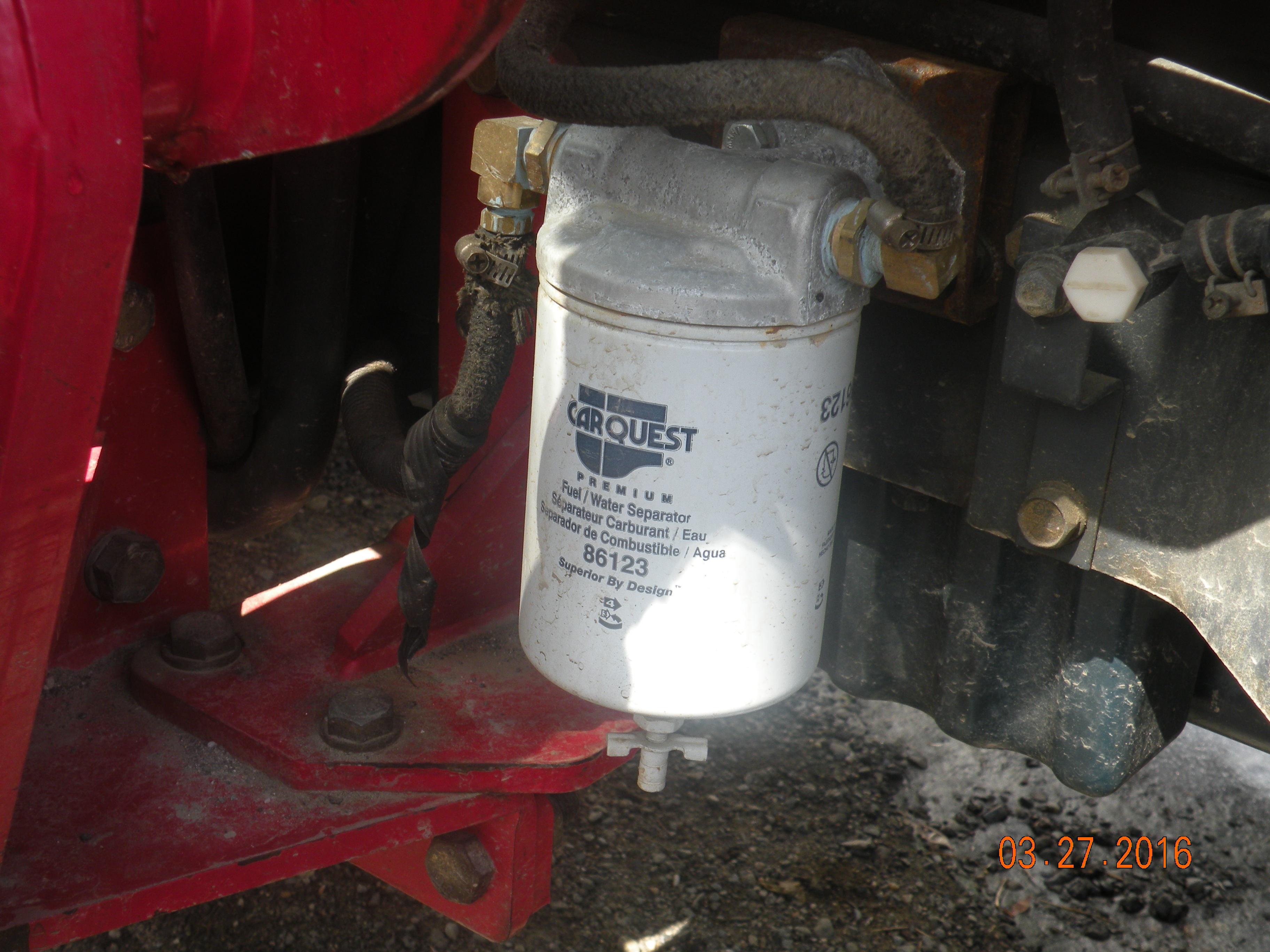

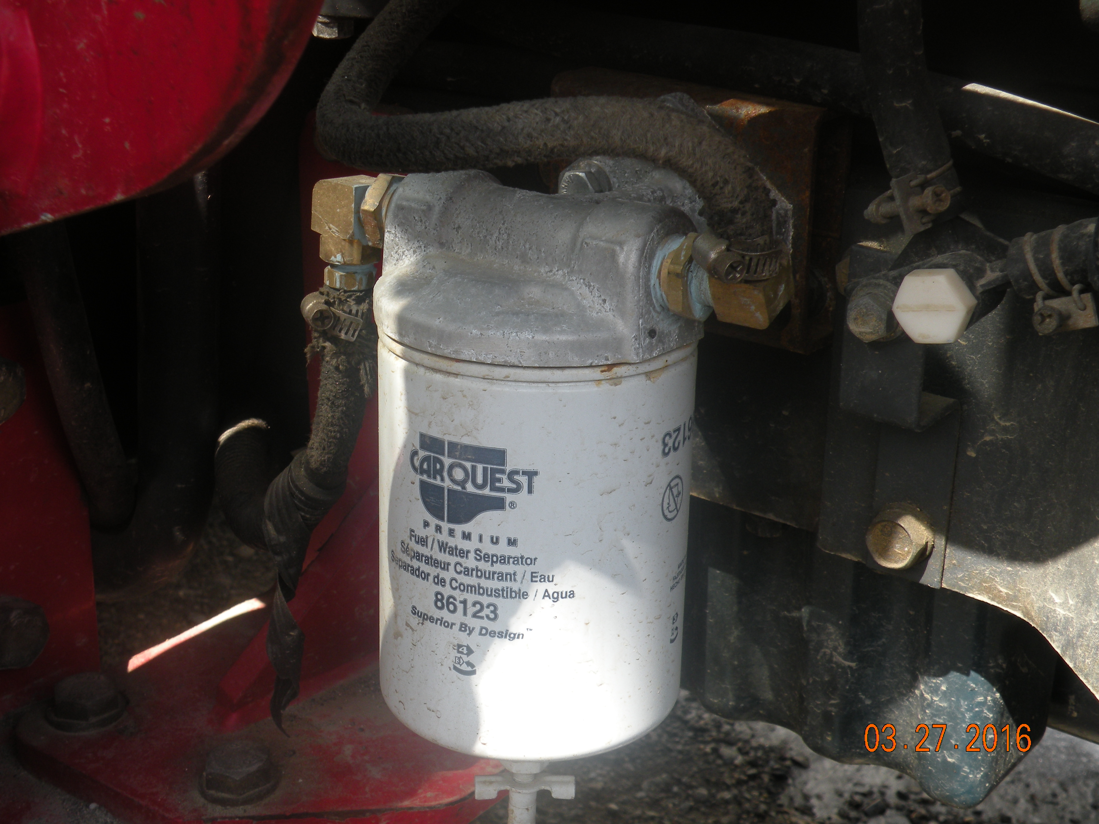

Noticed fuel dripping from the bottom of my TYM T451 fuel sediment bowl.The original filter isn't very big.Upon inspection found the plastic sediment bowl cracked.Called the dealer and was told it would take 2-1/2 weeks to get a new one and cost would be about 70 bucks.Didn't want to wait that long with my tractor down.Even more didn't want to pay 70 bucks for a plastic bowl.So I went down to my local car part store and picked up a new filter block and the filter to fit it.Took about an hour to relace my old filter with this new one after I figured out what i needed for fittings and decided how I was gonna fabricate a new bracket to hang it.Now I have a filter that will last a lot longer and the ease of a spin on filter.Total cost to swap this out was about 60 bucks 004.JPG005.JPG006.JPG

Thats a nice upgrade! Plus you have a handy water drain.
