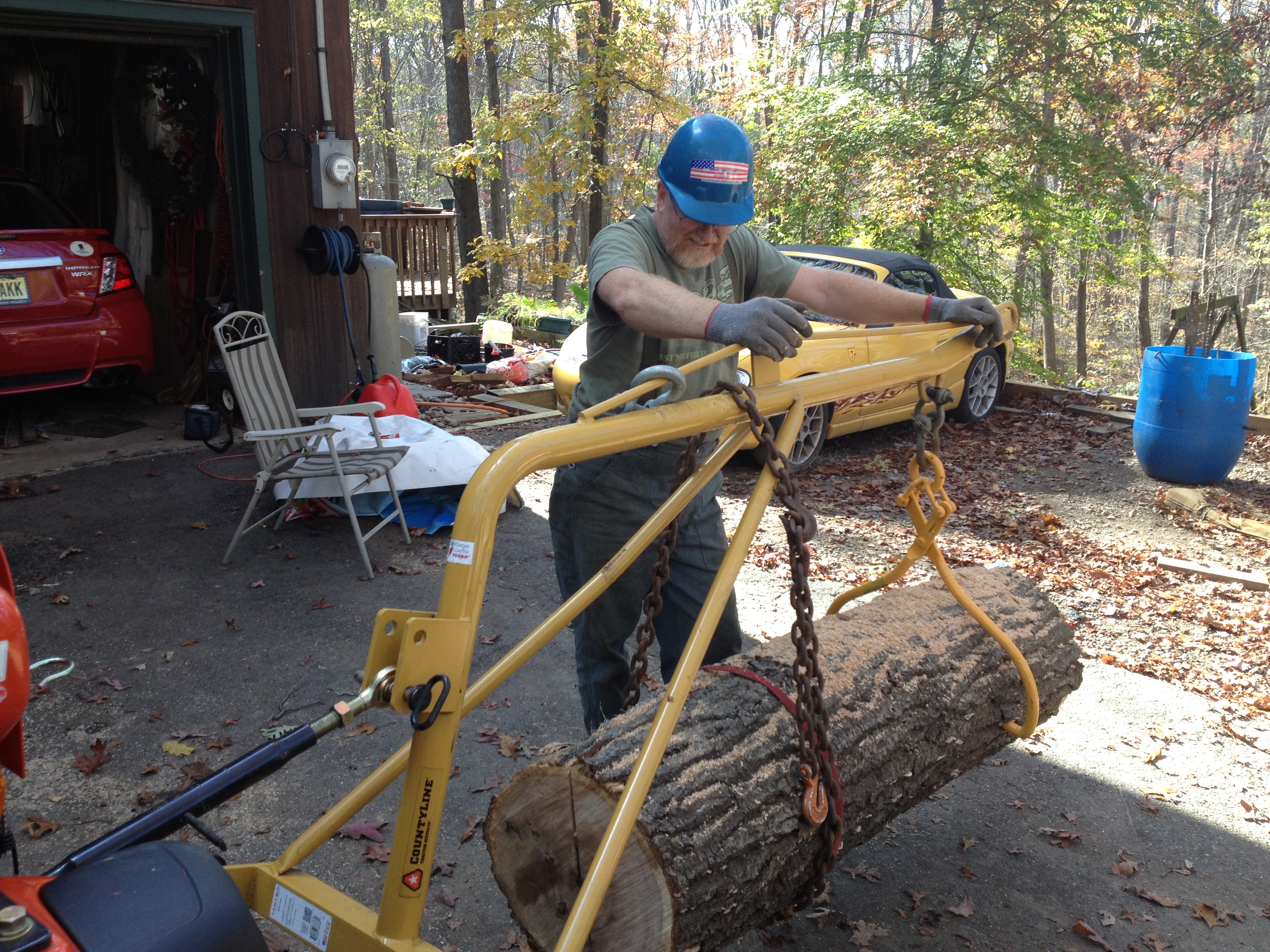

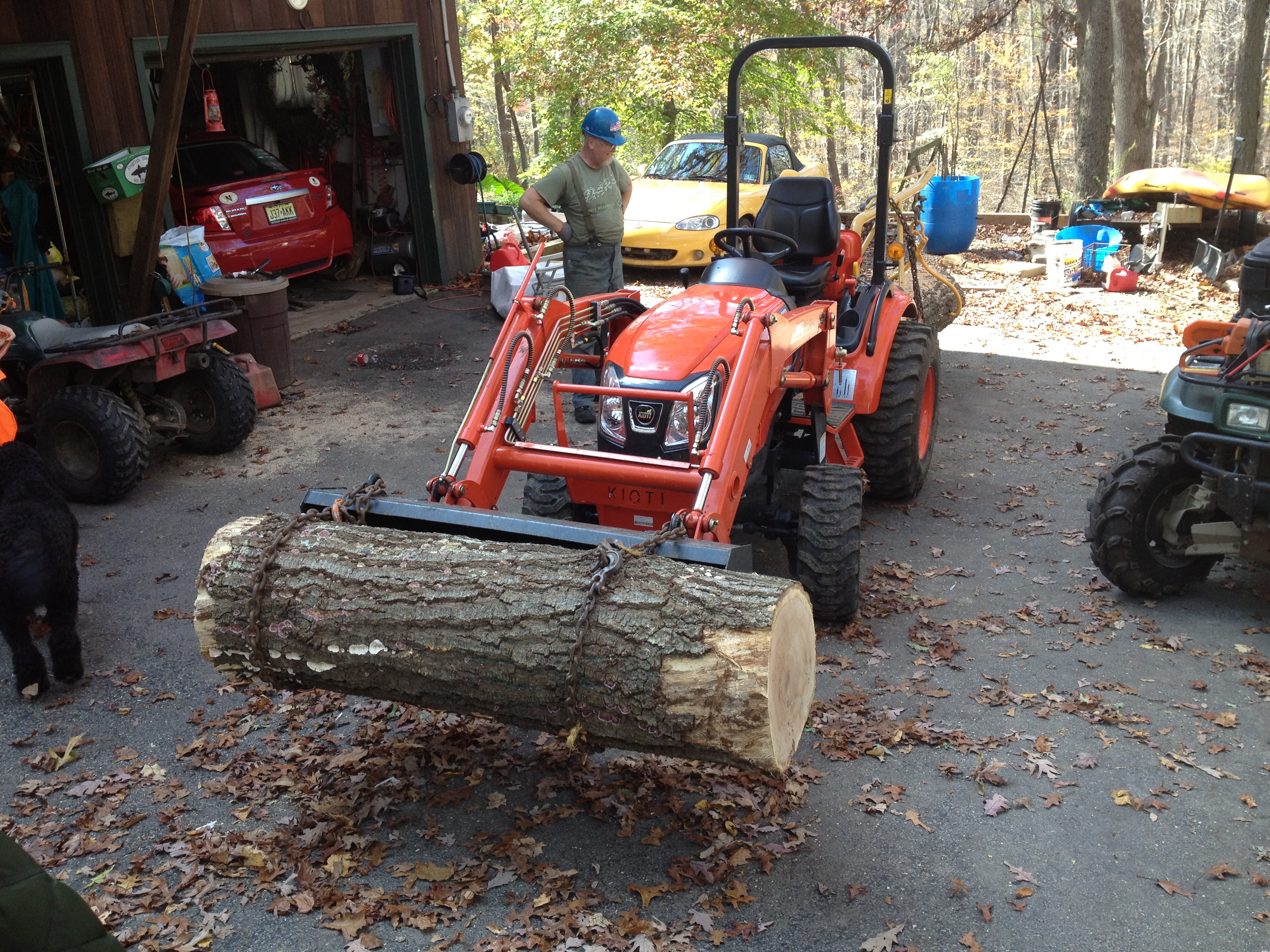

Also dragging a large log/tree is more pratical than a grapple. Grapple would be good for the brush, etc. JMO. IMG_1189.jpgIMG_1188.jpg
