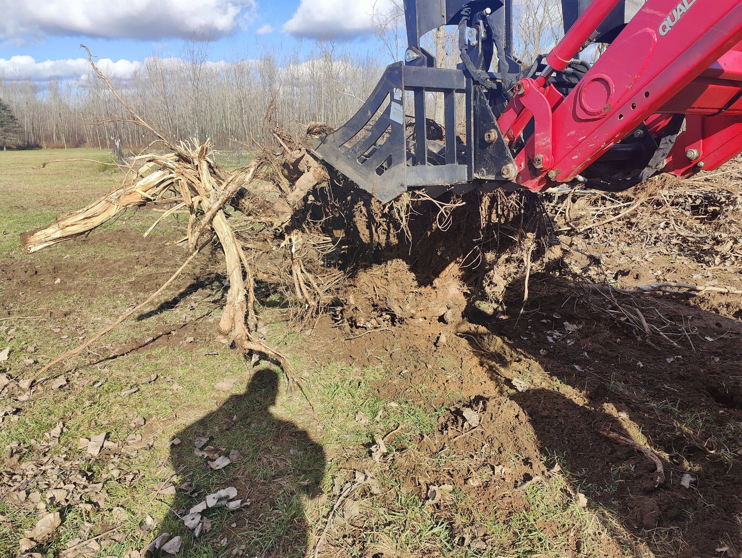

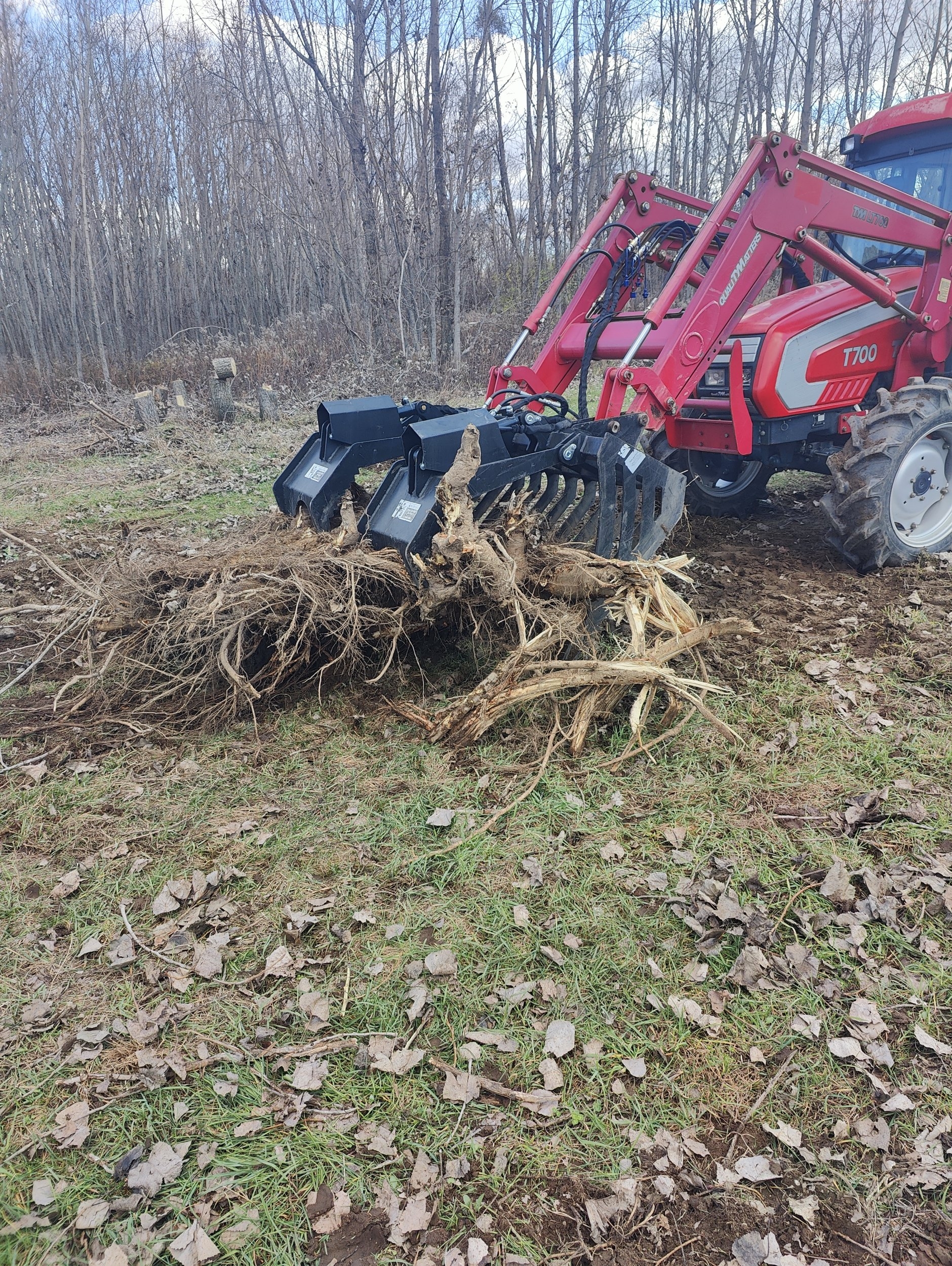

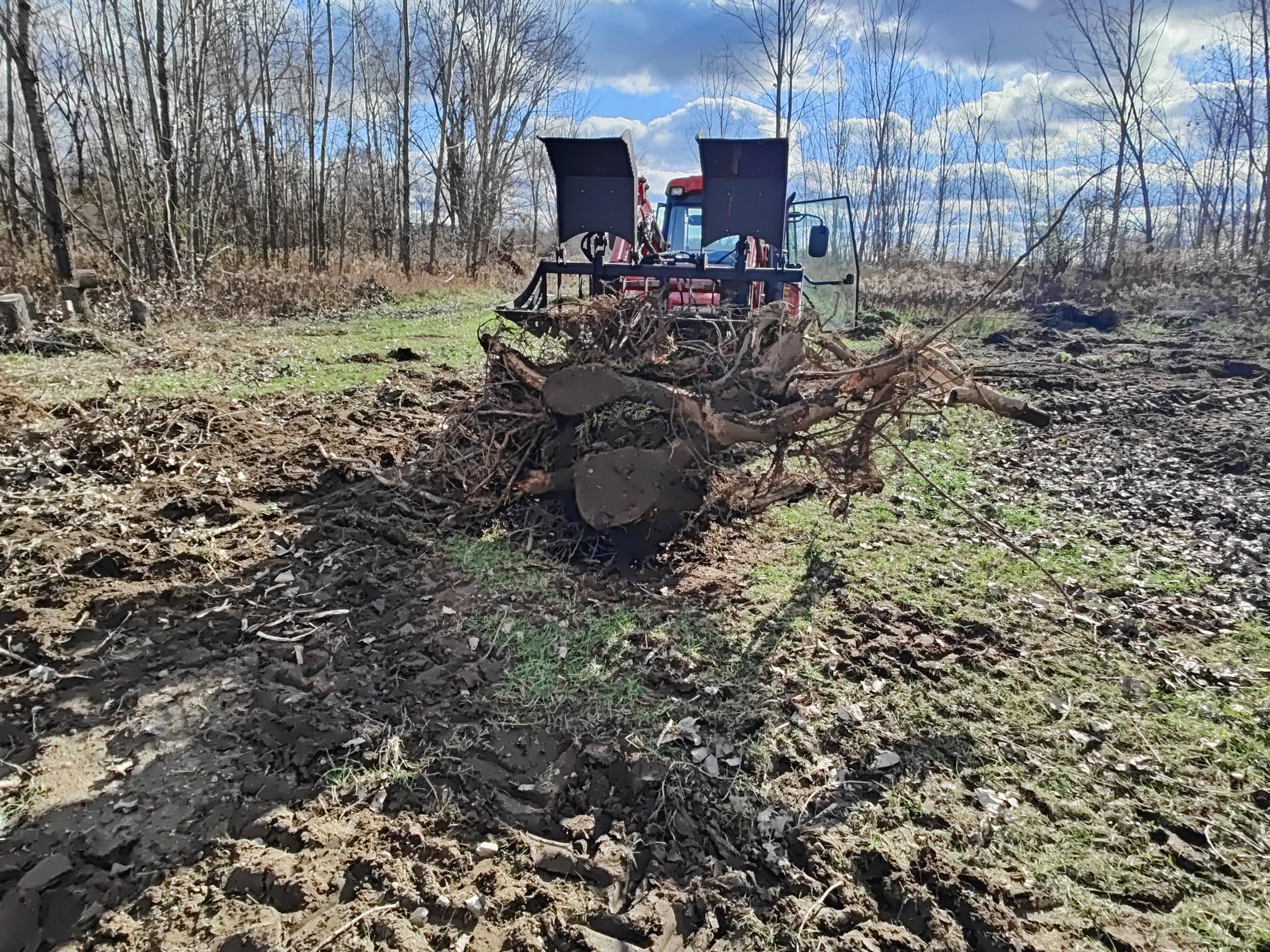

Here are a some more pics of the stumps I tore out yesterday and then grabbed with the grapple to put on the burn pile. I will be making a short video of a tear out in the near future.
