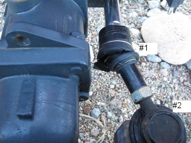

Are you are referring to replacement boot for #1 in the picture? I am waiting to hear back from my dealer as he stated that only the whole assembly was available last he knew. Do you have a part number for the boot or did you source them from somewhere else?
I see now, what you are havin a problem with. No, I have #2 replacements.

yes you can buy the boot only for the ball joint have done so twice

The number on the dust boot package is 16604362230, then some Korean cyphers, then the number 2810. Yep, mine on the 273 are split also but I'm ain't changing 'em this year!

After forgetting about this for a couple months I stopped by my dealer and got a set of replacement boots under warranty. I have 2 dealers fairly close and they are both pretty good ones.
These boots appear much thicker and durable that the ones from the factory. I am thinking I too will wait for warmer weather to change them out.

has anyone ever sourced just the ball joint boot? (#2 in above picture). I just ripped both mine trying to unhook the loader. Still havent got the hang of it yet.
