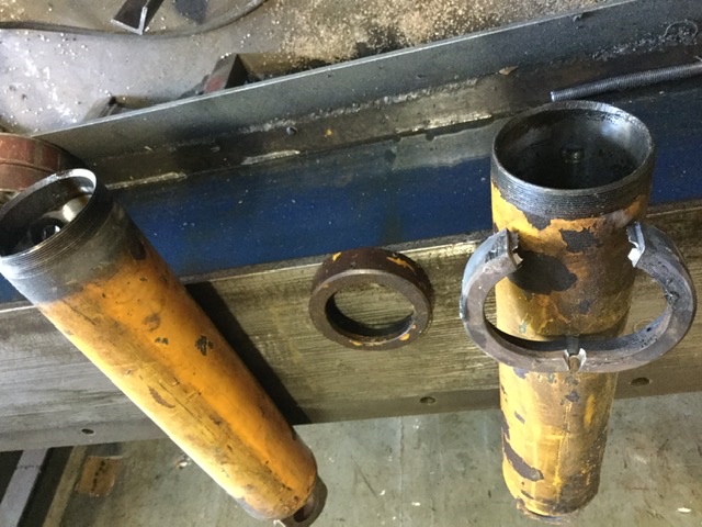

Hello hydraulic gurus,
I will be rebuilding the hydraulic cylinders on my tractor. They all have end caps with internal threads and tubes with external threads. I assume there is a thread seal in there now and I am wanting to use a thread seal as part of the rebuild.
Does anyone have a recommendation for a Locktite (or other) product that is appropriate for the application. I contacted Locktite but they never responded.
(The tubes are about 3.25" diameter if that makes a difference.)
TIA,
Blane

Correct me if I’m wrong Scotty (and others), but my take is the OP is talking about threads on the cyl barrels, not a fitting.
Here’s what can happen if no one put neversieze or grease on the threads on an old repair. One cap came off hard, the other had to be cut off.

(Sorry for the upside down pic)
Yes. On re-reading I think you are right about his question being specific to the cylinder cap ends. My reply - and others - was more general for hydraulics & hydraulic fittings.
So on more thinking about it, I do agree that the cylinder caps are one of the few places around the hydraulic system where one could use a sealer. The threads are parallel so there is a potential leakage path to deal with. It's a path that lets water cree in as well as hydraulic fluid out. Since I now agree that we are dealing with external threads on the cylinder, there is no easy way for a cap sealer used there to get into the hydraulic system - which was my main concern.
I'd want to use something that doesn't harden so that it can creep under pressure - but very slowly - and that has the quality of being slightly gap filling. Some fairly thick never-sieze compounds seems to have those characteristics. So it would be a reasonable product to try in that location.
I've wondered why cylinder end caps tend to be hard to remove. It must have something to do with the repeated cylinder pressure. Other similar threaded connections don't set up so darn tight. The never-seize might help with that, too.....I doubt it would hurt.
