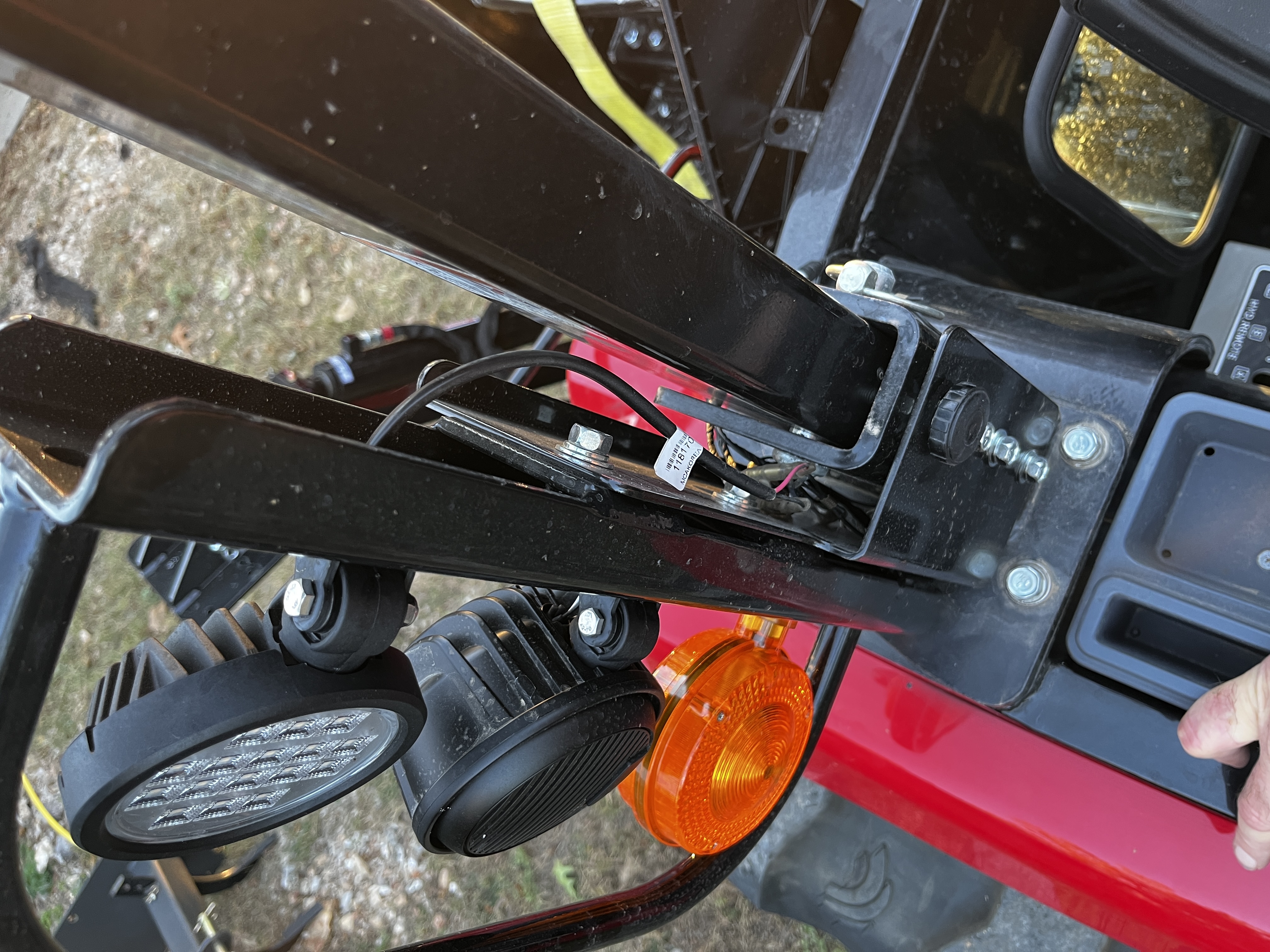

TYM’s drawings showed it being foldable near the top. 🤷‍♂️ ASS-U-ME demons got me again, but four bolts later… no big. Saw this post and the comments and thought I should highlight this design flaw for the OP’s sake since there seemed to be a misunderstanding in the commentary.
I was mentally working on a relocation bracket design that would expose the heads of those pins, but tbh, I think I’m going to lose the lights at that location altogether - my tractor will never see public road ingress/egress and Ill just put the AUX forward and reverse illumination lights elsewhere.

Reviving this post… top and bottom pins are trapped and cannot be removed without removing the light bar plates. Unless I had too many beers today?
Time to take the light bracket off, flip the pins around and bolt the light bracket back on. Replace the lynch pins with the hairstyle cotter pin so you can pull it out and put it back in. Or even put a zip tip on the cotter pin so you have a "tail" to pull it out easier. Looks like a very tight place to sneak fingers in.
Since the tractors come in "crates", the ROPS is put on the tractor at the importer or at the dealers. One would imagine they would've figured this out by now.
Great idea and telling picture! I was first reading your post and was going to jump in and say it’s too tight of a space for the flip spring clips, but those bobby-pin style clips might work! Easy peezy.
I can see this is an engineering design afterthought - in South Korea, some engineer is saying “WTF these wide eyes want lights and speakers on the sides?” 😆
I was going to take another look and see if I could drill some 5/8” peek-a-boo holes in the side of the bracket to pull those pins through. 🤷‍♂️
For this sunny day ahead, I’m just going to pull them off and get that ROPS back up, but looks like I have my first tractor project tonight.

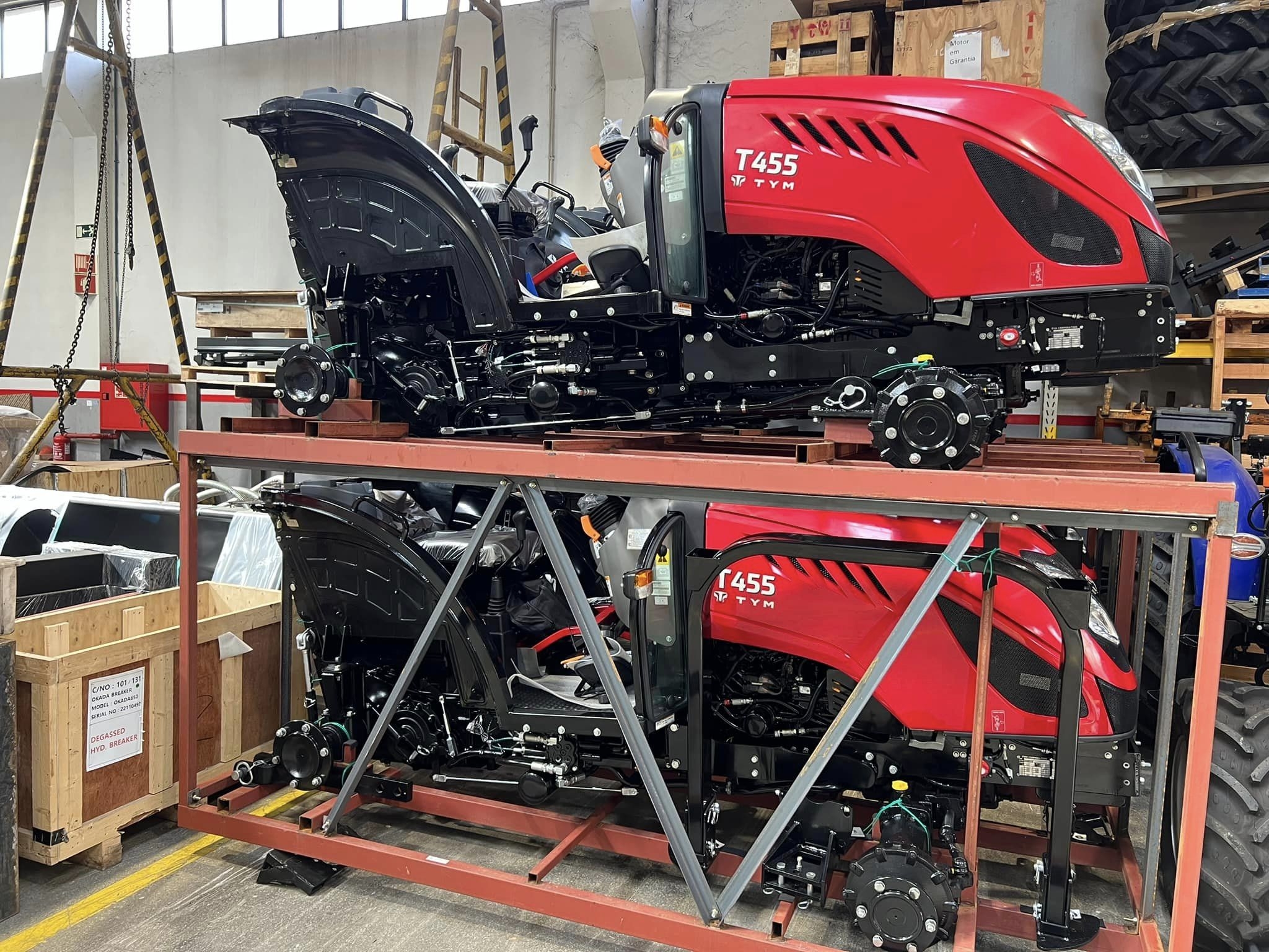

To be fair, that bracket with the lights and speaker (?) seems to be an extra just for the NA market. Most likely assembled once the tractor arrived in the US. I even wonder if those are made in South Korea or in the USA.
The ones here in Europe don't have those. Probably a good thing too. Those things wouldn't have lasted long at all working around trees.
