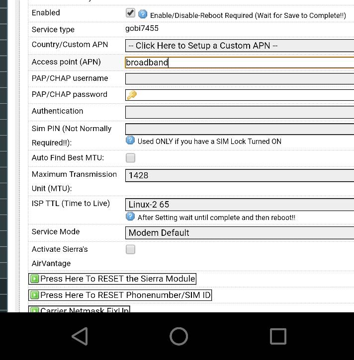

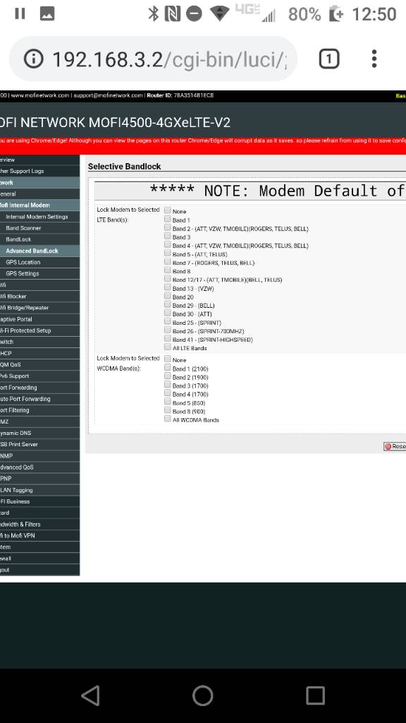

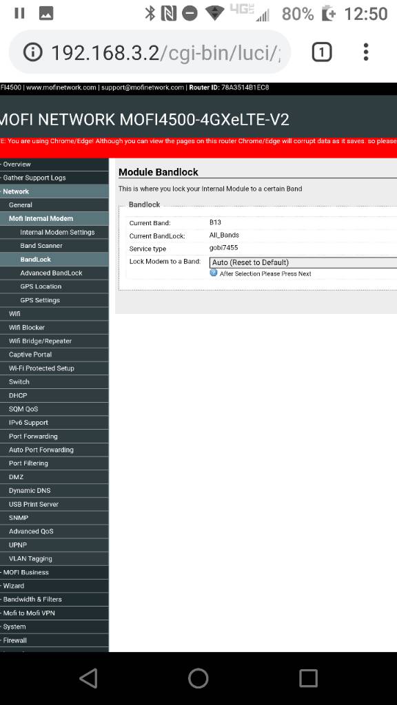

This is the basic setup, APN should be "broadband" and the 2 bandlock tabs should look like this.
Post screenshots of your configuration and I'll take a look, if you'd like. The cellular setup is really very simple for AT&T. The Verizon setup, on the other hand, is a nuisance. Screenshot_20190602-125006~2.jpgScreenshot_20190602-125028.jpgScreenshot_20190602-125019.jpg
Post screenshots of your configuration and I'll take a look, if you'd like. The cellular setup is really very simple for AT&T. The Verizon setup, on the other hand, is a nuisance.View attachment 607341View attachment 607342
