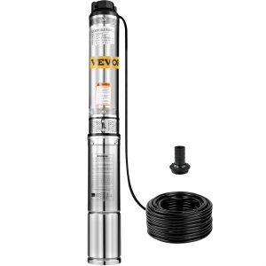

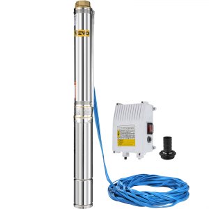

Looking at submersible pumps and this Vevor came up. Look to be super low prices so I doubt that quality is present along with the fact of no 220 volt.
Edit: I see here a 220 volt model but no relay box to go with it:
I see a lot of these. Looks like they sell the same Chinese made pump under many different names as they all look the same. Can't really do a 1.5HP load if it is on 115V, as that would be a 24 amp motor, and you can't get a 115V breaker larger enough to start it. Probably less than 1HP in reality. They are usually oil filled motors with ball bearings. Worries me as to what kind of oil they are using? Years ago we had some oil filled motors, and it isn't good when the oil gets in the well. Water filled motors with a Kingsbury type bearing are better.
However, the brand name pump companies have cheapened up their pumps so much there probably isn't much difference. Any pump will last longer if you limit or eliminate the on/off cycling, which is the most usual cause of a destroyed pump. For that price, especially if you install it yourself, you can't help but try one.
