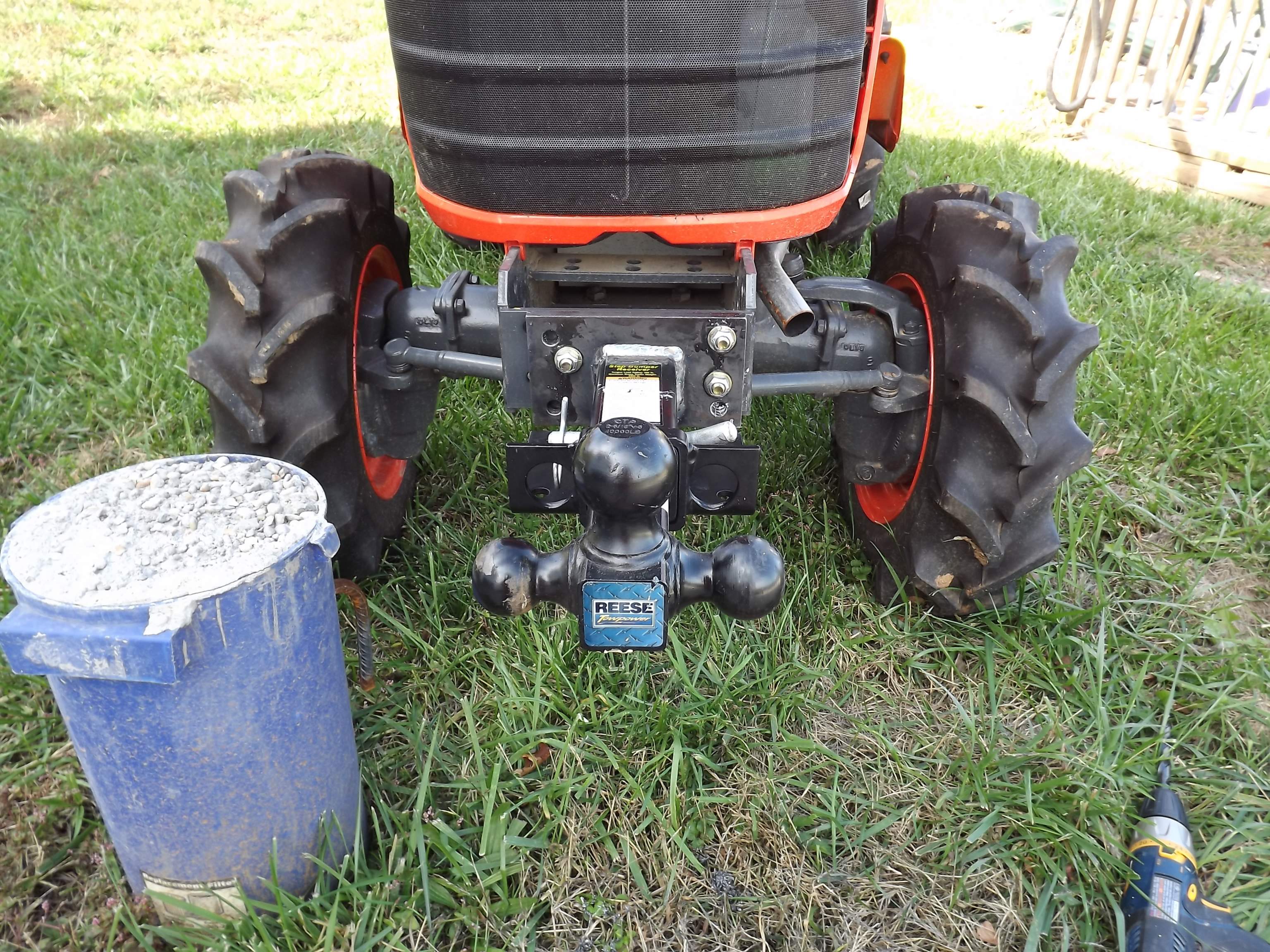

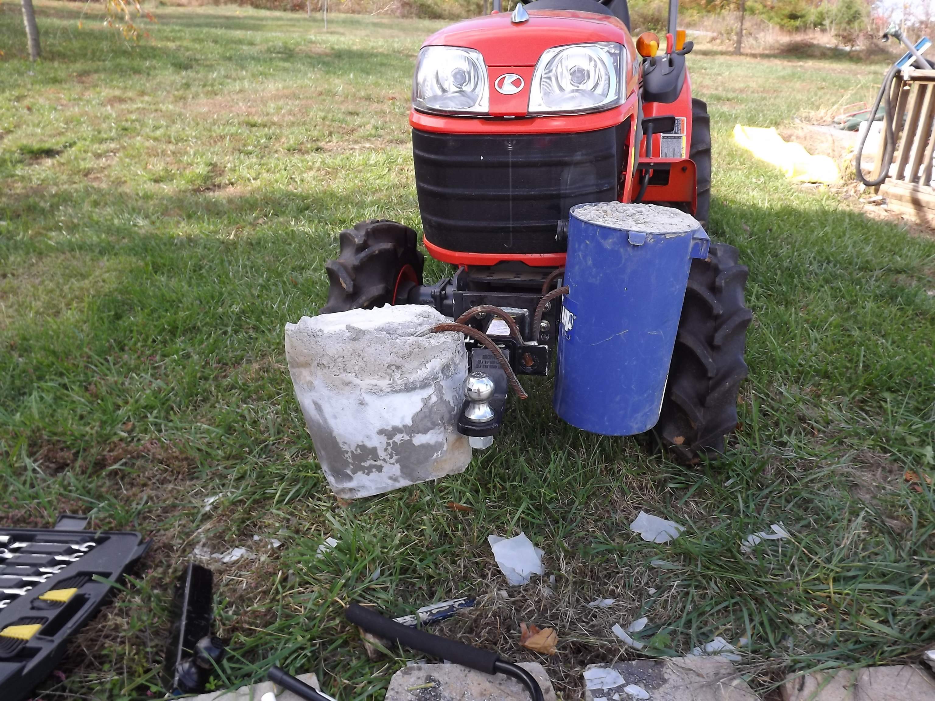

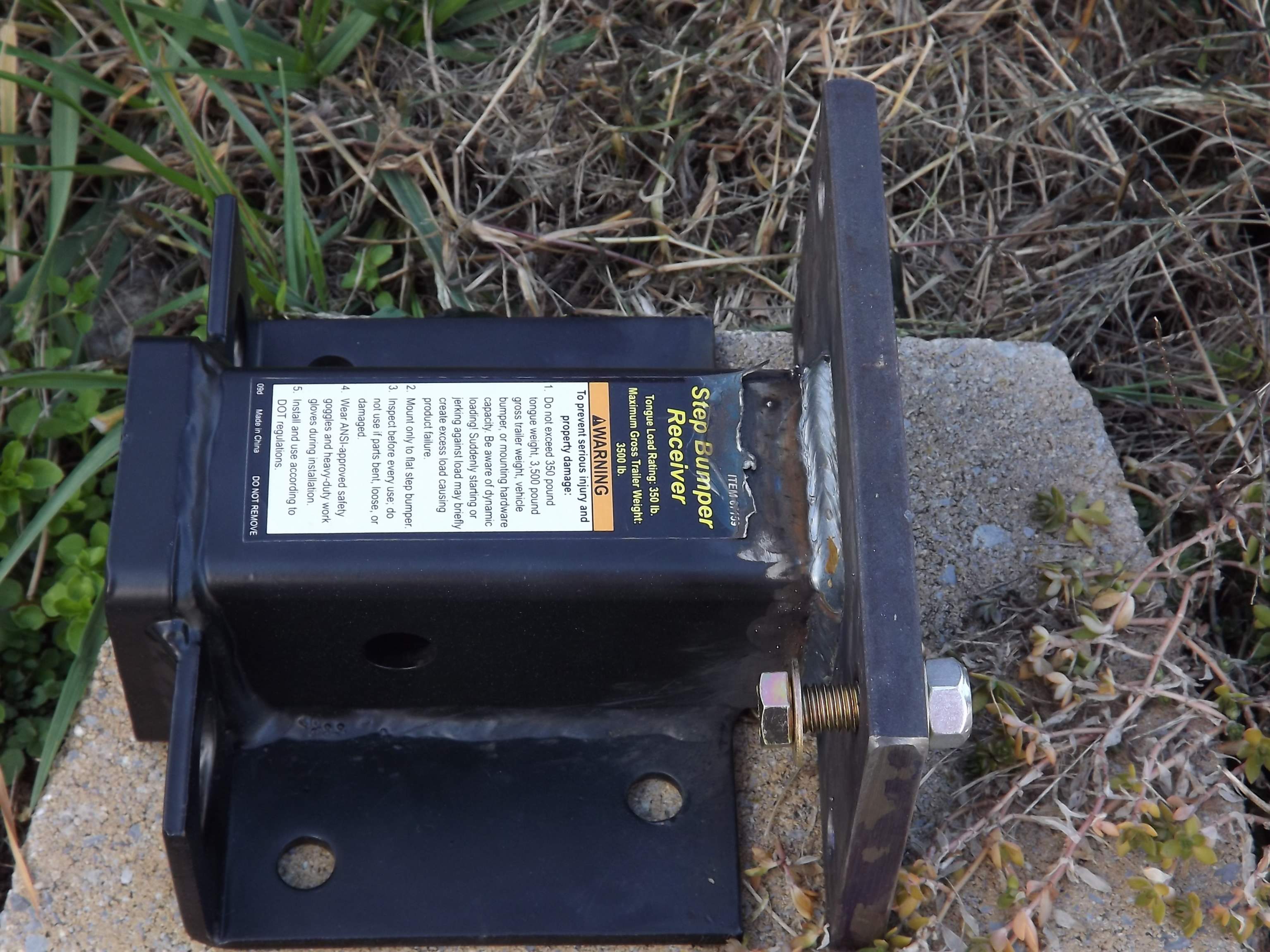

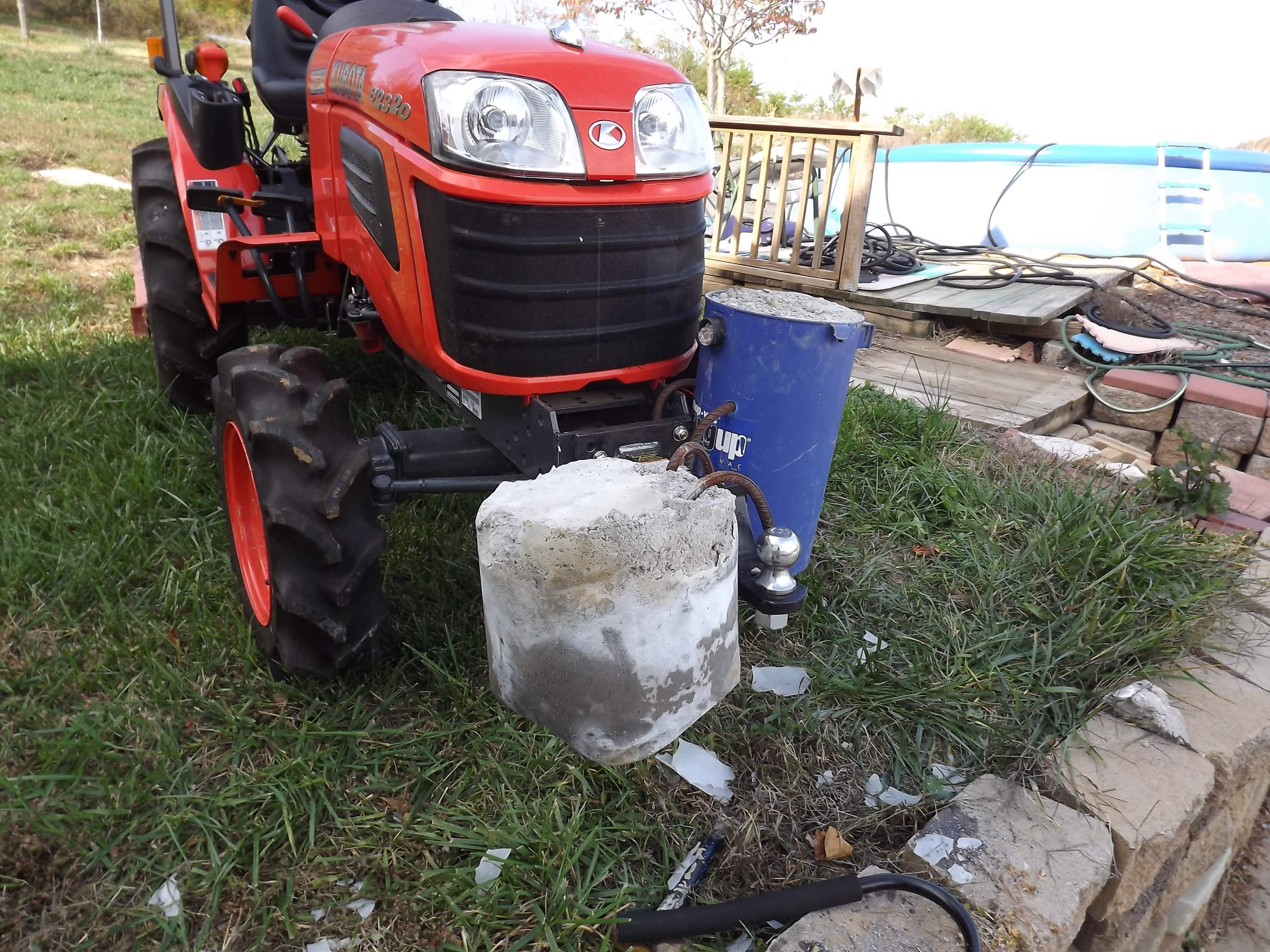

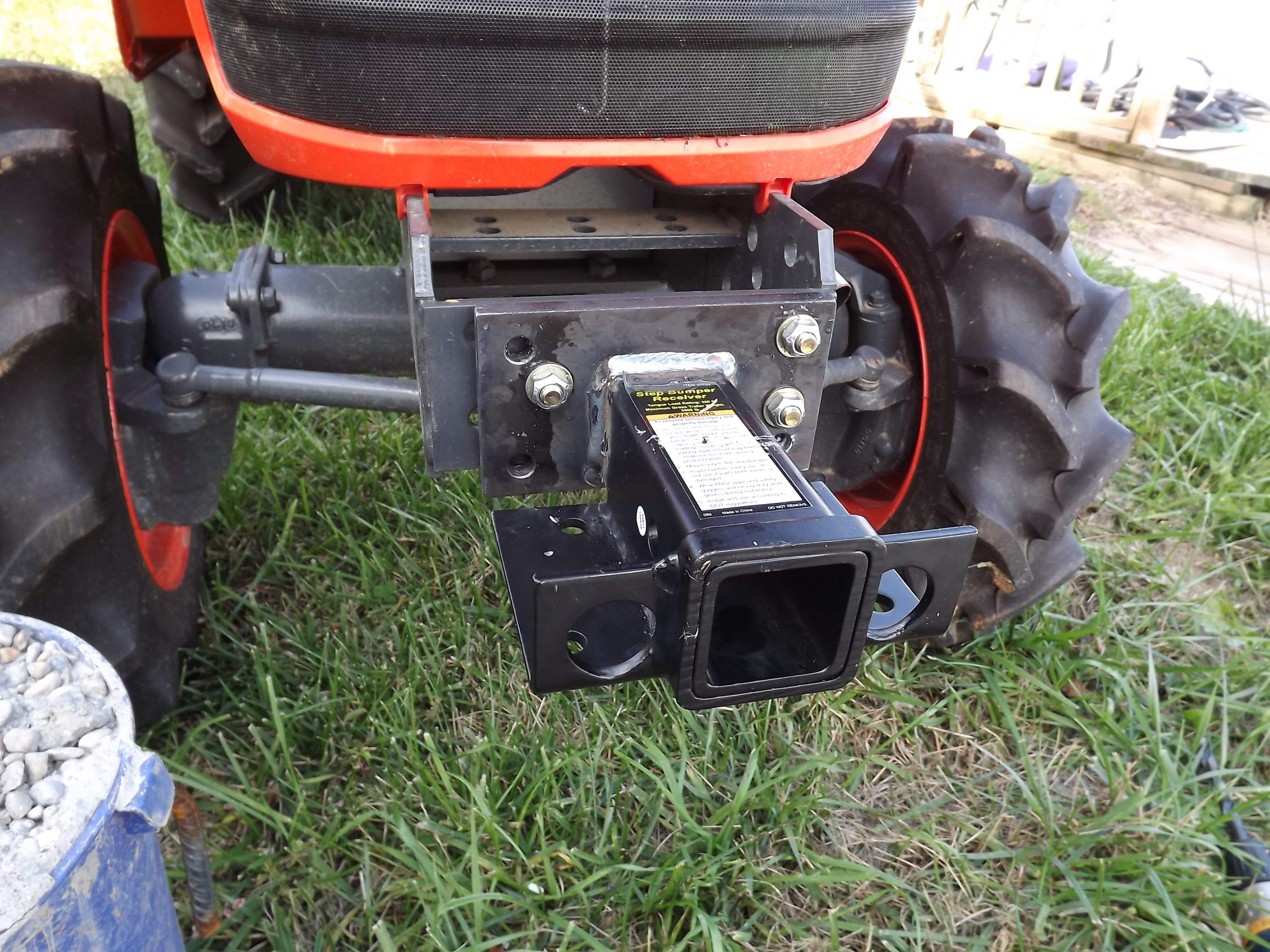

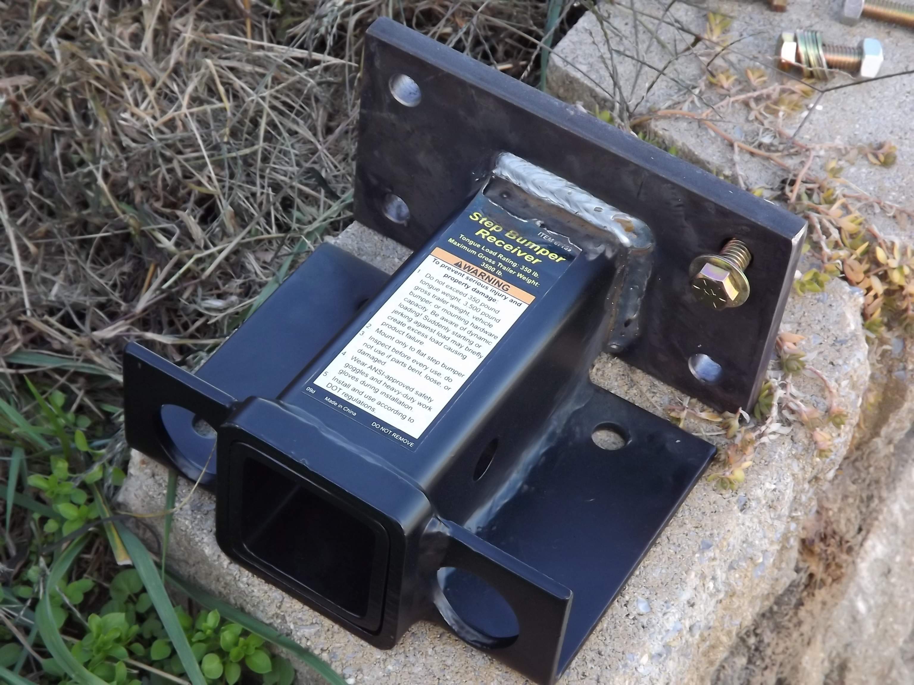

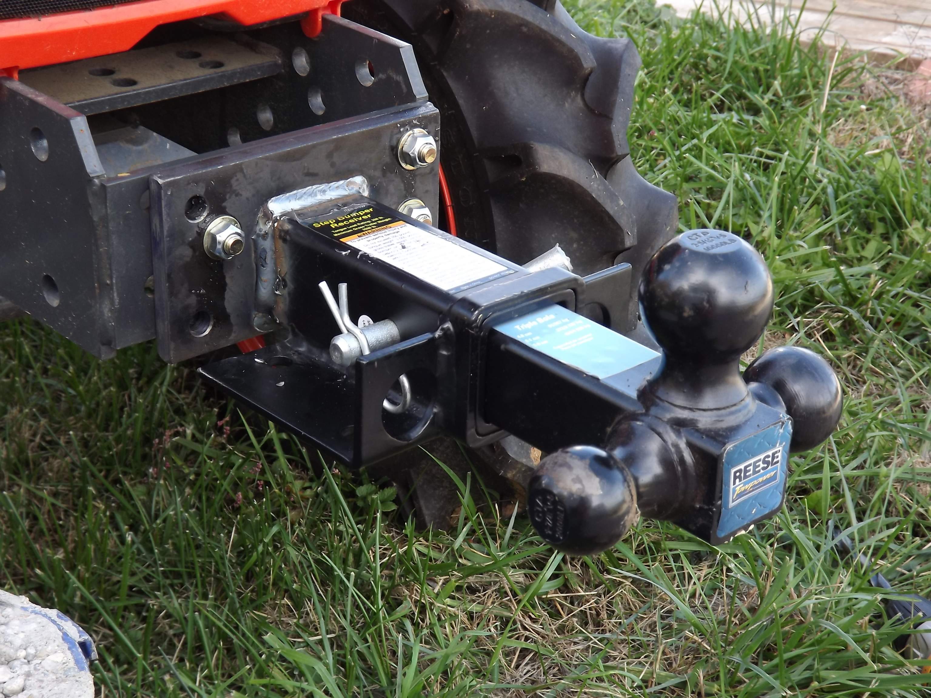

Finally made some progress on getting the front weights on my B2320. My Machinist Bro in law welded me a steel attaching plate to my Reece hitch receiver and drilled me some holes. Didn't give him location of my already available holes so had to drill a couple of holes in his plate. Anyway, it's attached and the weights are hanging on the front of my tractor. Drove all around yard with Rotary mower attached to back and there is a world of difference with the ugly weights attached. Before the wheels would spin at the least hill.
Yes, I'm going to do something different than what it now is.:) I'm not entering a front weight beauty contest but it's to ugly to live with forever or however long I own this tractor.

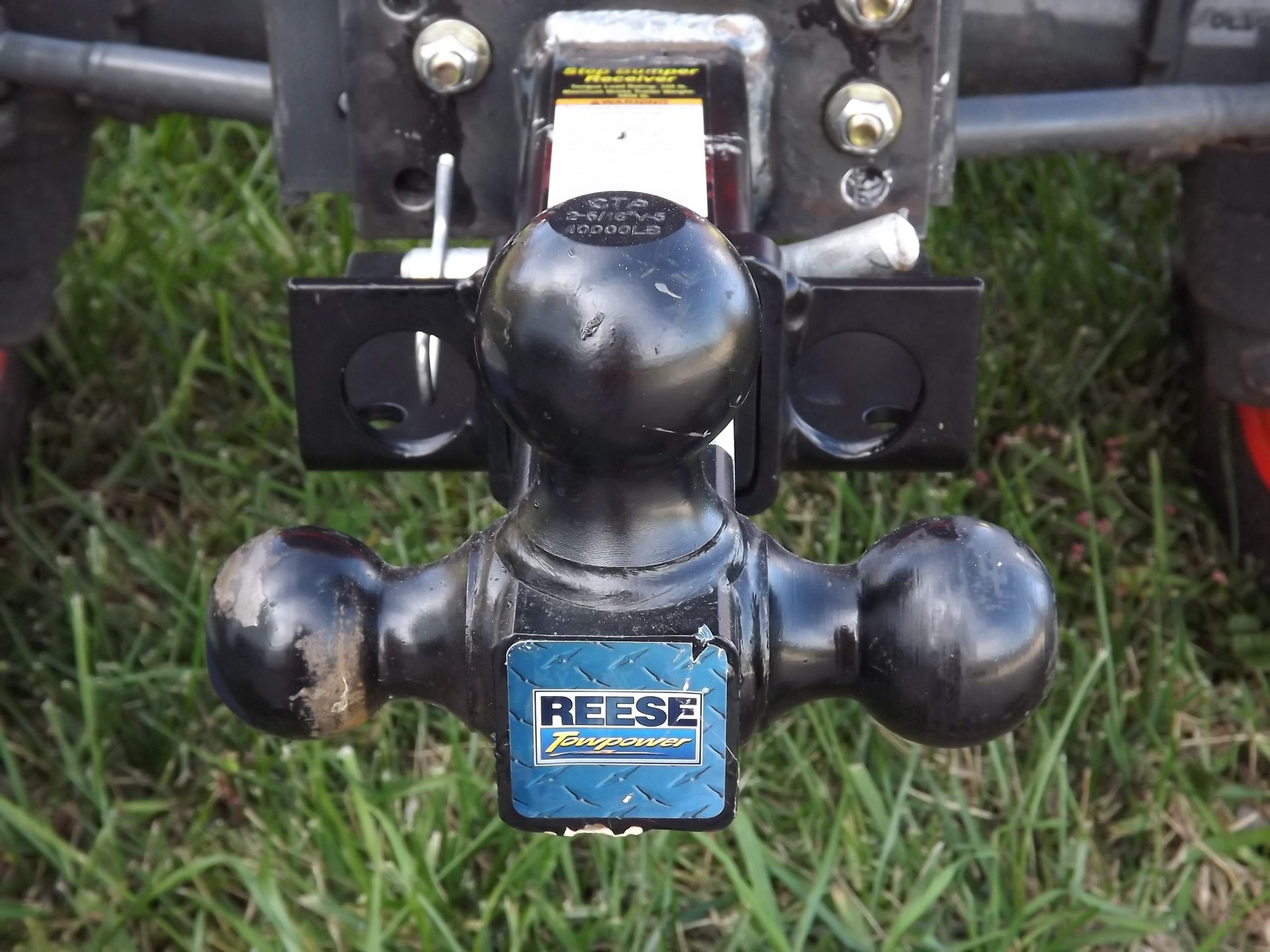

I bought an 18" Reece hitch extension bar that I planned hanging the weights on but the extension is the same size as the Reese hitch hole sooooo will have to come up with something different there.
Asked Bro in law if he'll make more for others and he agreed to for $99 shipped and said he's drill 4 holes at the location requested on the plate.
Sakrete was $2.50 40 lb bag plus 2 pieces of rebar for $4 so cost was $8 for rebar and $7.50 for 3 bags of Sakrete so cheap ugly weights cost about $18 with tax not the $1 per lb of Kubota tractor weights. How much more is beauty worth?:D

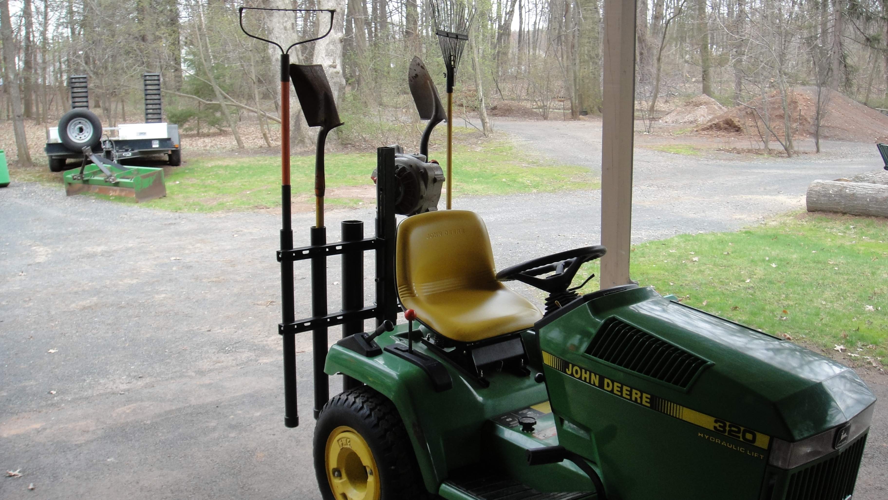

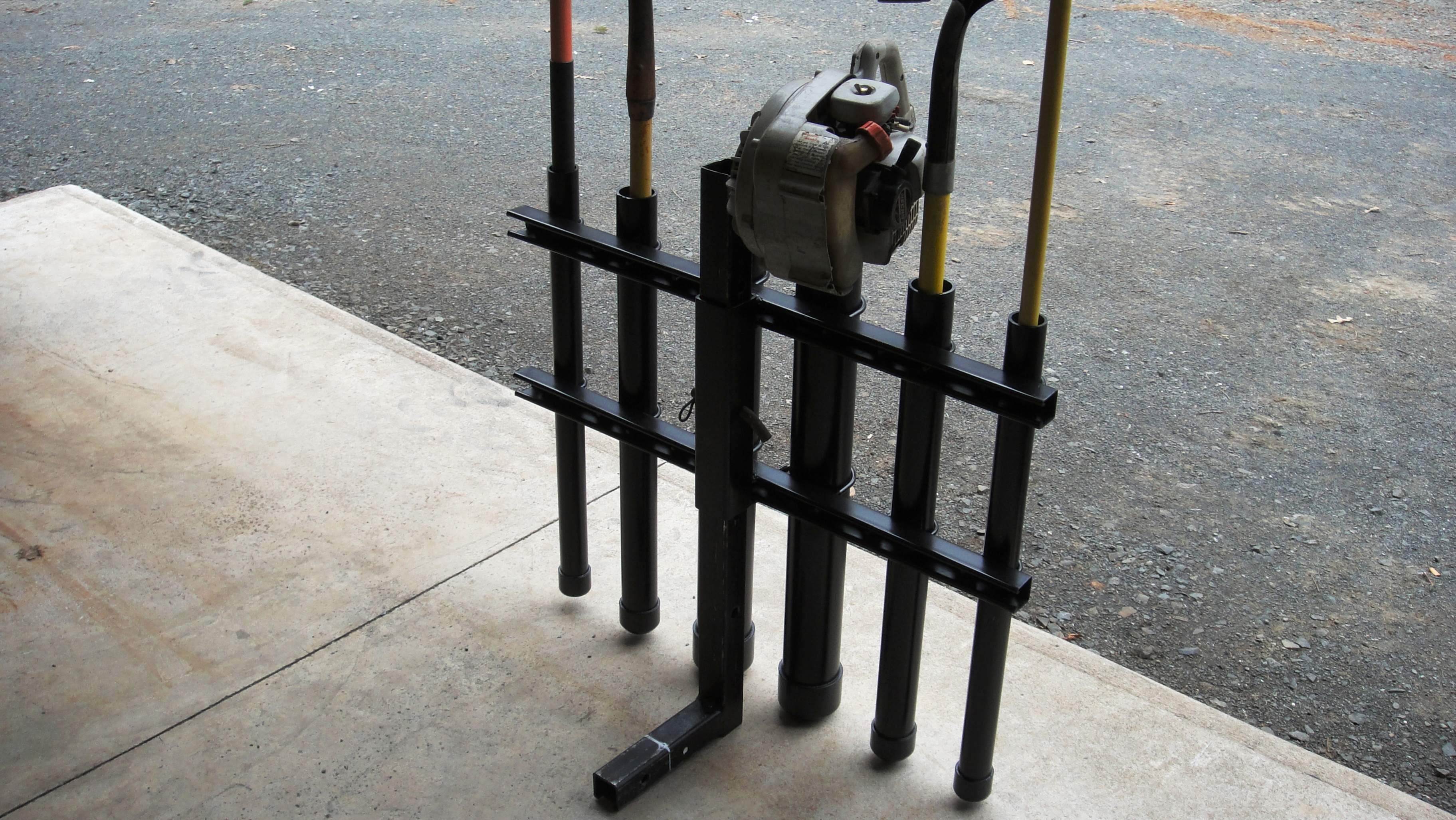

I like the front receiver tube, it would be perfect for this tool holder I invented, I thought of putting a hitch on the front of my garden tractor.
Also a pic of an odd front weight, needed the extra weight to move my JD BH.
JB.
