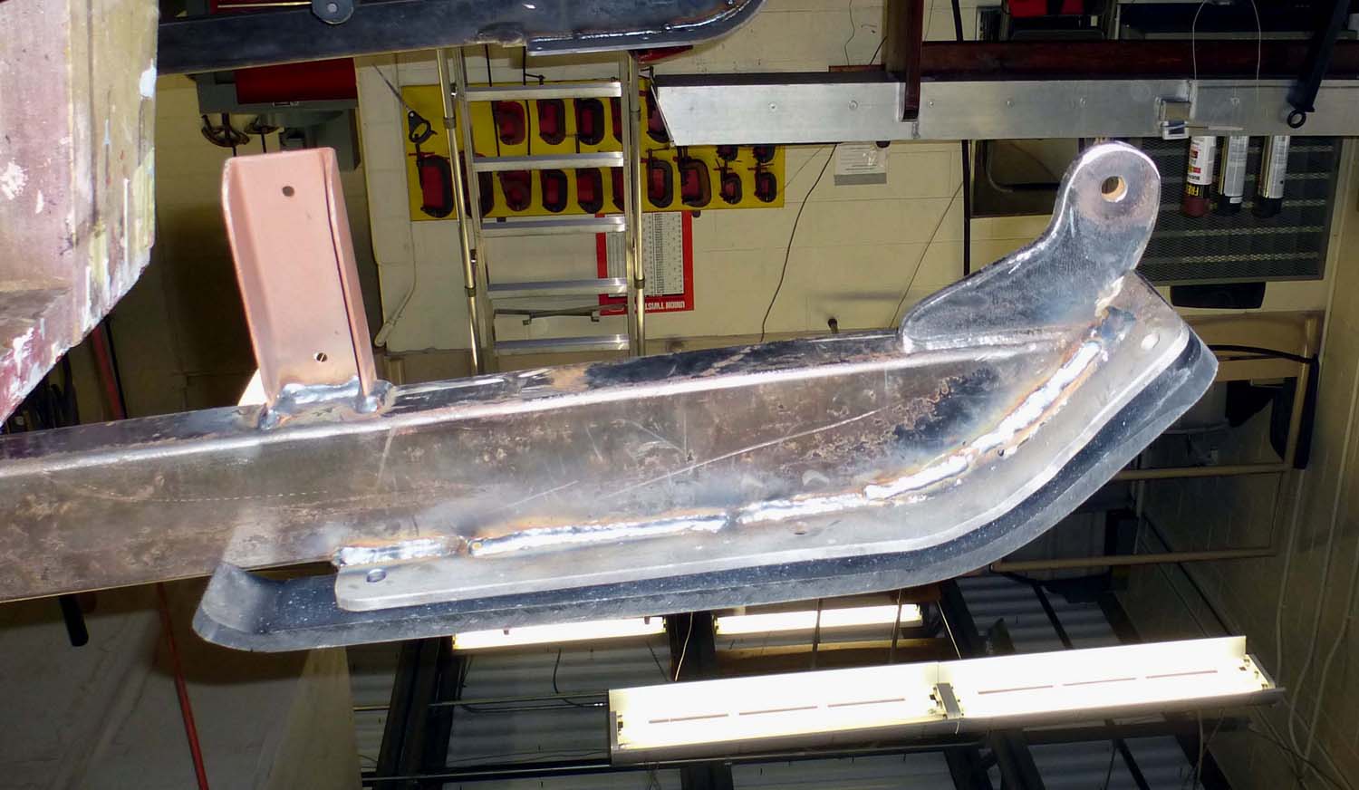

Here is a HPDE shoe (or ski?) i added to an implement some years ago. I can't recall if its 3/8 or 1/2 thick but was heated and bent to this shape you see. The three bolts at the lead are carriage type and tight. The reaming ones were left lose.

At what temperature does poly become formable? Is it feasible to put a small piece in an oven at whatever temp works good?
Or how did you bend that piece?
