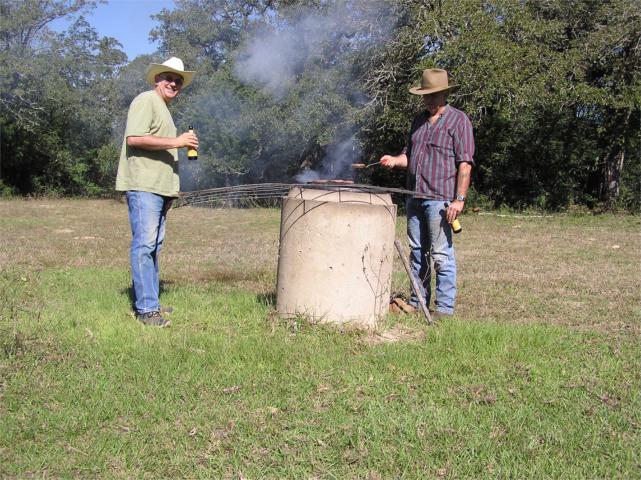

The wifes grandpa use a cement culvert cut in half as a burn barrel for as long as I can remember. So I took that idea and made it better. I inserted a washing machine stainless steel tub in it. The tub has a 2" hole in the bottom (agitator or drain hole) which adds air to the fire and the hole also makes getting the ash out easy and water does not accumulate. I have had this setup now for eight years and it works great. Just thought I pass the Idea on.

Oh, .... and also you can BBQ on it. /forums/images/graemlins/grin.gif

Friends and a BBQ with liquid refreshment, it doesn't get much better than that.
I like your burn pit too BTW. innovative!

where does the air get into it, our burn barrels always had air holes around the bottom but your concrete pipe looks to be solid on the bottom
   / Ultimate Burn Barrel
Markct, the air comes in around the top lip and then up the hole in the center, but mostly just from the top. I had a air hole under the other side but the gophers kept filling it up.
