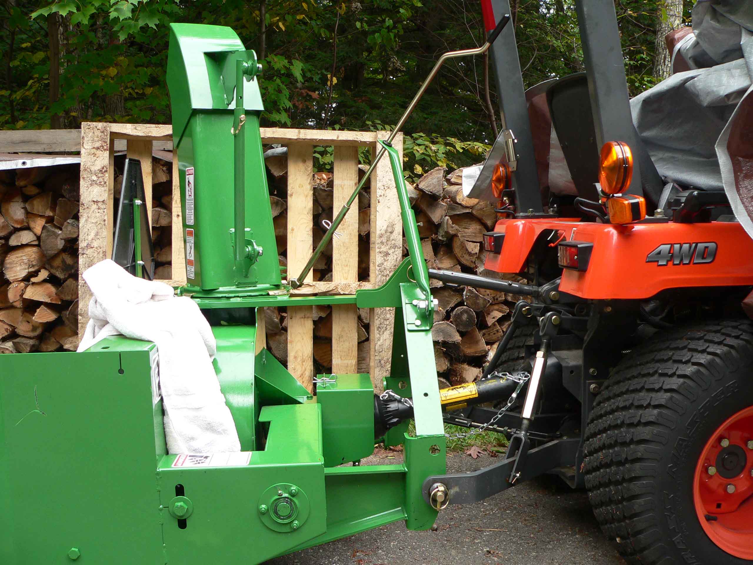

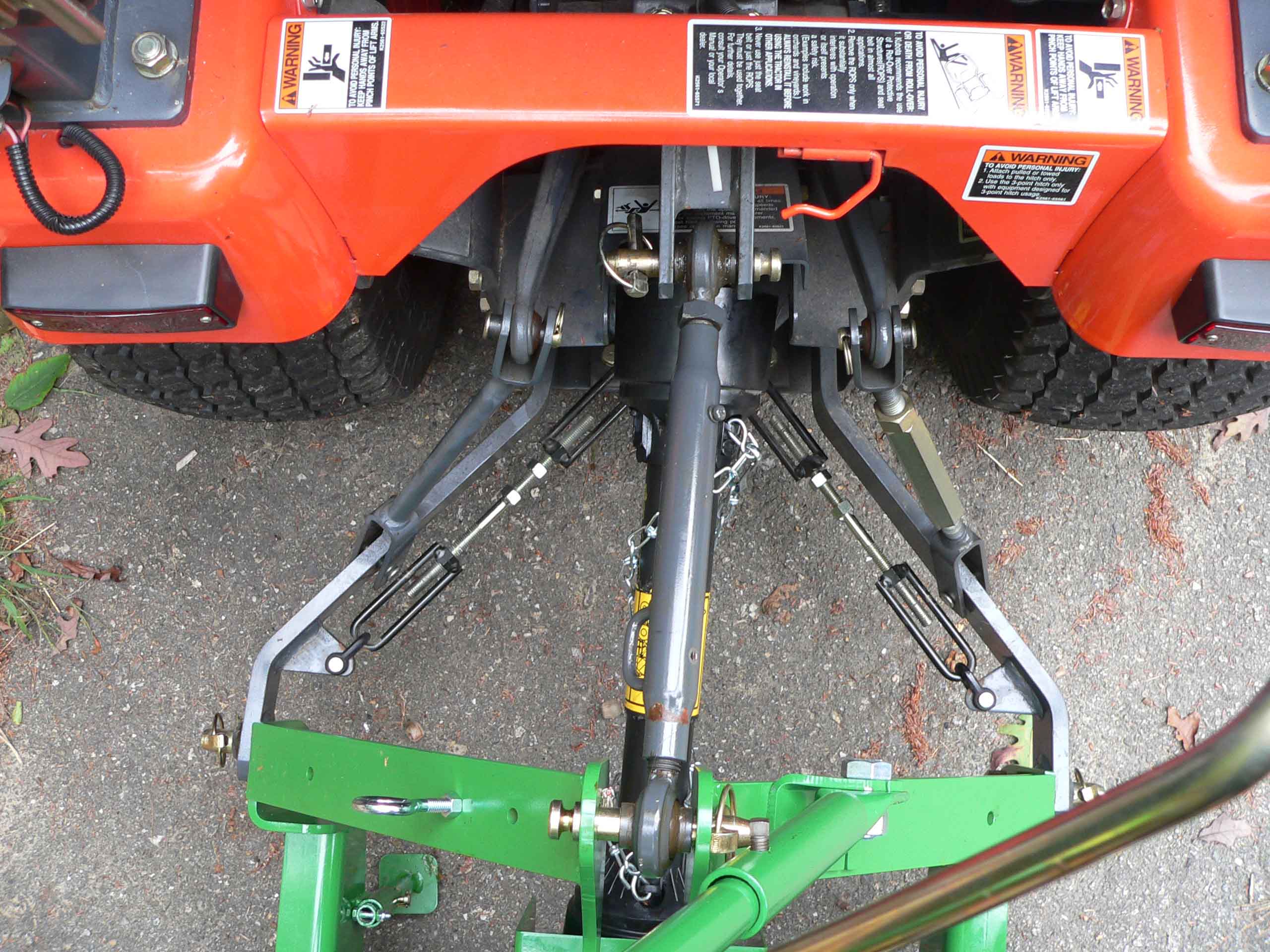

I recently picked up a used BX2230 so I can clear my driveway (getting too old to horse the walk behind snowblower up a 300+ ft driveway). I purchased a Frontier from the local JD dealer (best price for the RAD - Blizzard blower that seems to be made by them for many manufacturers). When hooking up the 3 point hitch, the lower arms just barely clear the pins on the blower mount point - had to slide one on first to make room for the other. Once on, they seem to be okay - though it does take a bit to get them on.
When hooking up the top link of the 3 point hitch, I shortened the link all the way and the blower still doesn't sit on the ground - the resting foot is about a half inch off the ground. The blower has a very slight tilt. Is this because I have the lower links spread as far as they can go and are therefore too short causing the blower to be closer to the tractor? Should I invert the attachment pins so that they are on the inside of the mount instead of the outside? That might give me more room for the to pin adjustment?
The manual says the the mounting pins should be on the outside - but maybe this is a manual for mounting on a JD and not a Kubota?? I need to be sure I have the blower properly mounted before I shorten the driveshaft (next challenge). Any advice appreciated. Thanks. Jim

I'd say if its possible to unbolt the lower pins and turn them to the inside, do so. Its certainly going to bring the bottom of the blower in closer to the tractor when the lower arms are spread as far as they can go. If this doesn't cure your toplink issue, then my first thought is to send you to Tractor Supply to get a shorter toplink. If they don't have a short one, i'd buy a cheap one and shorten it if needed before I cut the stock toplink.

The top link with BX's is oft times problematic. Although I am not sure a shorter top link is in order, but perhaps a longer one. It may be holding it off the ground, and a longer top link may be needed to allow it go to the ground. A photo would help show us which is which.
Do you have a sense that the lower arms are able to descend to their normal position? Do they look higher than their lowest point? In other words, is the too short/too long top link preventing the lower arms from going down all the way?
Yes, you certainly can reverse the pins. Sometimes this is necessary, but I have doubts about this making a whole lot of difference in ascent and descent. Usually reversing the pins is what I have to do if the implement is 27" wide. The BX's prefer a 20" width of Cat 0. Of course, the BX uses Cat 1 pins though. If you got it on, struggle or not, it likely is already 20 or 21 inches. The manual likely is true and not recommending reversal of the pins. Some photos would help us a lot to see what you are up against.

I just reread your first post and you did say that you shortened the top link as much as it would go. That is your problem. You have to LENGTHEN the top link to lower the implement. You have it as high up as it can go with the top link as short as it will go.
Again, check the drive shaft length before using the implement to make sure it isnt binding, after you lengthen the top link so it will touch the ground. The blower should set fairly level

When they changed the BX series to a "full cat 1" hitch they raised the mounting points of the lower arms, or so it seems anyway. My B2620 is the same way. It gives a higher lifting ability, but the arms just barely go low enough for some implements. My chipper is that way, and to be honest, I hadn't thought about moving the pins to the inside. On some terrain, it will barely sit on the ground. Some BX owners with the same chipper have mounted the chipper on 4x4"s, but obviously that won't work so well with a snowblower! :D

You say that the top link is as short as you can get it, are you sure that the toplink is the one for the 2230. A regular Cat1 toplink is about 5 inches longer than the Cat1 that is supposed to be on the BX. Don't know why your arms won't spread wide enough to get past the lower pins, the turnbuckles should adjust to let them go wide enough for Cat1 implements, the BX's don't have Cat0 TPH.
