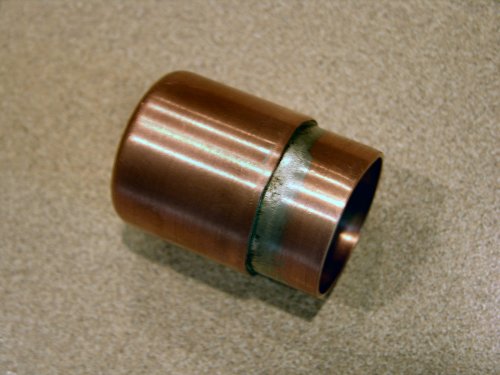

Still remember the 1st time the BH on the New Holland refused to mate. I messed with the connectors until I was blue in the face, then called the dealer. He came right out and showed me how to tap the connectors with a hammer to relieve the pressure.
After that incident I took a copper cap and short piece of copper and soldered them together. Now I just slide the simple gadget over the end of the hydraulic connector before rapping it with a hammer. The soft copper protects the coupling face and the hydraulic oil is directed away from your face.
That is a great idea! :thumbsup:
