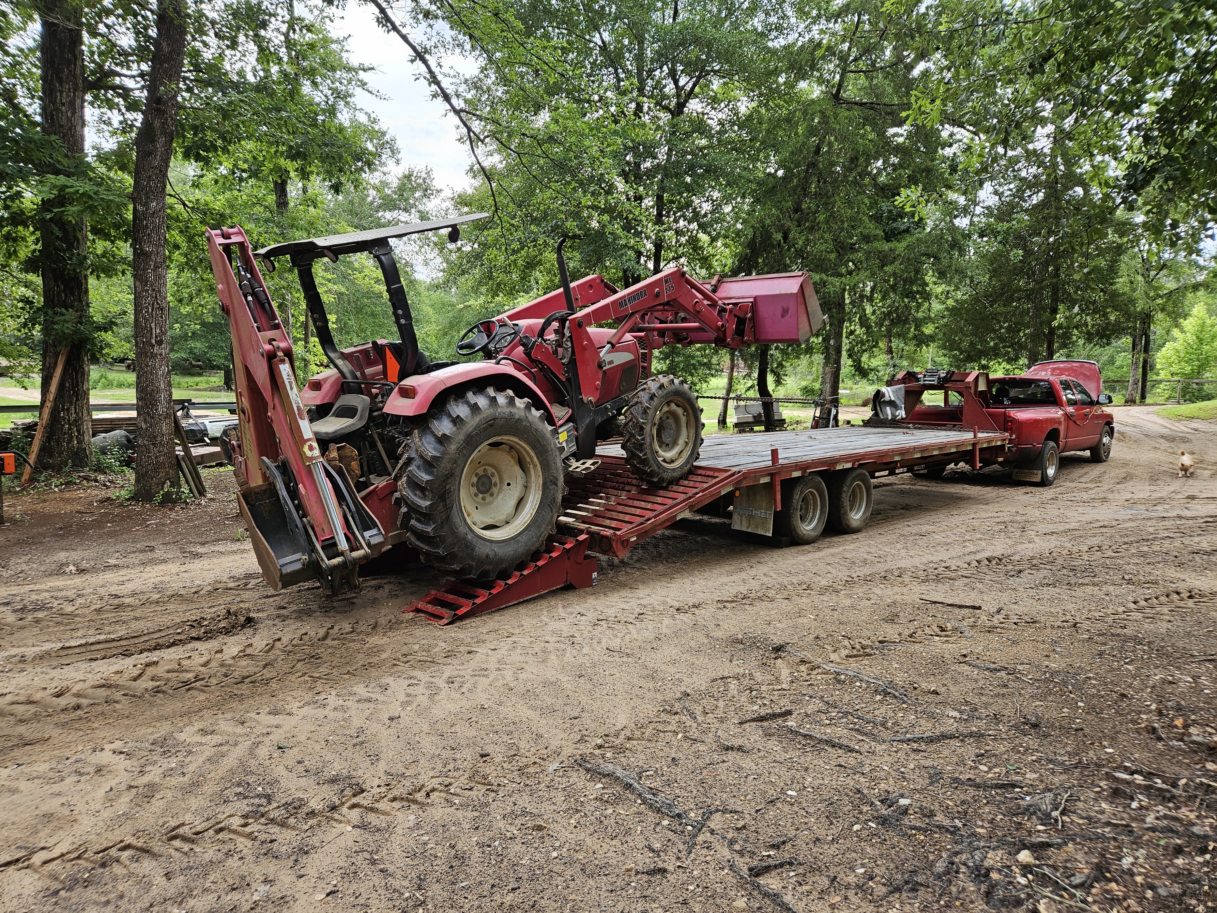

Only thing to worry about when going up the ramps is keeping the tractor centered on the deck and praying the cable does not snap.
Monday I am taking the trailer to get a 3 inch square tube welded all the way forward and on the deck, and a huge D ring welded to that.
I used a chain across the most forward stake pockets for the test and didn't like that. I tried hooking the cable off center on the right stake pocket, but the winch didn't want to spool up correctly. Thus a center mounted D ring. I could weld it myself.
But I can get a pro to do it for bartered 4x4s, and for this I don't want any weld failures. That is, I don't trust my welds with my life!

I would think with fully aired up tires and a freed up gear box, the beefiness of that front end axle and triple pivot points should be more than sufficient. I might be concerned about the front "raring up" with the winch mounted that high on the trailer when the back wheels hit the base of the ramps though. Might want to have a plan B to keep the winch cable 2 feet off the deck + or - at that point.
The winch had a snatch block on the cable chained to the trailer deck. So the snatch block effectively pulled the tractor up at half the height of the winch.

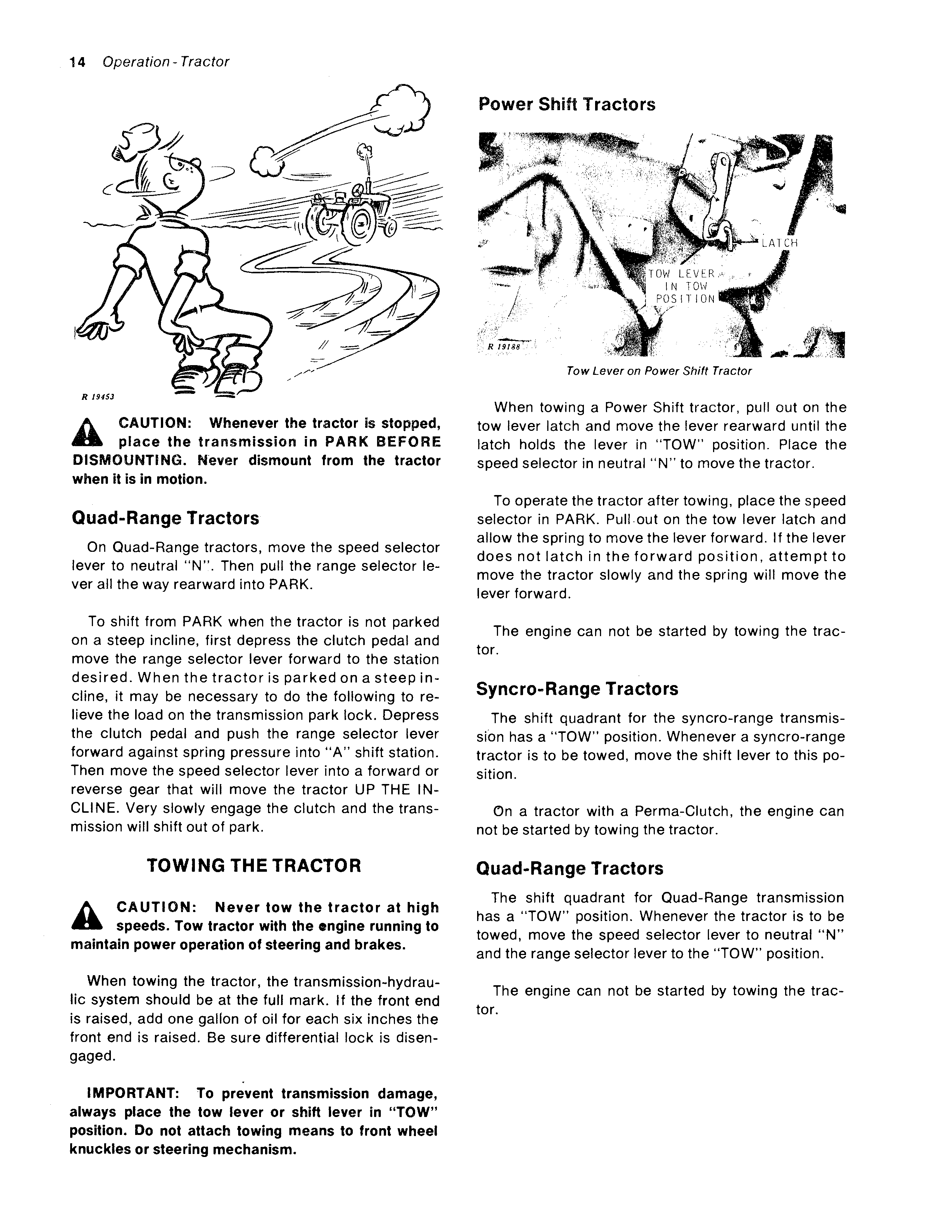

Now that your set on pulling it on the trailer make sure you put transmission in "TOW". From the pictures I believe it is a quad range. There is a tow spot for the range lever, gear lever in neutral. If you don't find the original owners manual, when you get one make sure it is the correct one. There is a serial number break for them.

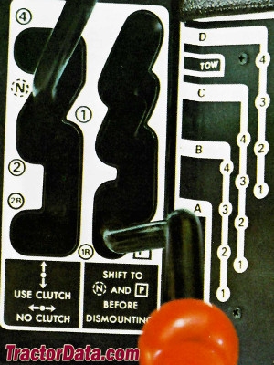

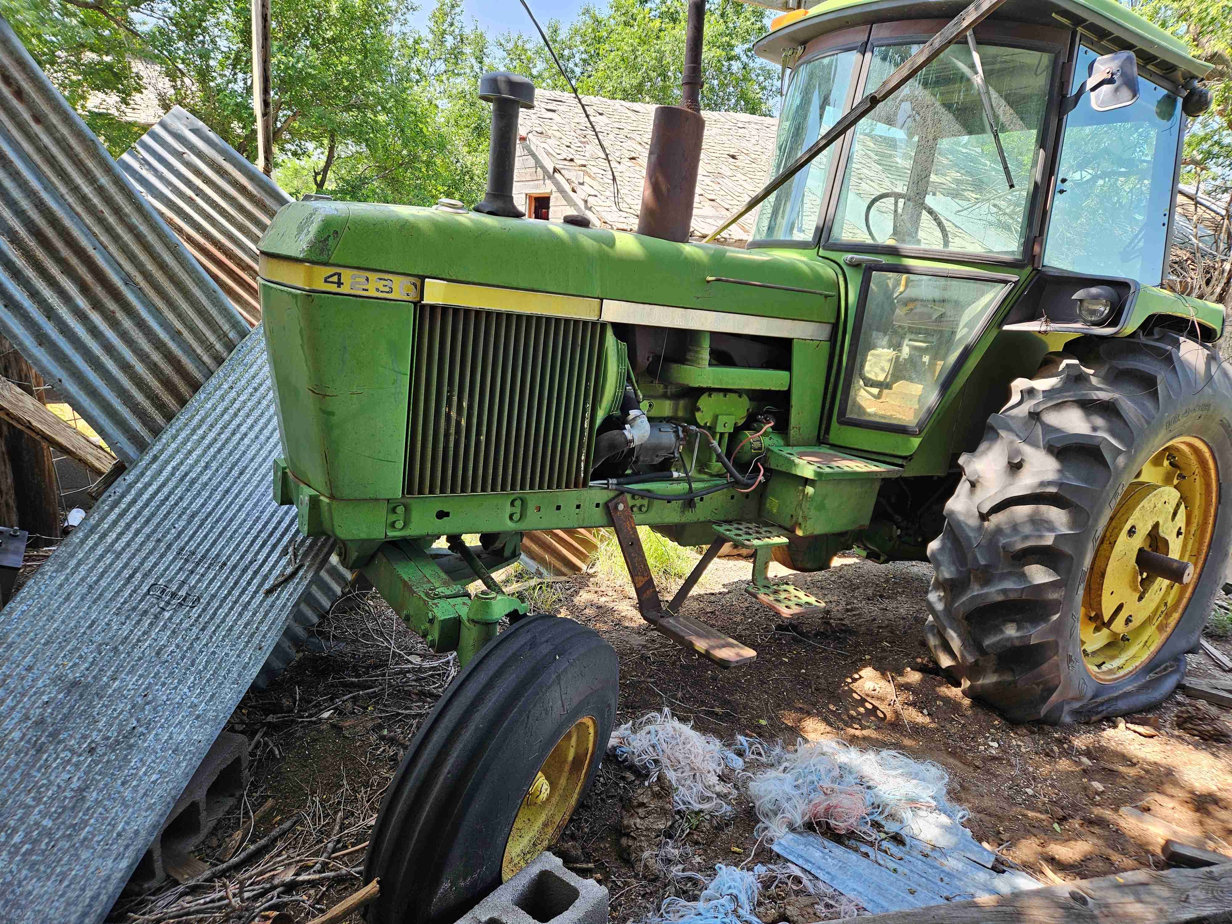

So it is this transmission shift pattern...
How can you tell from the photos?
I printed the page you posted from the manual. It's a big help if it is a Power Shift to know about the pin and lever!

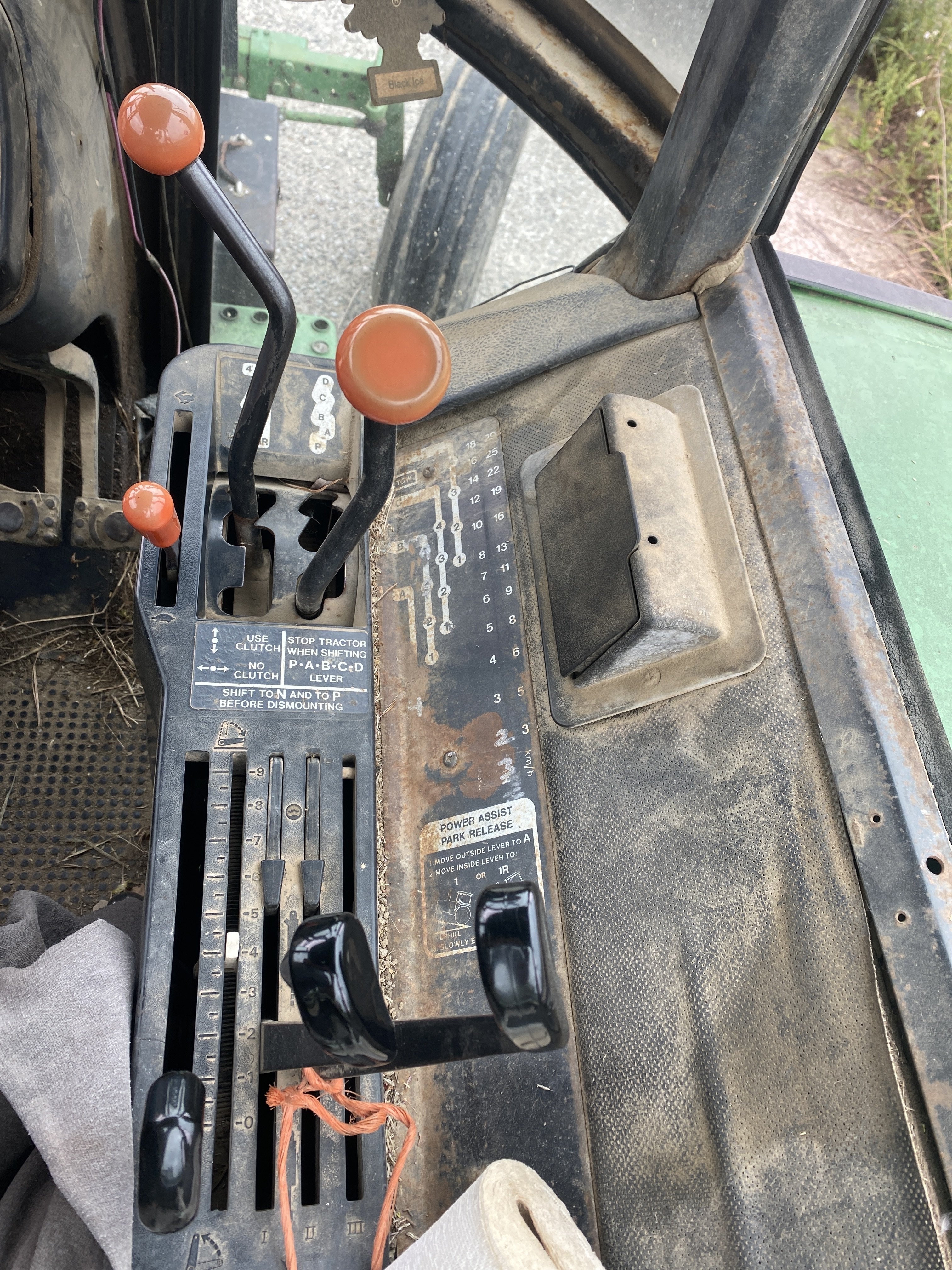

Move handle with orange knob to location marked "tow" leaving other gearshift knob in "N".

That shift pattern is correct. When all you do is look at tractors and study them and people don't put in all the details you look closer at pictures trying to find your answers. Helps that 99% of what I have now and 100% what I grew up with is JD's from the 70's-80's The giveaway was in your photo. You can see 2 levers for the transmission. No need to blow it up. clear as day it has a Quad Range.

I blew it up and see the quad shifter knobs with the levers for the 3PH. What is the smaller knob to the left? Throttle?
Blowing up the photo also confirms what I thought. A part of the shed roof cracked the cab and looks to be a big chunk missing.

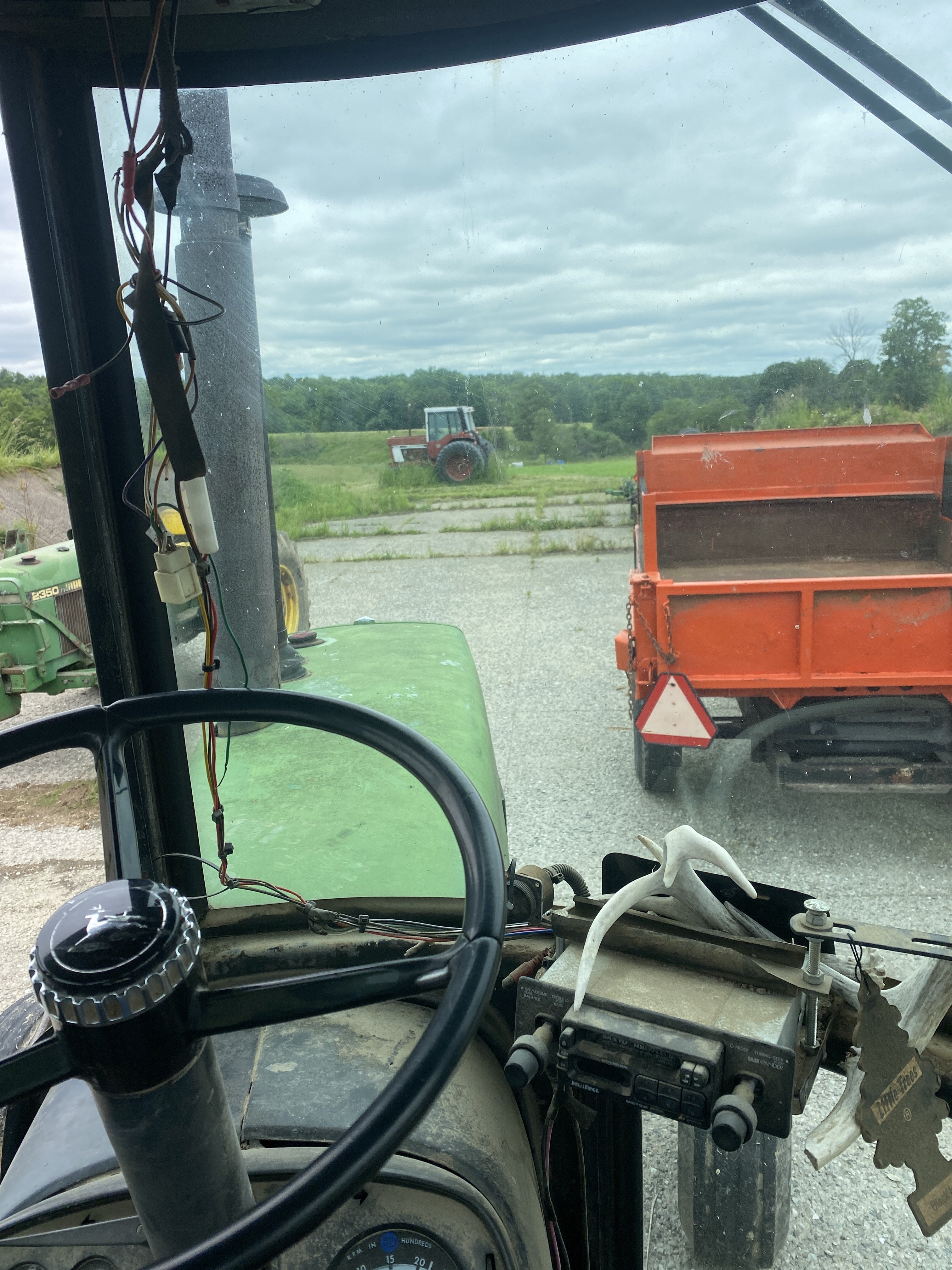

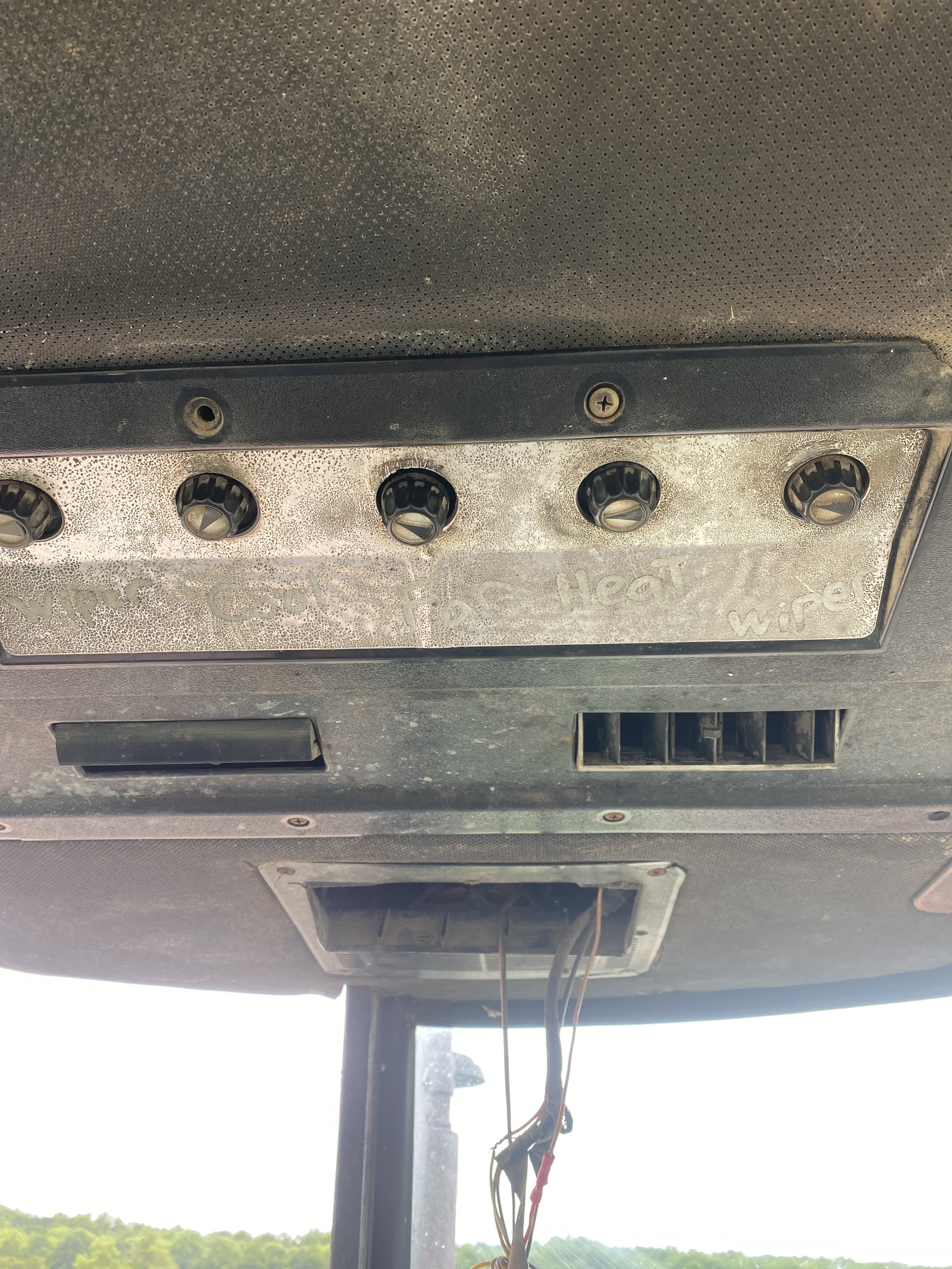

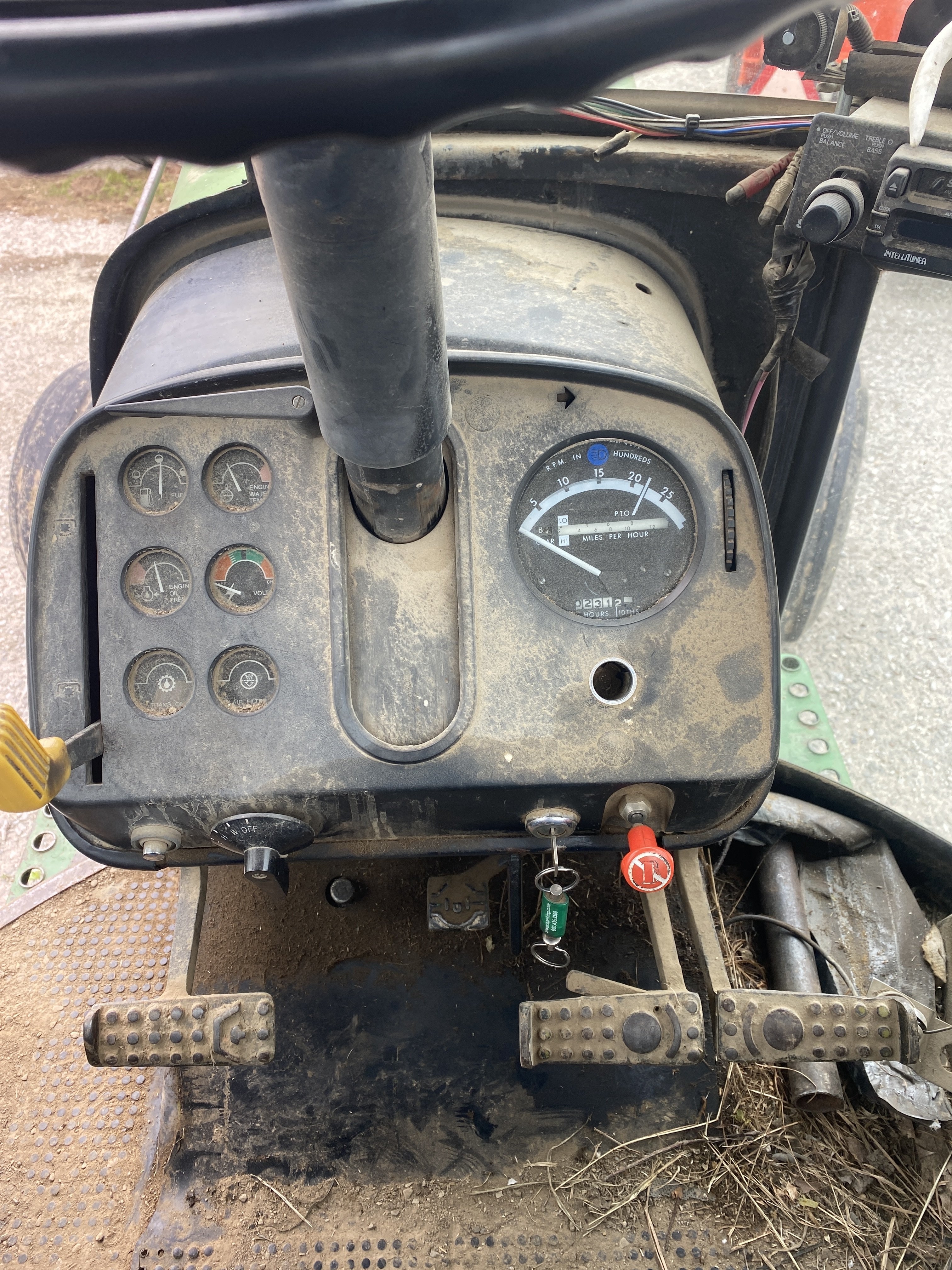

This is the layout of your tractor. I need to move my radio back to where it belongs some day. This is the way I bought it.

That tractor will not start with a tow. The tow position in the shift pattern is so that you don't damage the transmission while towing the tractor.
