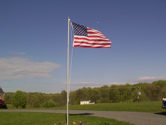

Instructions from the back of the package of 50' of Outdoor Wire 14-2 UF-B:
<font color=blue>Installing:
Type UF-B cable should be buried at least 12" deep when used without conduit. Conduit should be used whenever there is danger of mechanical damage to the cable or whenever the cable rises above ground. The National Electrical Code and most local codes require the use of Ground-fault Interrupter with outdoor circuits to prevent serious electrical shock."</font color=blue>
I had planned to use my sub-soiler to install the cable 12" to 14". I only have a run of about 20 feet to the flagpole.
Do you all think I will have an issue?
   / Under ground cable #35
Mike,
It could meet the NEC requirements, if it is Ground Fault protected and 20 amps or less, 12" of cover is fine. If not GFCI protected, NEC requires 24" of cover. But think of it this way also.....if I could hit it at 12", I'd probably hit it with the same equipment at 24" /w3tcompact/icons/grin.gif
   / Under ground cable #36
Jerry,
Thanks for the info. I am only running two lights to illuminate the flag pole at night. I will replace the current electrical socket with a GCFI (is this a complicated procedure or just like any other socket change?).

   / Under ground cable #37
An easy job. Just replace it with the power off. There are markings on the back side of the GFCI labeling each screw. The power coming in goes on the "LINE" screws, and the power going out to your lights ( and method of controlling them) goes on the "LOAD" screws. Black side for the black wire, white side for the white wire.
Just an FYI for everyone reading these posts, the NEC is the MINIMUM requirements. Feel free to exceed them, but that is the minimum you should do for safety sake.We all want to wake up for another day and enjoy our kids, and their kids.
