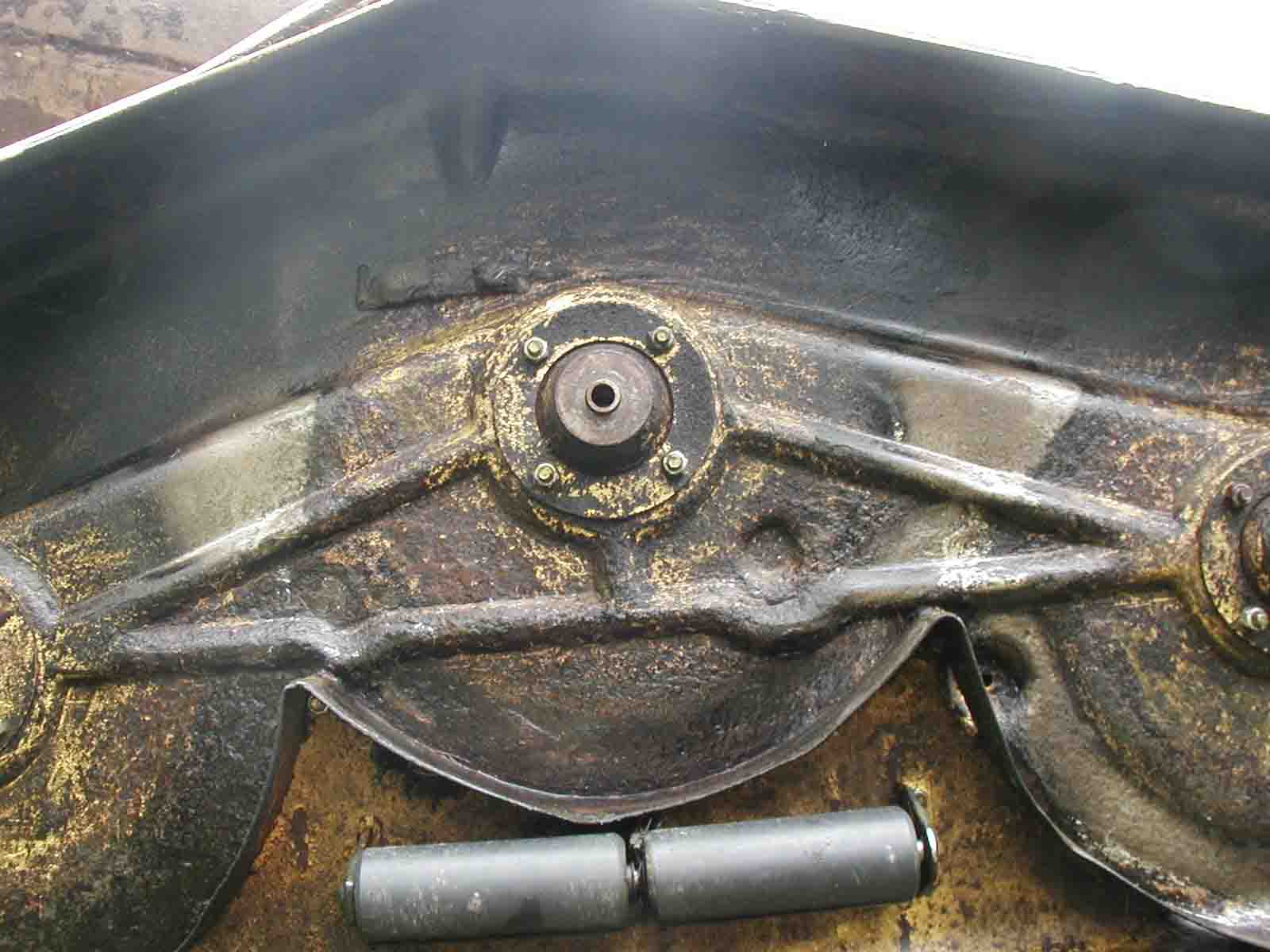

Gary,
All of the responses to your question got me thinking so I decided my MMM deserved an early scraping. Actually I wanted to verify what I had written earlier about minimal rust as I was going on memory. Sometimes we see what we want to see and I thought "maybe it is worse than I think". There was a little more rust around the center spindle than I recalled but it was still in good shape. I took 4 photos. I have attached the first one and will send separate posts of closeups around each spindle area.
I'm posting these only to show you what the underside looks like after 15 years not to say you shouldn't coat the underside. I am skeptical about how long any coating will last under the deck and the difficulty in maintaining the coating over the years. You are bound to get areas that wear more than others (note the bare metal areas around the spindles in the photos). With one of the thicker rust proofing or bed liner coatings will surrounding areas get even thicker as you touch up the worn areas? You probably will need to do some scraping despite the coating. Will you scrape off the coating as well? In the end you gotta do what feels right to you. Just keep in mind that paint wearing off the underside of your deck after the first few uses doesn't mean it is going to fall apart in a few years. Good Luck.

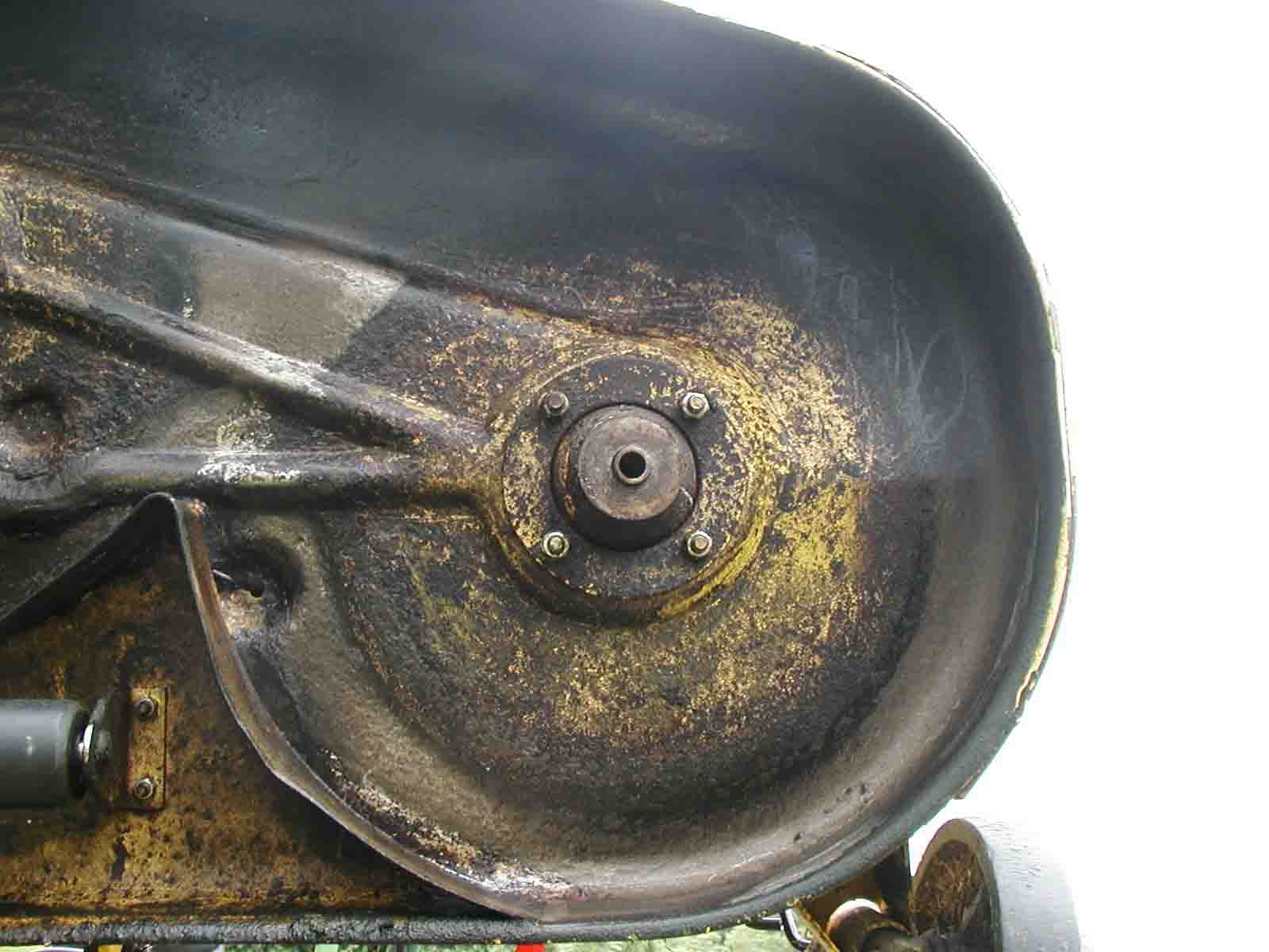

2nd photo

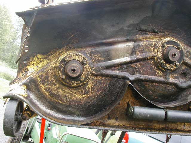

3rd photo

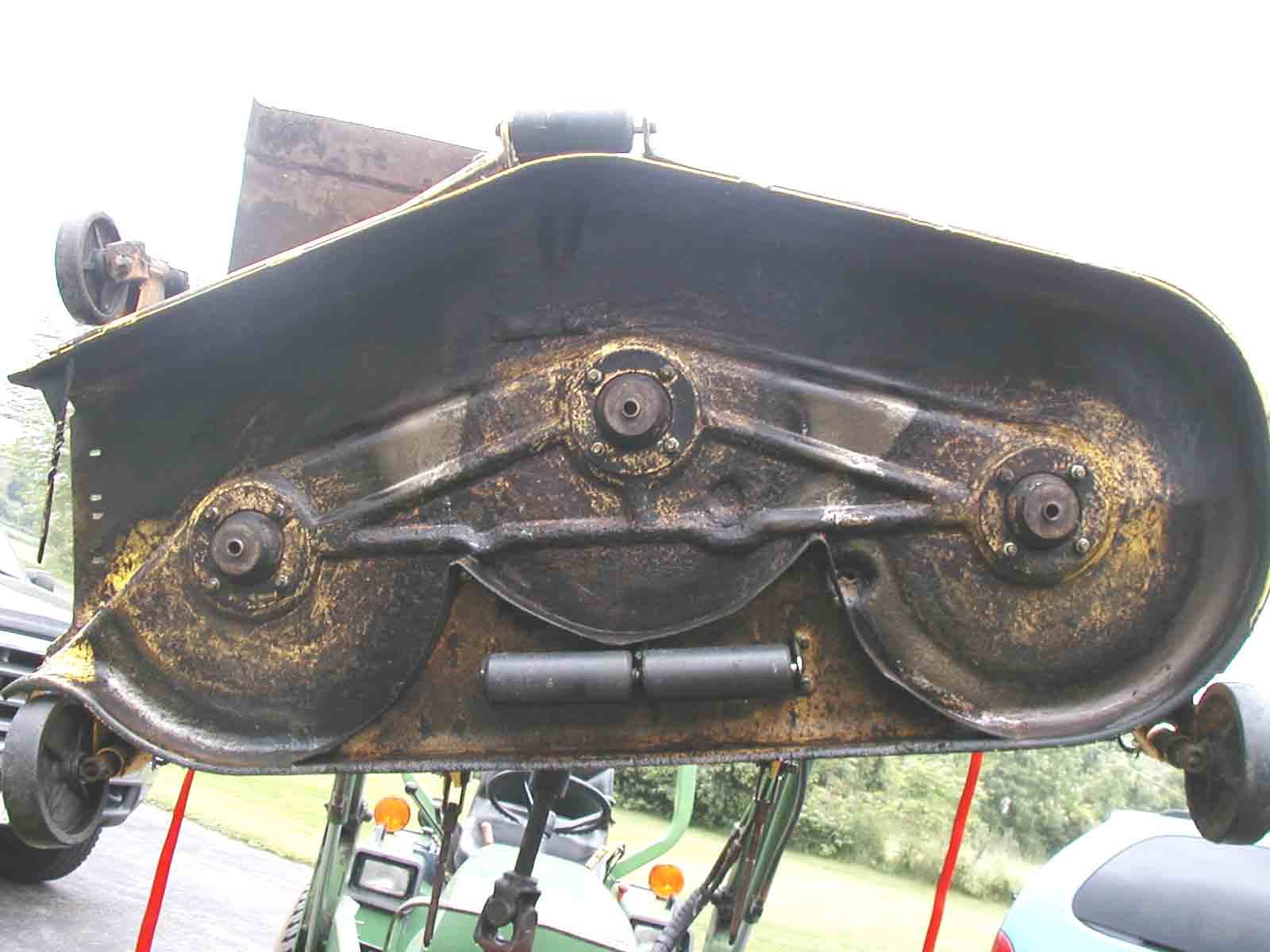

Last photo.

WOW! That sounds as political as any answer I've seen. Not one but two outs for them if it doesn't work. /forums/images/graemlins/smile.gif
After seeing the fifteen year old MMM deck posted here I'm not planning on doing this after all. I guess I'm just not convinced it's going to do all that much for me. I'm going to either use a spray or brush on coating and let it go at that. While I think the $75 per mower is a fair price with the lifetime warranty, I'm just not convinced it's necessary.
