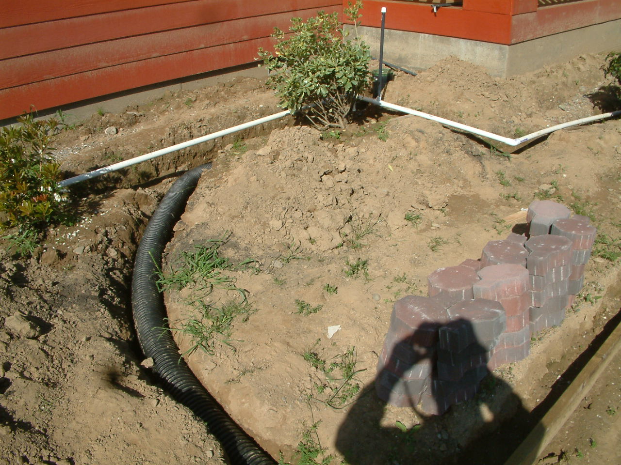

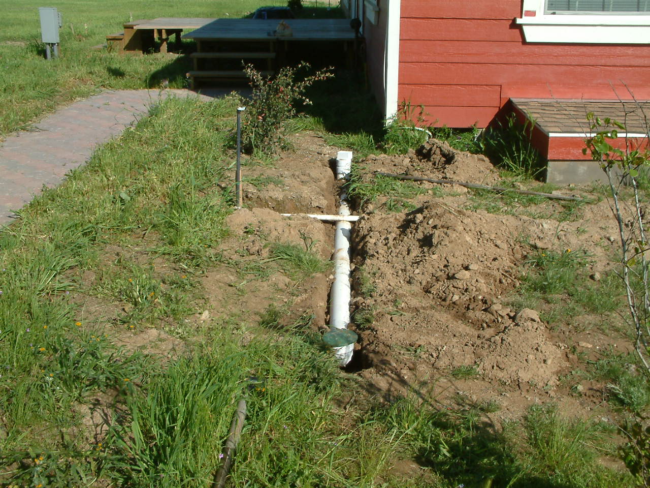

Here's the setup to handle some of the the downspouts on my house. I use 4" PVC pipe, two 90-deg elbows and a pop-up drainage emitter to get the water about 10 feet away from the foundation for the South side of the house.
One the North side I use the 4" black corrugated pipe and run to daylight about 30 feet from the foundation.
