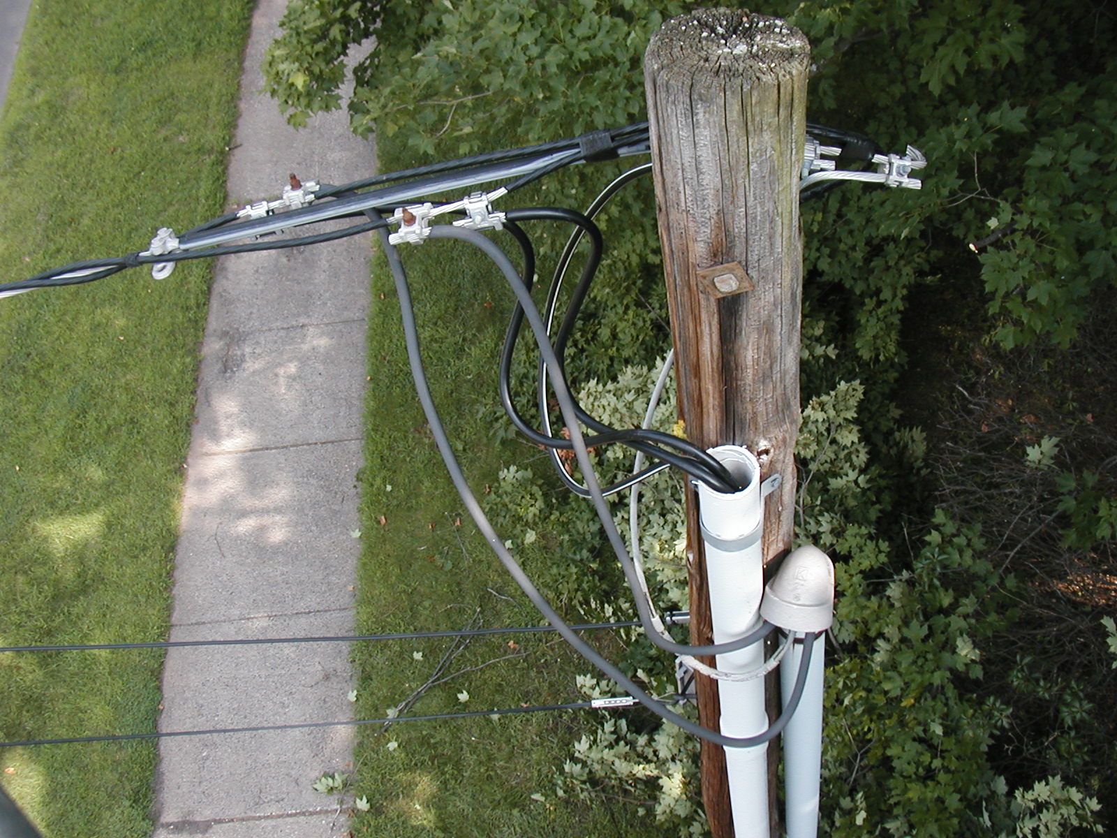

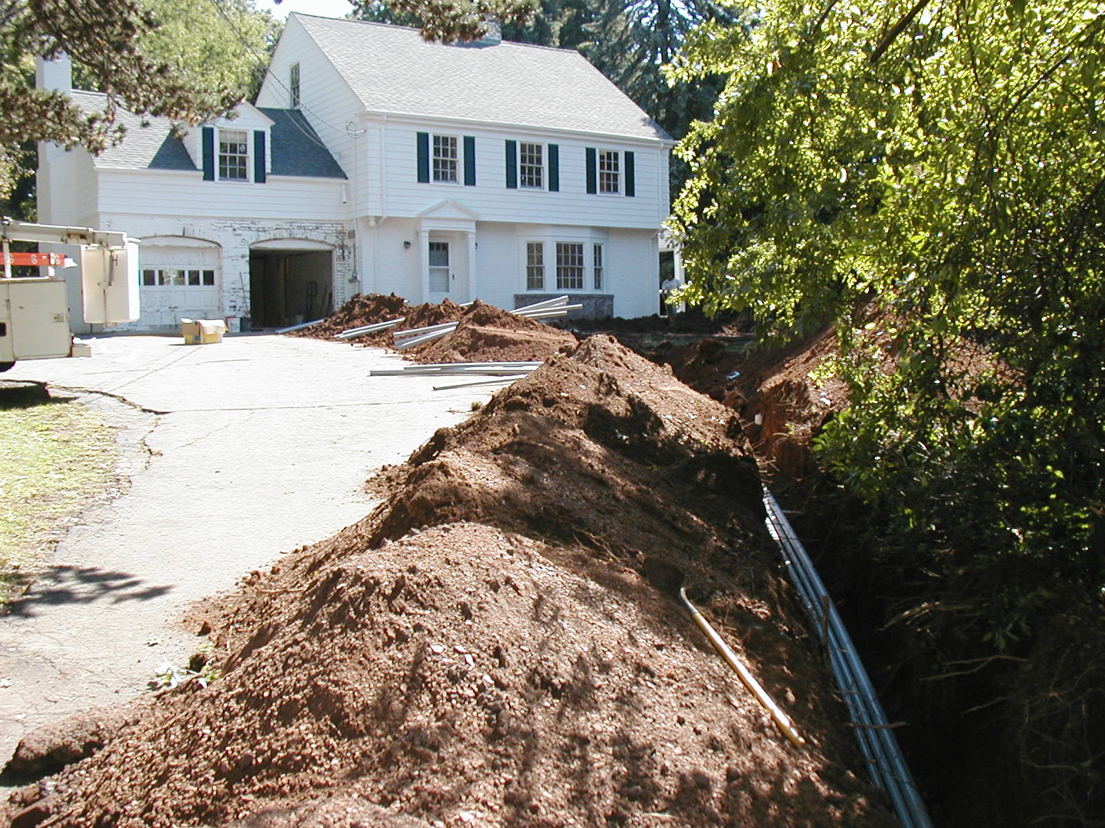

I had to install the 3" pipe 100 ft from the pole to the house and buy the wire. but now they own it, if something goes bad they replace it and not supposed to cost me any more.
This was 4/0 al, on the day they pulled mine all the linemen were admiring the new wire they were using, they said this was the first job they used it on and that the insulation was much thicker than normal. Hope so, look how they left the top of the pipe, no weather head!
Called them and they said don't worry all conduit is full of water?
JB.
New conduit is not full of water, but all old conduit is full of water.
JB.
Most power company's put a filler in the pipe not a weatherhead on a secondary riser like you have on your pole, the ones we use is 3 part first you stuff foam down into the pipe around the wires this keeps the 2 part liquid that you mix together from running to far down into the pipe and in a few minutes it is hard, it keeps the squirrels from getting down into the pipe and helps keep the water out, we use these on everything from a 1-1/2 streetlight riser to a 6" 1000 mcm primary riser and they seem to work well.
So is the water anything to worry about? or is it more critters?
The odd thing is that other pipe with the weatherhead on it just goes down into the ground with direct burial underneath. Goes to my shop in the back.
This pole is right at the bottom of a hill so I know there could be a few feet of water in that pipe. I do drainage work, and if I thought about it I would of put a draining tee right at the lowest point. afraid to try and do anything like drill a hole in it know, don't want to damage the wire or get zapped
I've seen electrical manholes just totally flooded with water, with all the electric underground I guess it's not as bad as I think it is. My buddy has a manhole on his property in a low spot near a brook crossing, right next to a sub station, that thing pours water out the top for days after a rain, so I know it must be full all the time.
JB.
