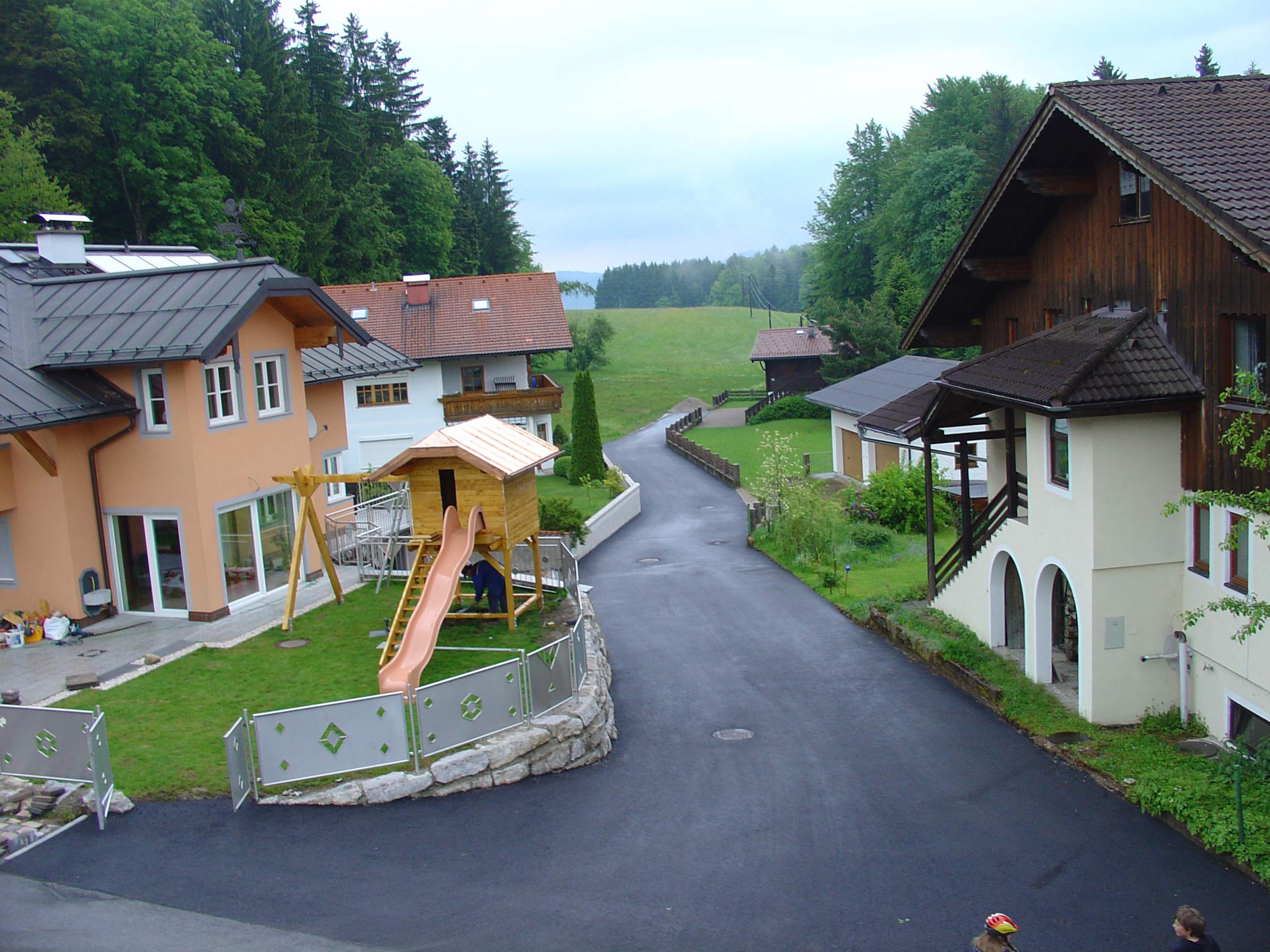

Here are two pictures showing my cuddle-sack...
I built before the other homes and put in the road to the last house on the right looking towards the forest... thought about metal roofing and in the end couldn't justify the copper... I do have copper flashing, gutters, downspouts and all the exterior window sills are copper is is my z-flashing where the wood meets the stucco.
What is interesting is the first house on left is all copper roof with ice stops...
If you look closer you will see the kids playhouse... the roof was just put on that week and the kids playhouse roof is all copper and the fence around the yard is all stainless... stainless tubing with the welds polished out and stainless panels...
