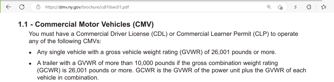

   / Understanding Curb Weight, GVWR, Towing and CDL requirements #280
@screamin400 that seems like a big mistake for someone who just studied and tested on this topic.
LD1 is correct, and NYS law appears to be consistent with most other states cited in this thread.
From New York's website:
That is possible I suppose. I know of no one pulling a 10000 gvw trailer in my line of work. I am pulling a 25k trailer.
