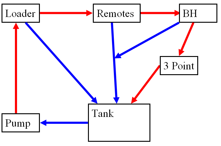

I think it's the "waste hose" as you call it that has me baffled. I can understand PB in and PB out. What's up with the waste hose??
Specs on Challenger:
System type: Open center
Total Pump Flow: 14.9 GPM.
Flow to Remtoes: 10.5 GPM
Power Steering: 4.4 GPM
Being as you could be using something downstream of the PB out (ie: if your loader is before the backhoe your fluid flow could look like (Red is high pressure): PB In on Loader > Loader > PB Out on Loader > PB In on BH > BH > PB Out on BH > Three Point Hitch > Tank)
Thus you might be trying to lower the loader while the curl circuit on the backhoe is engaged, then the fluid trying to exit the loader would have to get to a high enough pressure to make the BH pressure relief go into bypass before it could get to the tank. That would be suboptimal and would make doing anything difficult, as such there is a "Waste" hose that is guaranteed to go directly into the tank without any blockages or significant backpressure no matter what.
This way your fluid flow in the same situation would look like (Red is High Pressure, Blue is Low pressure): PB In on Loader > Loader > Low pressure waste line > Tank less complicated and easier on the equipment
Here is an system fluid flow diagram as it would probably be for your tractor with the BH installed. Blue is low pressure, Red is high pressure
Clear as mud?
Aaron Z
