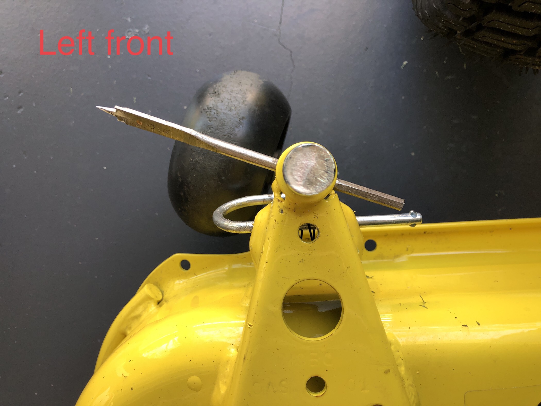

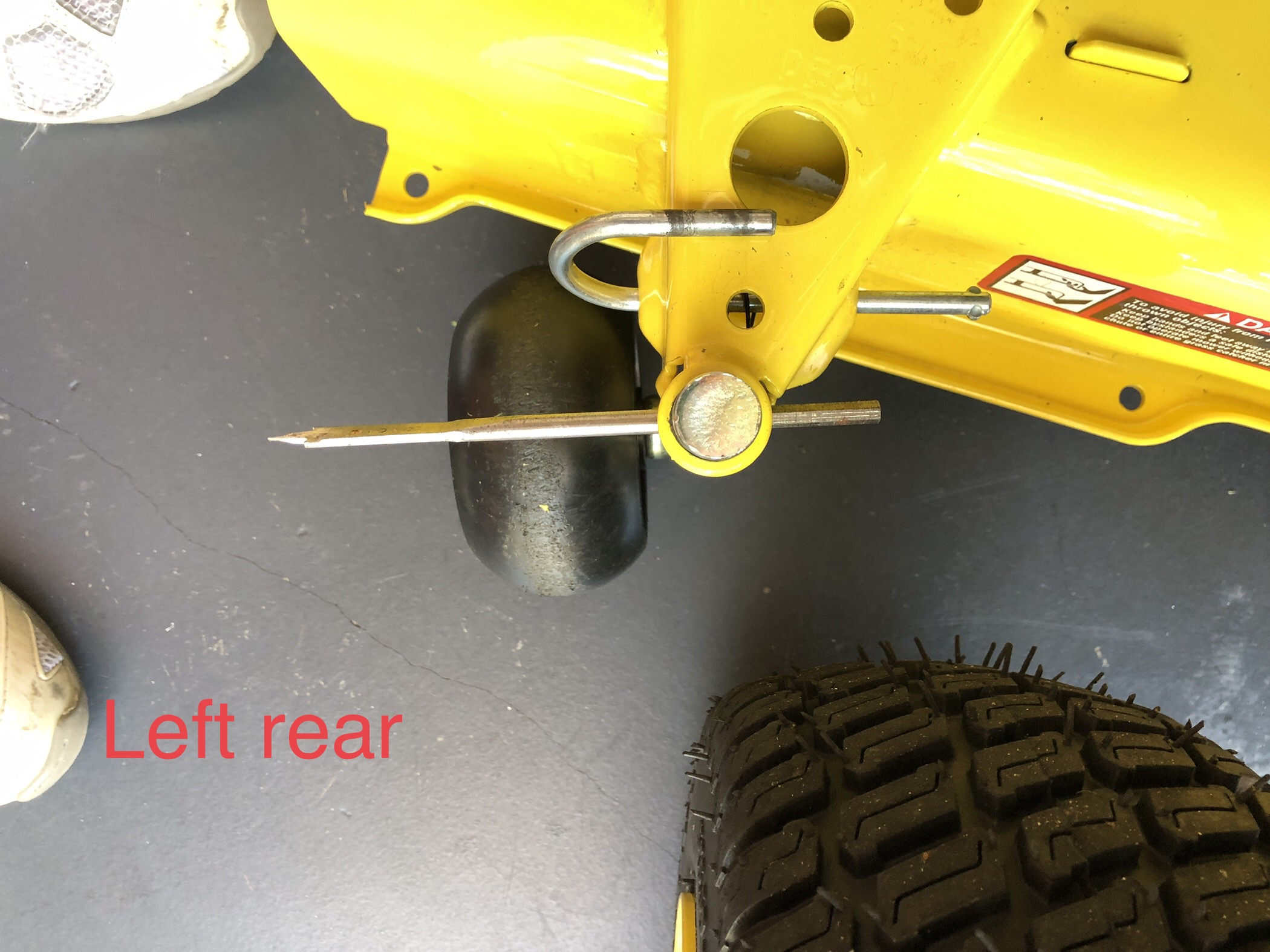

IMG_7716.jpgIMG_7717.jpgThanks for your reply, I noticed the brackets which hold the anti-scalp wheels are not all the same height from the floor with the deck set at mowing height and the wheels in the full raised position. Front left is about 1/2" lower than the left rear while the right front & rear are the same height. The deck looks to be in perfect condition, no dents perhaps a bad weld? I also noticed the front left wheel does not ride at a 90 angle to the forward motion of the tractor. Right side front and read are in a 90 degree angle.

Hello, listen, if I'm at fault so be it, I don't think of mistakes as errors but as learning experiences. How I leveled the deck on my agrage floor which does seem level:
1. set brake
2. adjust tire pressure front 14# rear 10#
3. set deck to 2 1/2" for leveling and raise all anti-scalp wheels
4. level with the plastic level gauge and tool, left rear, right rear, front, left rear again, left rear agin and front again. Repeat until all are the same height
5. set deck to mowing height and lower anti-scalp wheels to approx. 3/8"
I'm told this height is too low and should be 3/4"-1"
I have noticed the brackets which hold the anti-scalp wheels are not all the same height from the floor with the deck set at mowing height and the wheels in the full raised position. Front left is about 1/2" lower than the left rear while the right front & rear are the same height. The deck looks to be in perfect condition, no dents perhaps a bad weld? I also noticed the front left wheel does not ride at a 90 angle to the forward motion of the tractor. Right side front and read are in a 90 degree angle.
Thanks again.
   / Uneven lawn cut #17
Sometimes the anti-scalp wheel pin holes are NOT accurate when compared to the blade height. Case in point.....my X744 and it's 62" deck. I run the wheels one hole lower on one side than the other side because I want the blades level, not symmetrical looking wheels. This puts the wheels and blades on parallel planes. Yes, I used the blade height guage, checked tire pressure etc etc etc.
   / Uneven lawn cut #18
The left anti scalp roller seems crooked as stated. Don't know if weldment is off, but still should not affect cutting.

Your leveling technique/procedure appears to be right on.. I would get a block of wood and check that the tips of the blades are all the same or within an 1/8" of being the same.
Sounds like your dealer doesn't have a clue what to do, and when I worked some part time with a good local JD dealer, learned that the shop manager was setting up a JD mower for a large local farmer that bought a lot of JD equipment. That farmer was always complaining about how poorly his JD $10,000 mower was cutting. I was sent out to check.. the mower deck wasn't even close to being "leveled" per the procedure outlined. Got him fixed up and learned a bit more about the shop manager.. 'nuff said.
So think it is up to you to find out what is wrong, and toss the knowledge back to this dealer. Or ask for a new deck, or lawn tractor that the deck can be leveled, and one that is of the quality of your 318 (if I recall correctly that it is what you had before). Those are $10k tractors now, to be equivalent.
