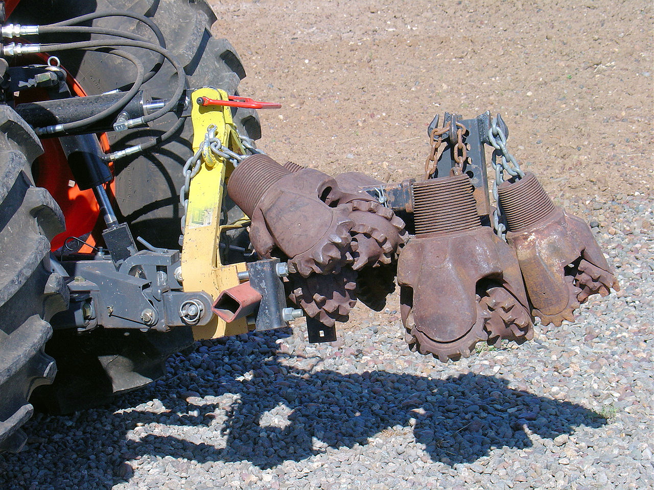

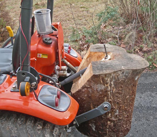

Based on some neat comments in other threads, I'm starting a "show us your unique ballast ideas" thread.
The first two shout-outs go to members Chelydra for a cool log idea and gwdixon for his drill bits!!!
Show us your accomplishments please :thumbsup:

I am honored to be included on jimmyj's list. My solution may be more sustainable, but the drill bits are classier. I need something like that on my car to hold back tailgaters - one look at those teeth, and they'll ride the brakes instead of the gas.
I actually looked around for something large, iron and free before shaping that stump. I'm thinking that a small engine block should be about right. Just run a threaded run through the crankshaft holes, and tighten down so it doesn't sway. Anyone here ever try that? Or maybe a stack of old truck clutch plates or brake discs.

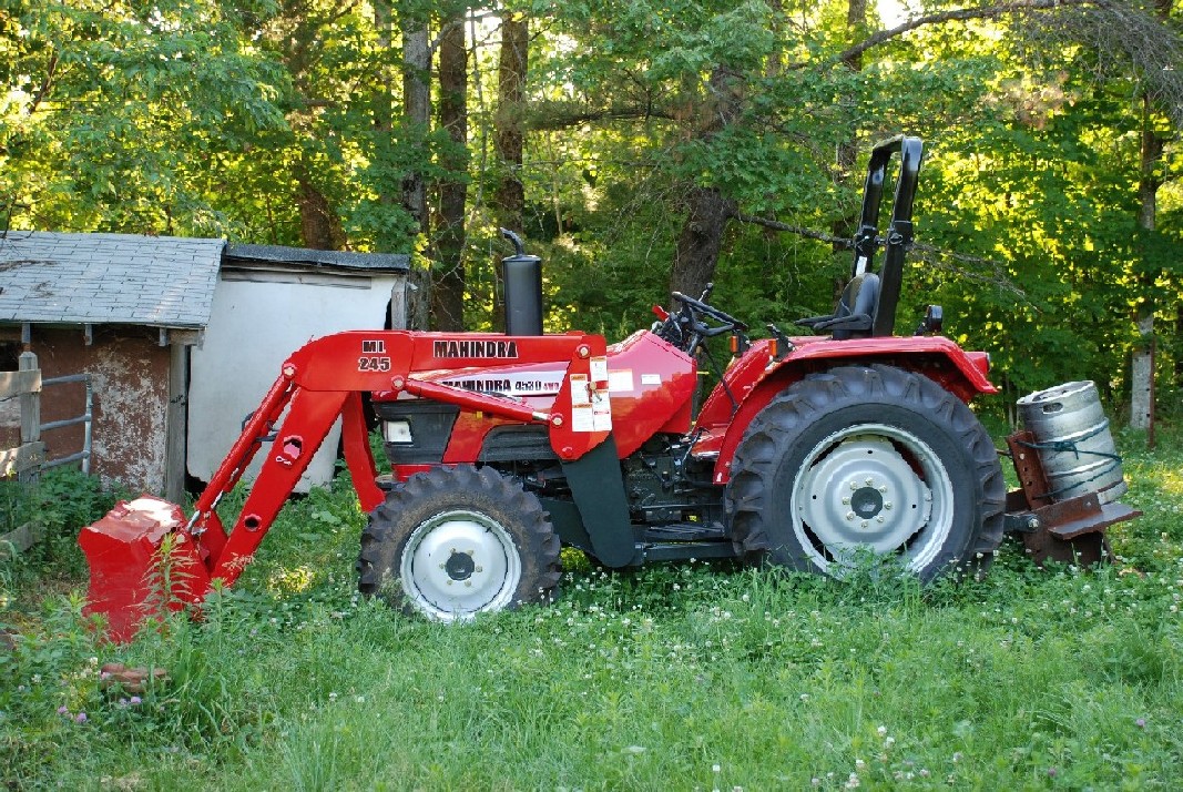

Ok I'll post it, but no ridicule this time. The bulk of the counterwieght is a wide flange beam. It weighs around 500 lbs. It wasn't heavy enough so I annded the keg, which is filled with lead weights from car tires. That added another 300 to 400 lbs.

Are you sure it is only lead in that keg. :drink: :D:D
/ Unique ballast ideas #9
Wait...is that a hose I see running up to the drivers seat... :)

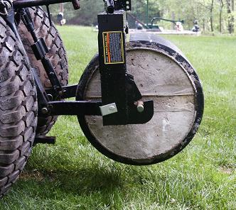

MD, is that a culvert section with concrete in it? Looks really easy to take on and off. Great idea.

Yes it's a piece of culvert filled with concrete and a 1" piece of shaft through it.
No top link required. By my calculations it weighs somewhere between 500 and 600 lbs.
