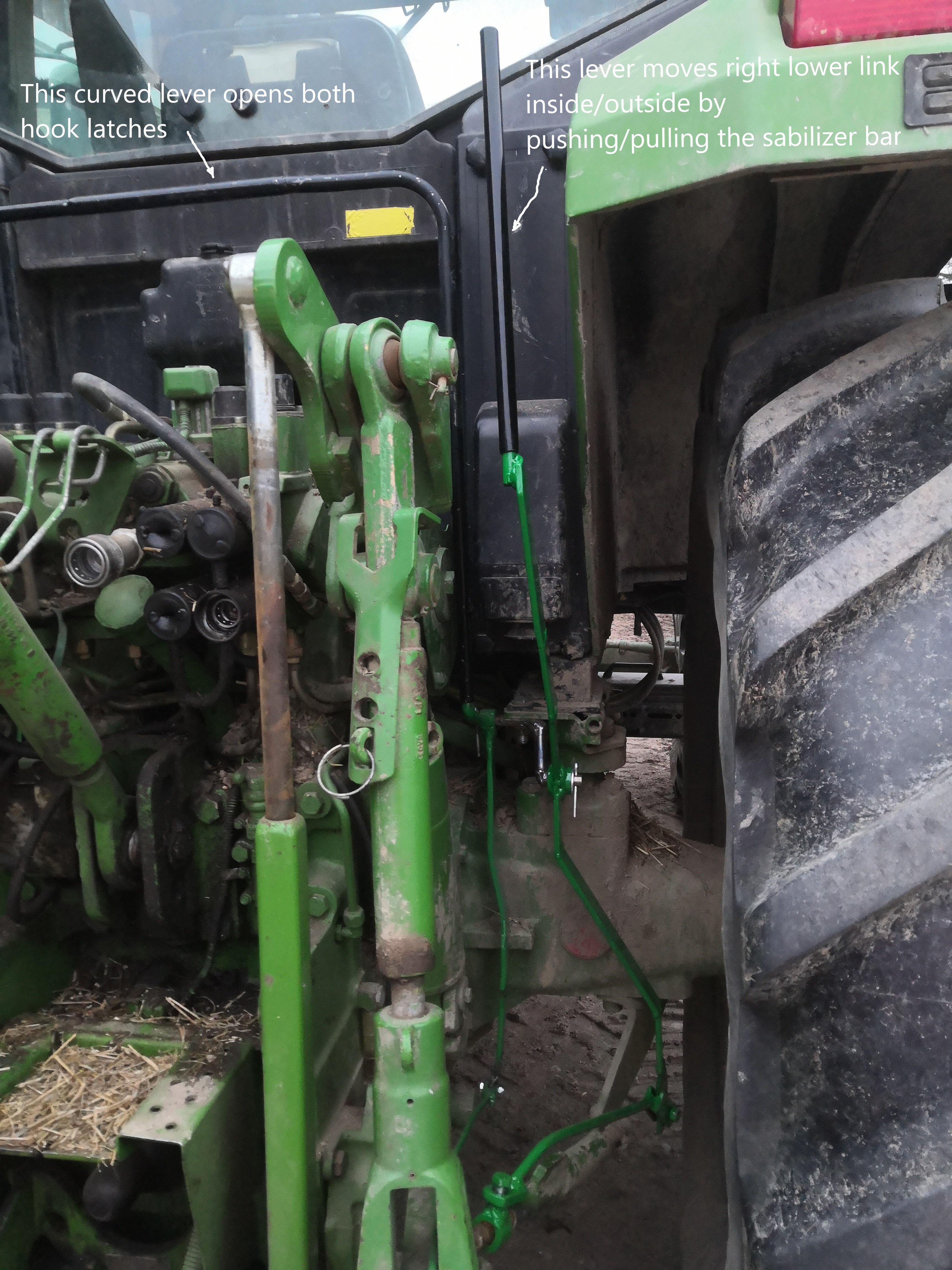

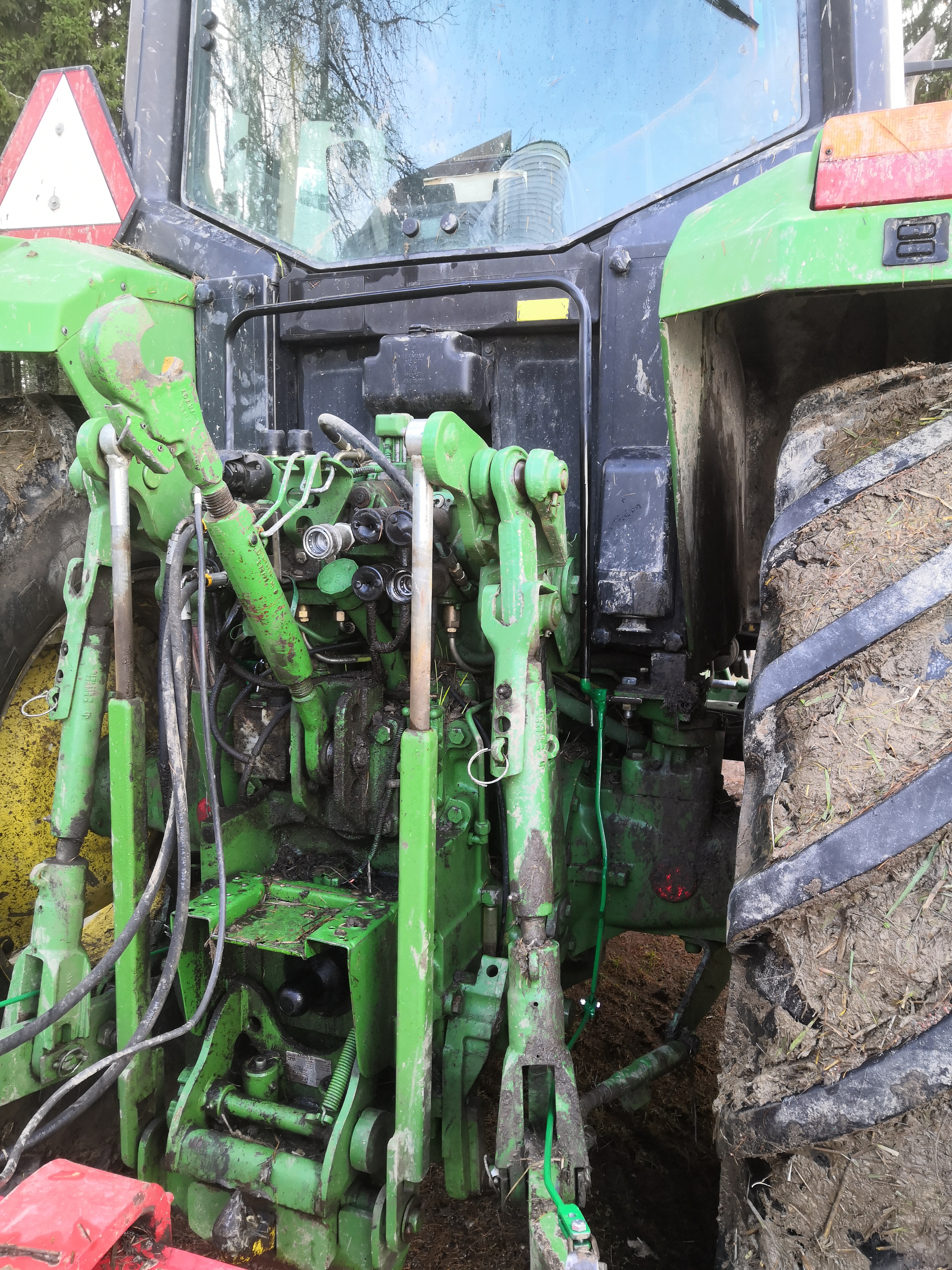

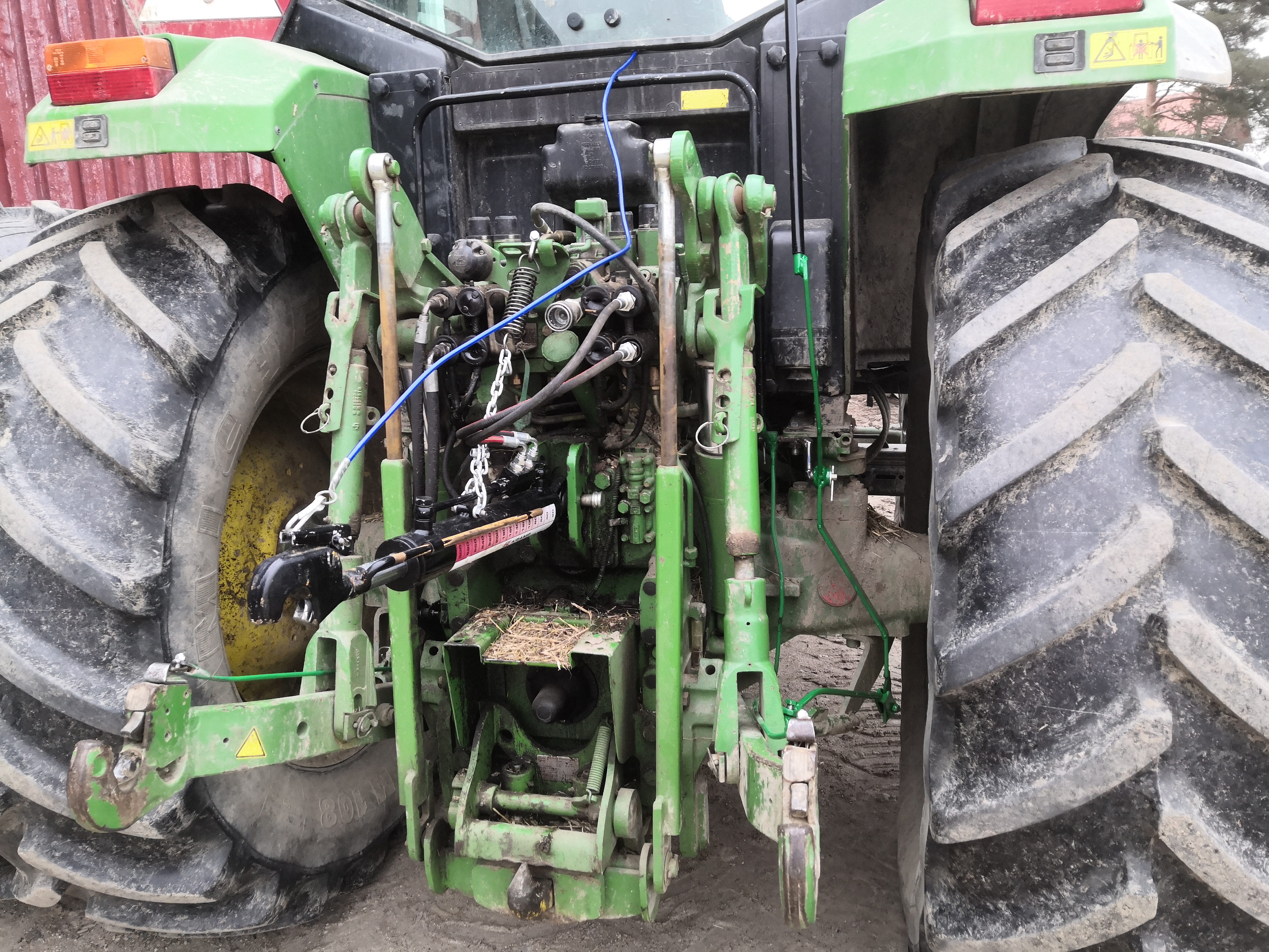

John Deere is ready now to be operated from its cabin for hitching/unhitching.
Before I made a linkage to open both hook latches together from the cabin for unhitching.
Now I have a new linkage to move the right lower link sideways from the cabin.
It makes possible to use two different category equipment with the same tractor.
And non standard equipment too.
Parts are quit simply
And now it has a new hydraulic top link too.
I think that this is the most cheep way to operate from the cabin.
If you like then hydraulic stabilizer bars are good too but expensive.
Now every tractor new or old can get weldable hooks and operation from the cabin.
I have made what I can. Now you must go on!
Good luck to you

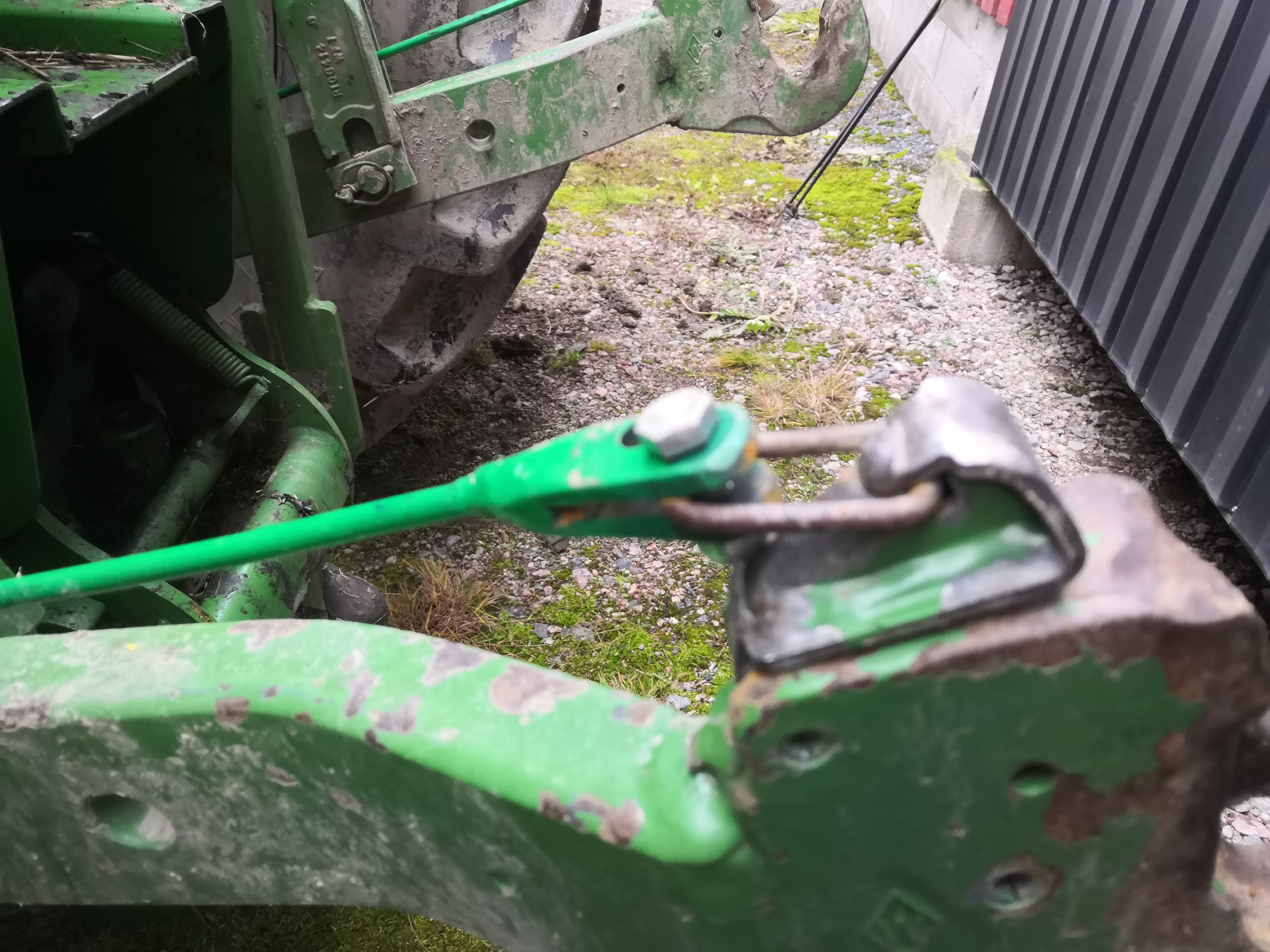

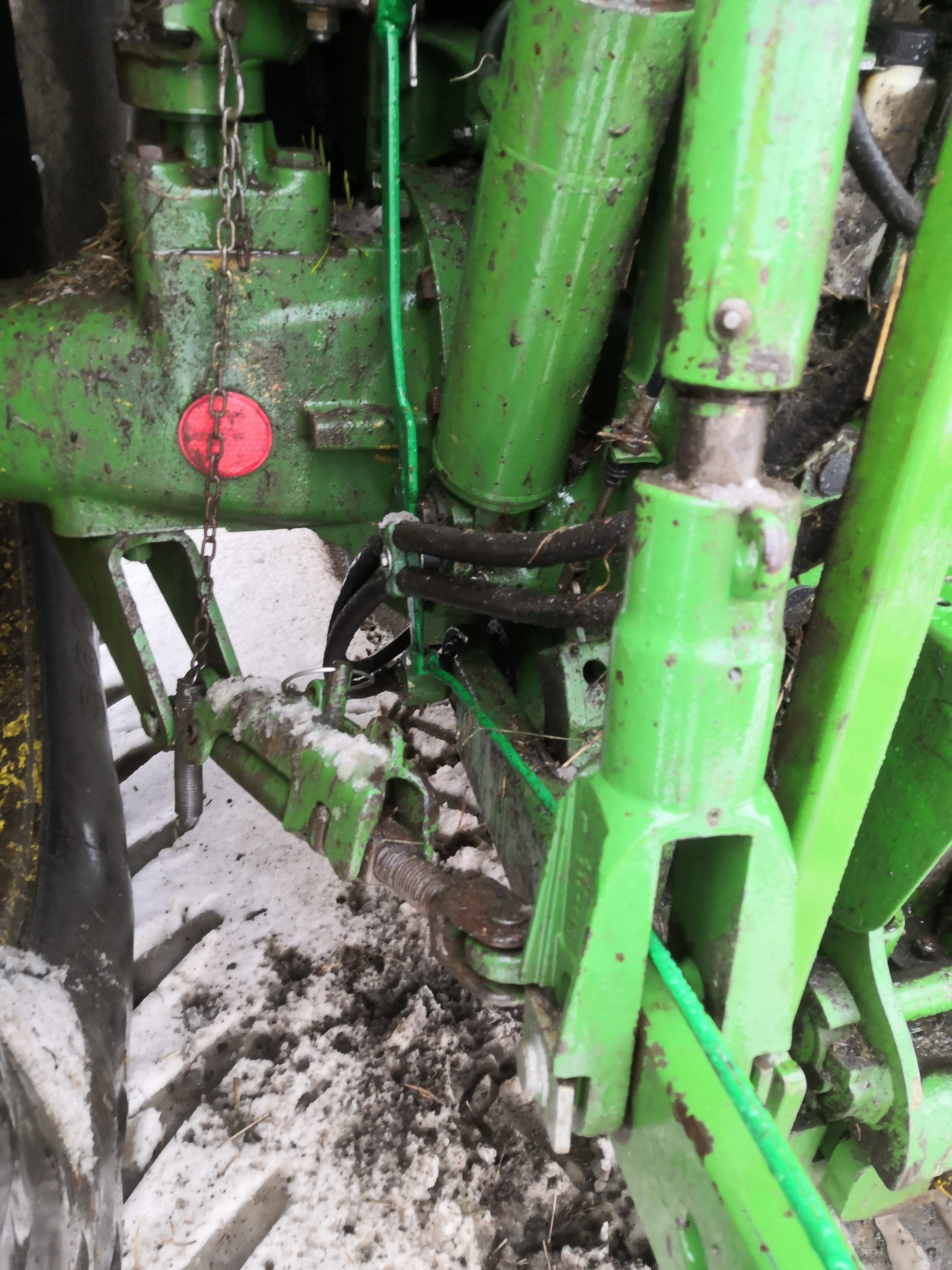

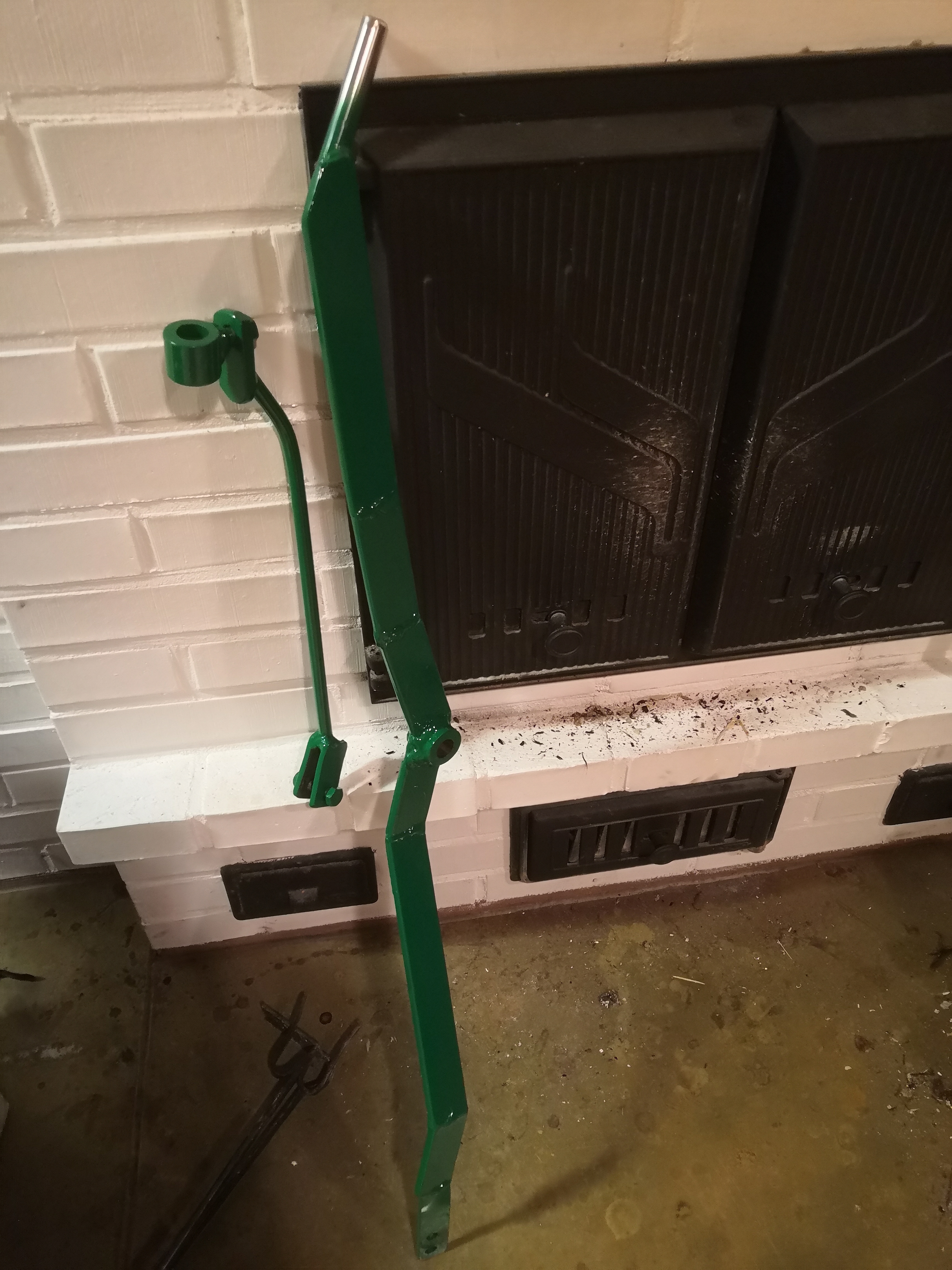

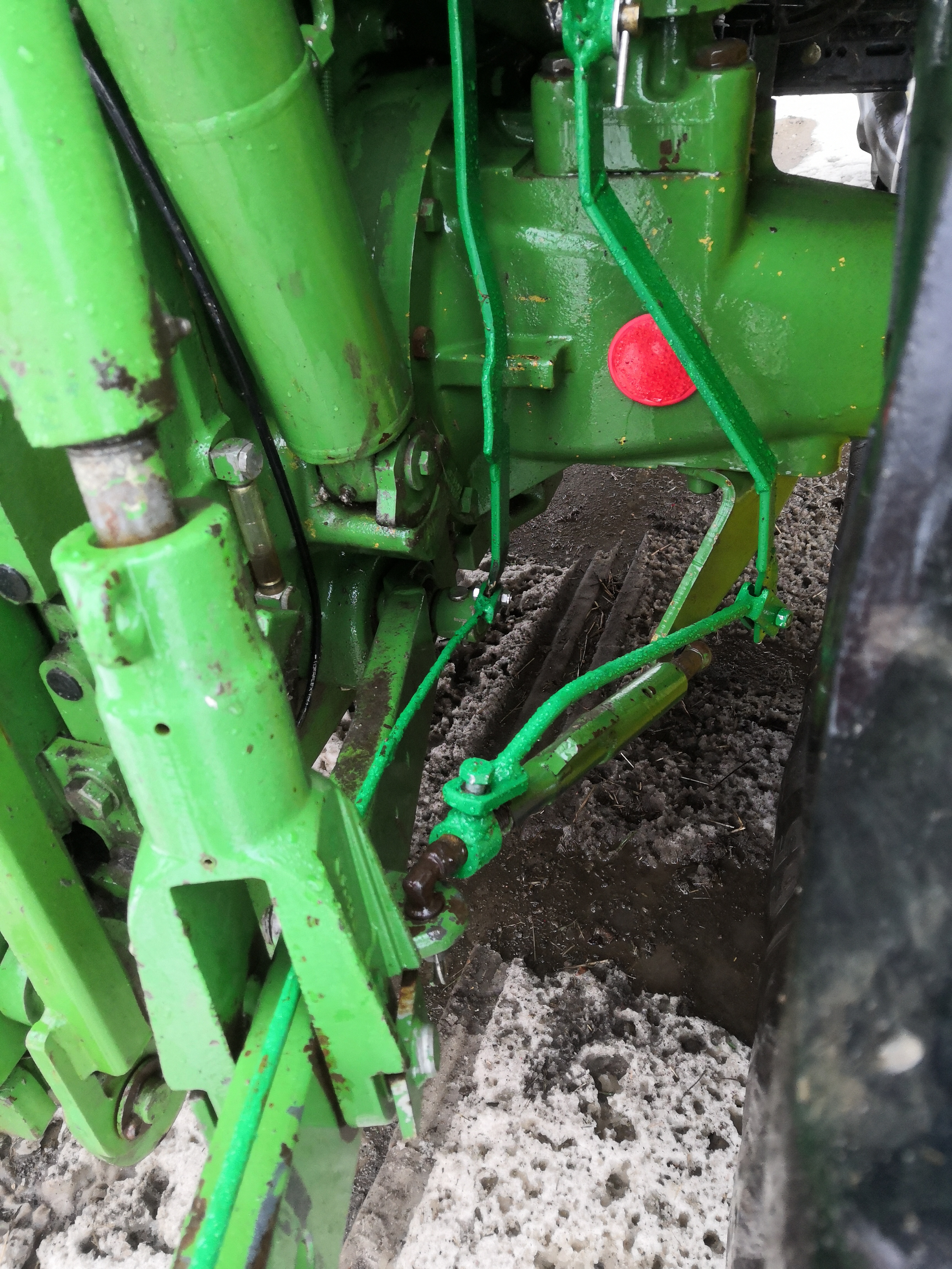

New pictures of moving the stabilizer bar from the cabin when hitching the implement.
There is a new lever and linkage for the right spring loaded stabilizer bar and the lower link.
Left side locked stabilizer bar and hook latch opening rod.
