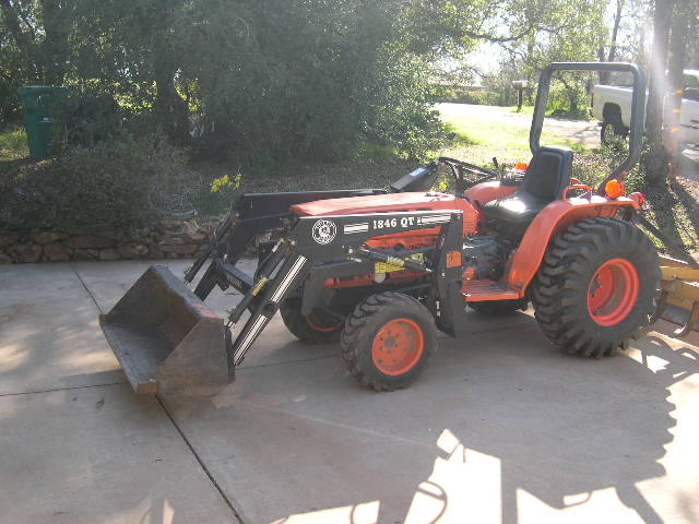

Well, here are pictures of my old Kubota. 19hp, 1985 manufacture, and a Bushhog QT loader. Mine had ROPS, but not PS(was an option though).
Mine was a B8200, which was later replaced by a B2150.
Look on the side of the transmission; that is a common place for the tractor tag. That is where mine was.
My muffler was vertical; I unbolted it and rotated it 90 degrees so it pointed out the front.

Looks just like my B2150, except for the muffler being horizontal, I even have the same loader. The numbers are on your left frame just in front of the seat, just in back of the clutch pedal. I suppose the muffler could have been changed to keep exaust from blowing in your face, but like someone said the loader may interfear. Curious let us know how you make out.:thumbsup:
   / Unknown Kubota #9
Looks like it well taken care of over the decades.

It appears brain 55 may be correct. Upon inspection they saw a number that leads them to believe it is a B7100. There is a number on the engine that is 0213 and another with K2-A. As indicated it has 750 hours, power steering, no ROPS but 4 wheel drive. It has mismatched paint, once painted over for the business that used it. It now has a one year old Bush Hog brand front end loader Model 1845QT, a one year old 3 pt snow blower with skids and a rear 3pt blade. Any ideas on a fair price. I will also ask this on the pricing section.
