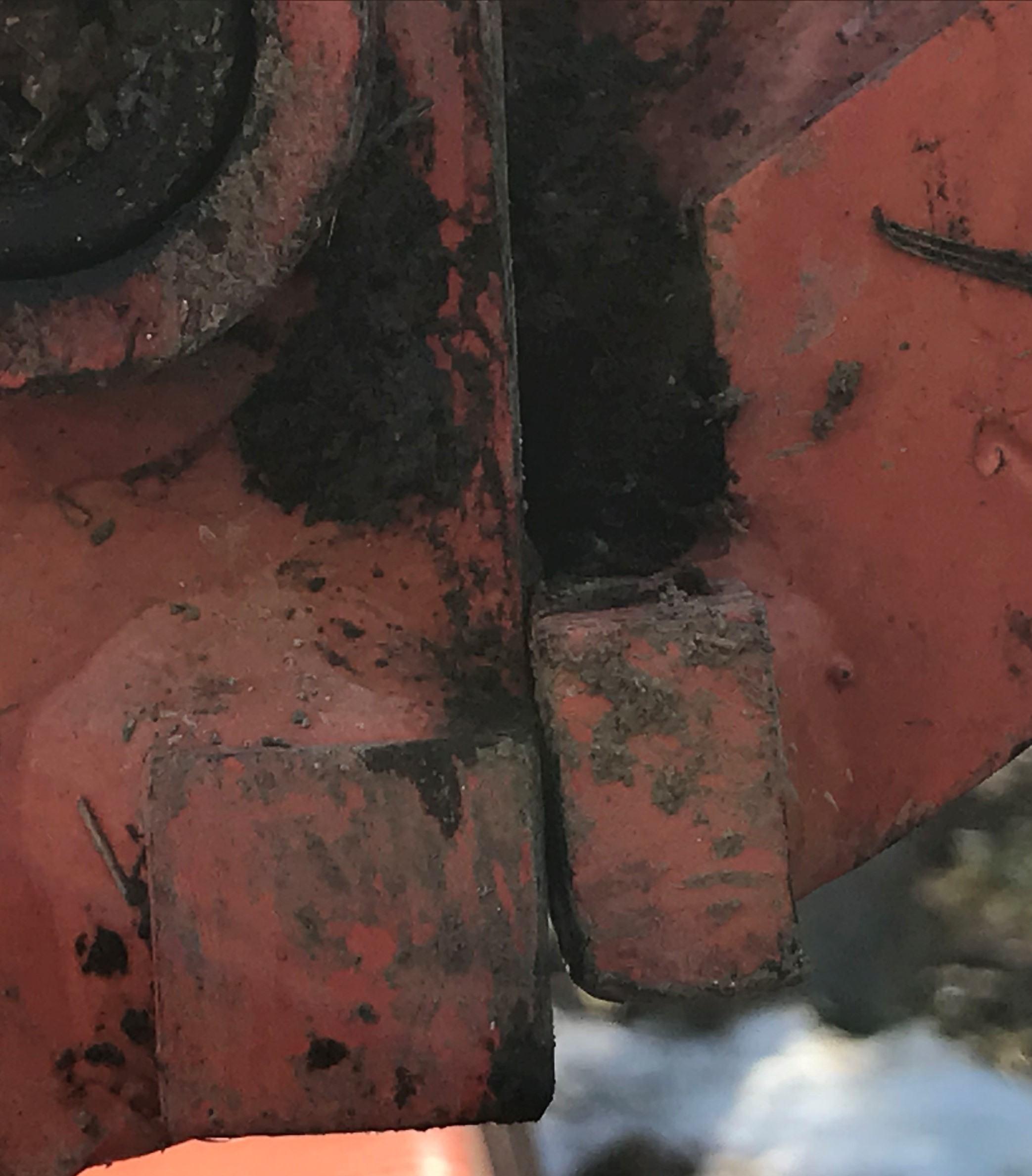

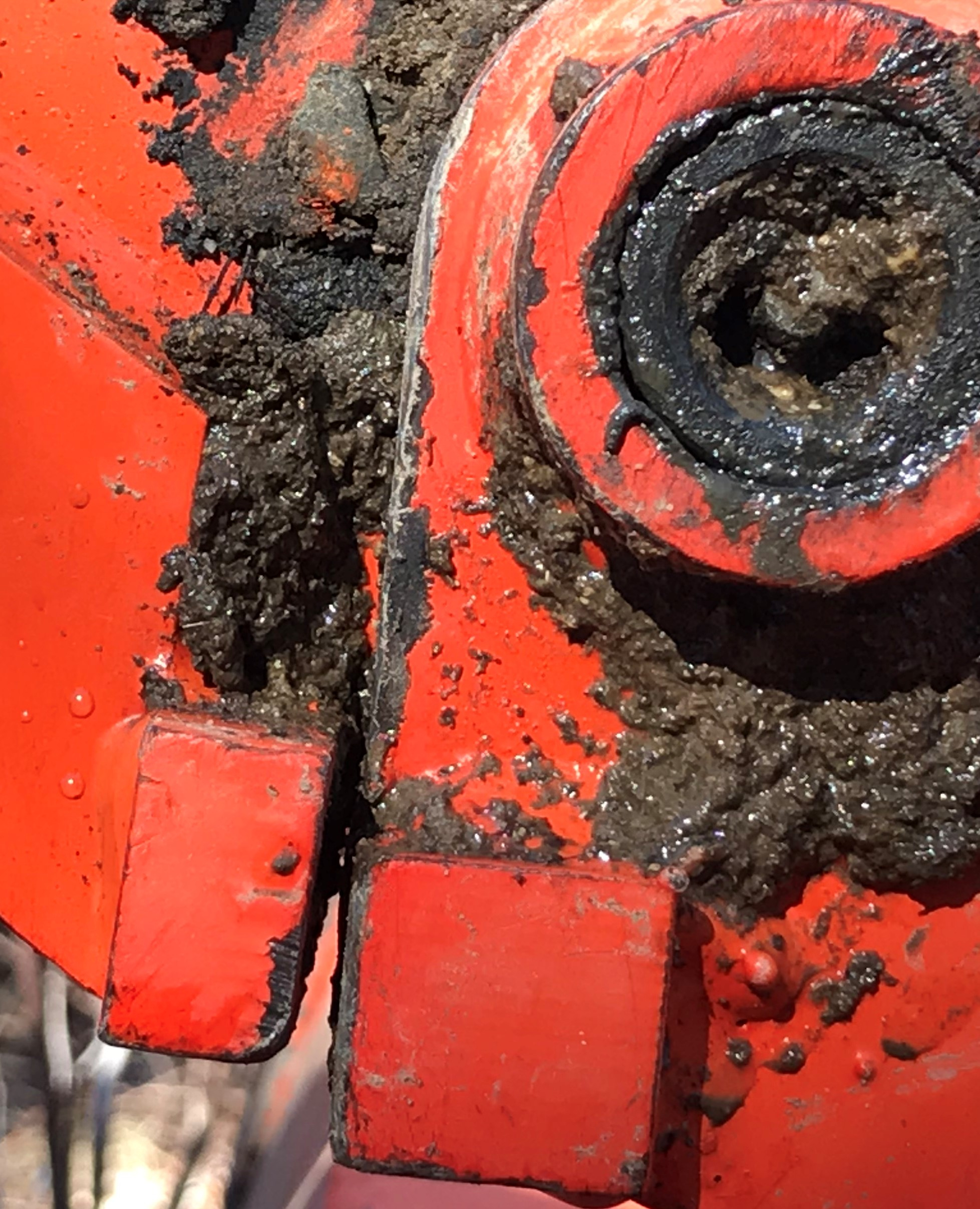

   / Unlevel bucket #5
I have a 2001 New Holland TC25D and my front end loader bucket is unlevel. I don't know if it is a hydraulic problem or a bent shaft. My question is, is there a way to adjust the arms?
Thanks for your help.
Joe
Lift the loader and curl the empty bucket down as far as it will go. Both sides should hit the stops at the same time. If they don't, something isn't right.
