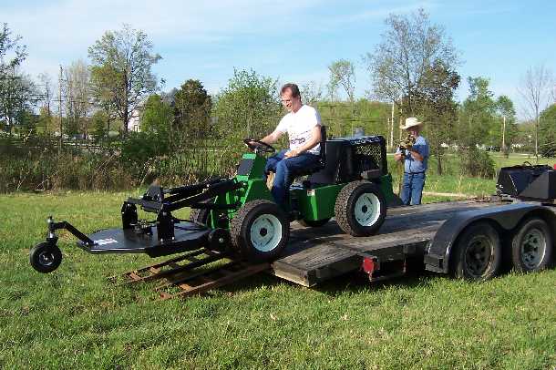

I lived close enough that a private hauler was just as cheap as regular freight and an advantage to that is they came straight to the house.
Here's the lucky new owner driving off of the trailer when it arrived... mower was attached and tiller and bucket on a pallet off to the right. Just dropped the deck and picked up the other two attachments one at a time. Total of 1 to 1.5 minutes even for a newbie! Did I mention I love articulation and quick attach!!! /forums/images/graemlins/grin.gif
