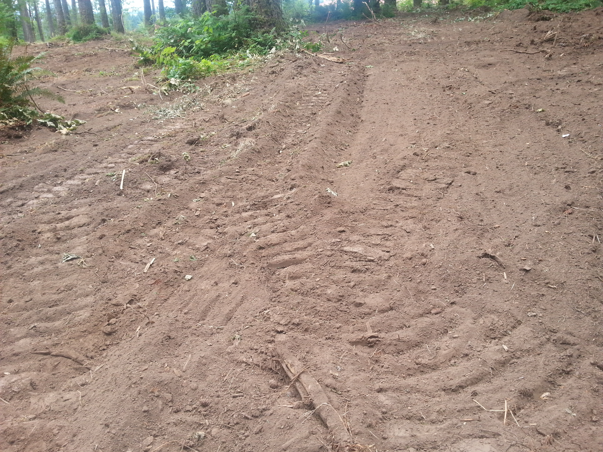

When I was a kid we would pull an unpowered chisel tooth harrow behind the tractor after we plowed and then disced, to smooth out the ground, remove/breakup clods and stones and other debris (grass/etc. would get caught in it) and sometimes pull a section of chain length fence behind the harrow.
I just finished leveling some of my acreage which had ruts and holes from thinning the forest. I also removed a lot of older stumps (from a clear cut 60 years ago). The purpose was to make it easier to mow the underbrush with my flail mower that would get stuck in those holes and ruts.
There is only so much you can do with a dozer and a brush rake (especially since I suck at it, not being a pro) - I removed the big stuff, but even after taking off the rake there are still some areas that need smoothing and there is still a lot of loose debris, especially grass.
I would like to smooth it out more, enough for easier mowing, but I don't need to work the ground for a garden, I just want to get rid of the dozer artifacts and it is 4 acres so I don't want or need to use a power harrow IMO. I want to pull something behind my 2 wheel tractor. I could rig something up with a section of chain link fence, but is there an unpowered rake/harrow I can get?

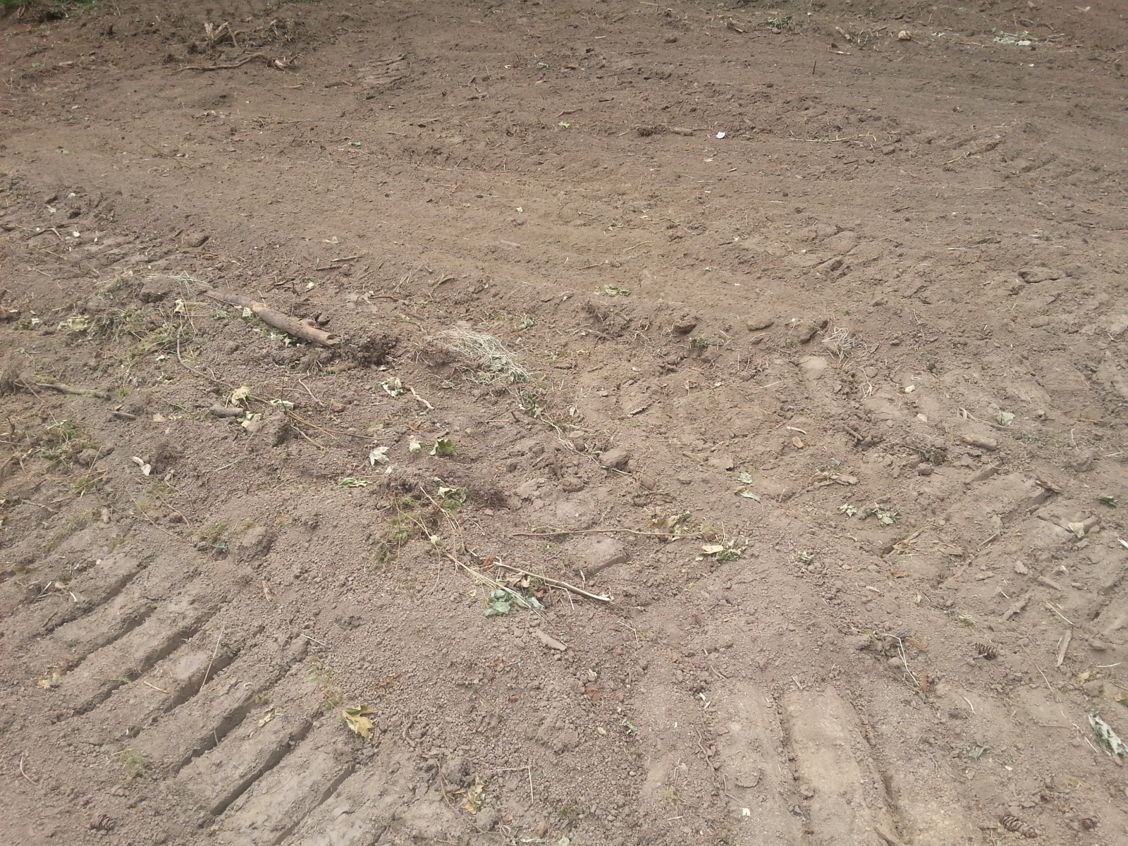

Maybe a few pics will help:
Just ordered a drag harrow.

Pulling it around with my 4x4 now. It is doing an okay job, but it is hard to get into some areas - the 4x4 is a supercab with a long bed. A 4x4 ATV would be about right - tempted but I think I will try the tracks on the Grillo first.
The harrow works for small irregularities, but the big stuff not so much. Neighbor said he could do those with his land scraper on his Kubota - I will take him up on it.

I spent most of Saturday pulling the harrow around behind my Toyota and had good success with that. I would say I got about 70% of the area smoothed out enough to mow much more easily. I need to go around and pickup a lot of wood debris though. Filled up the 6x4 bed on my Toyota Saturday and there is a lot more - getting rid of the debris - some of it buried, will help mowing too.
But there are areas I won't be able to get into with the truck. I may be able to get my neighbor to go over some areas with his scraper behind his Kubota, but I am thinking I need those tracks for the tractor.
