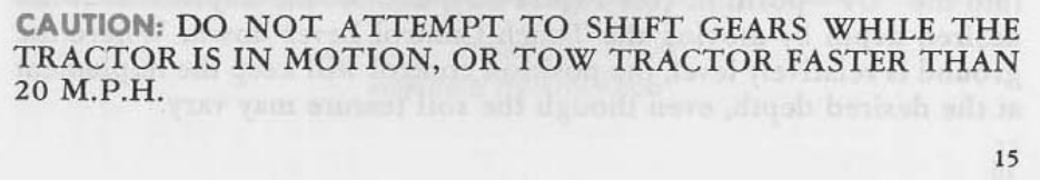

As you have seen, it can be done, but Ford Tractor recommended you not do it. That's because, in gaining the experience mentioned above, you may lock the transmission in two gears or break something expensive. This is straight from the owner's manual:
You can download a free owner's manual from here:
https://www.ntractorclub.com/manuals/tractors/Ford Tractor Series 600 & 800 Owner's Manual.pdf
