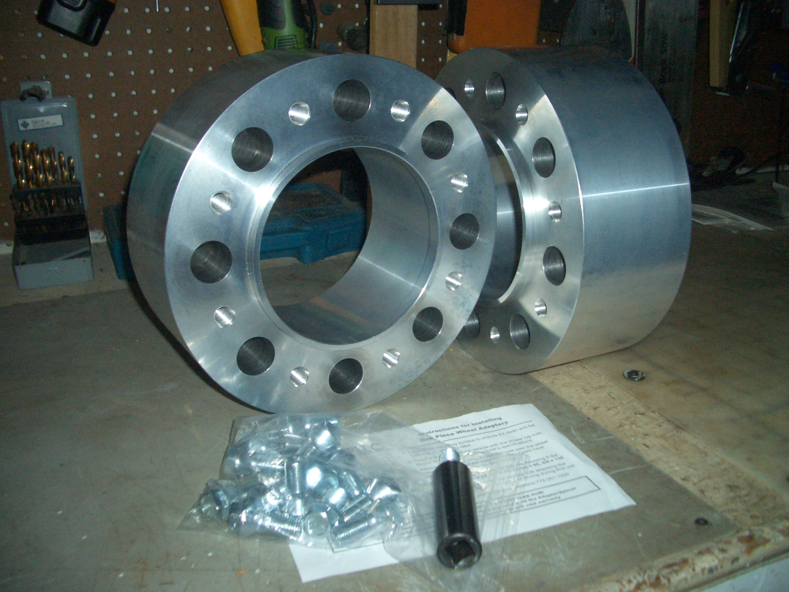

It it helps, I just ordered a pair of 4" machined aluminum spacers from Moto-Sport. Lighter, and no rust potential. Imagine this one with threaded holes instead of bolts. That way I can use the OE John Deere lug bolts. Including 16 mounting bolts, I was billed $535 (delivered).
Hopefully they're in the mail. If so, I can snap a photo before they're installed.

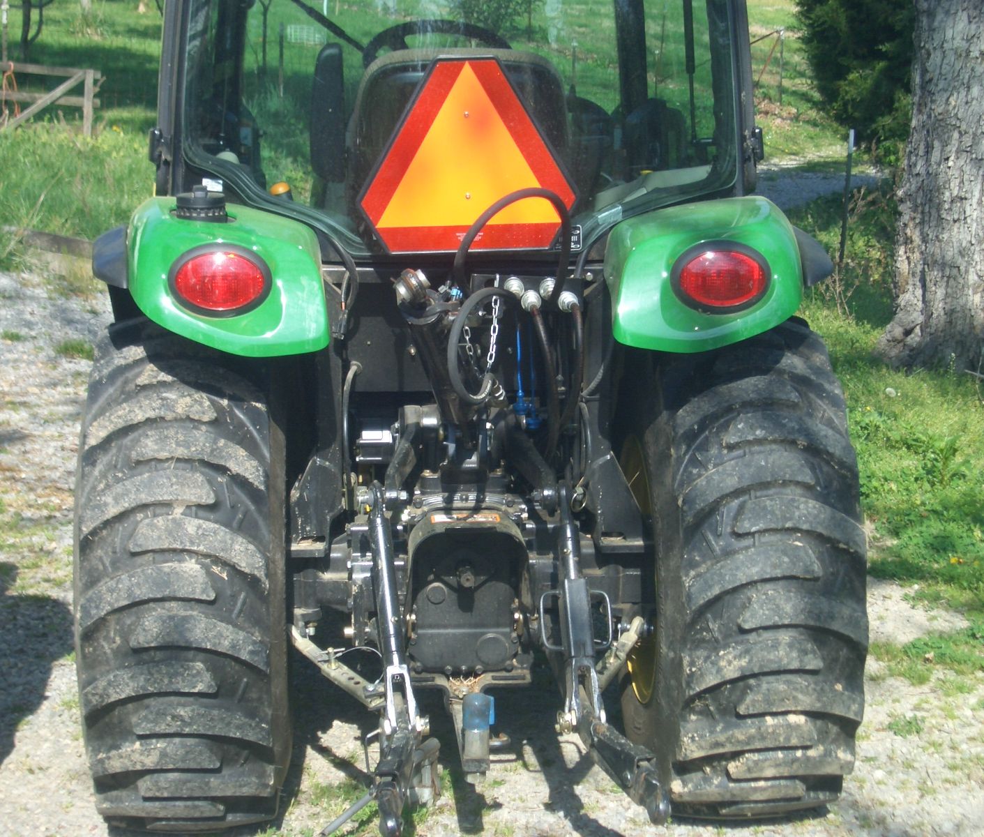

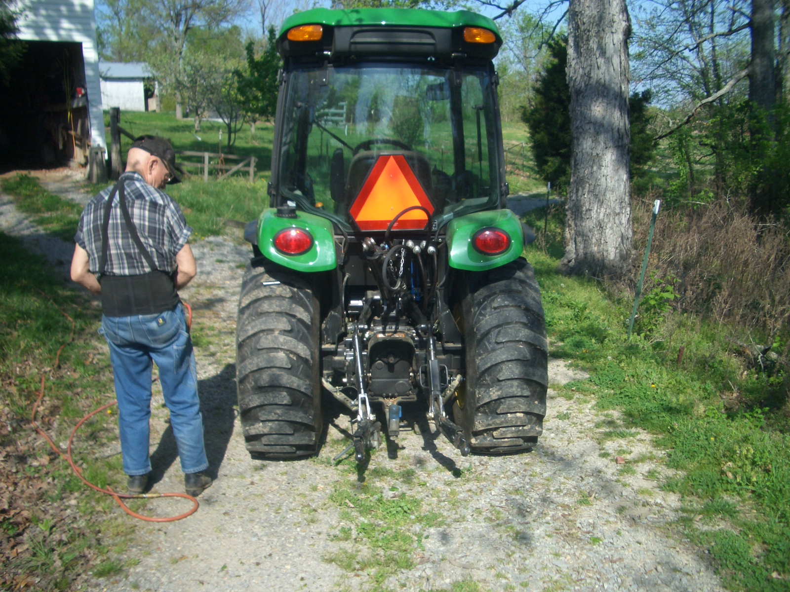

Here's the follow-up. It's absolutely amazing the difference 8 inches can make to the stability of this little cab tractor. At the max R4 width of <60" I considered it dangerous. But I took the new wide stance back out to some of those locations on my property that put me up on 3 wheels before, and it's absolutely stable. No pucker factor whatsoever. $505 plus $30 delivery might sound like a lot of money, but for me it's a cheap price to put on peace of mind.
I added the 4th photo - another "before" view - to demonstrate the basic problem. Tractor - as built by John Deere - is roughtly 50% taller than its design R4 operating width. High center of gravity issue. From my perspective, widening the stance lowered the center of gravity.

Don't know anything about Unvenferth, except that they're expensive. Mine are machined by an outfit that started out making spacers for cars/trucks/ATVs/UTVs. They recently expanded the line to include some compact tractors. You can see their stuff here. Type John Deere into the search box to narrow the selection. I contacted the head machinist by phone to arrange for mine to have lug bolt holes instead of spacer studs. The $505 price included 16 tapered lug bolts to attach the spacer to the tractor hub. I then used the OE lug bolts to fasten the wheel to the spacer

16 tapered lug bolts with the correct thread were included in the purchase price of the spacers. See my photographs. The unthreaded holes in the spacer had the correct taper machined in as well. I used the provided tapered lug bolts to fasten the spacers to the hubs, then used the OE tapered lug bolts to fasten the rim to the spacer. Note also in the photo that the spacer has the correct lip for rim. Not visible is the fact that the back side of the spacer as a machined recess into which the tractor hub fits (similar to the way it fits through the rim).
And yes, it's definitely safer. If my numbers are correct, 8" of additional width lowered the center of gravity by >13%. Originally it was 1.5 times taller than it was wide. Now it's only 1.3 times taller than it is wide. I make that out to be a 13.33% reduction.
