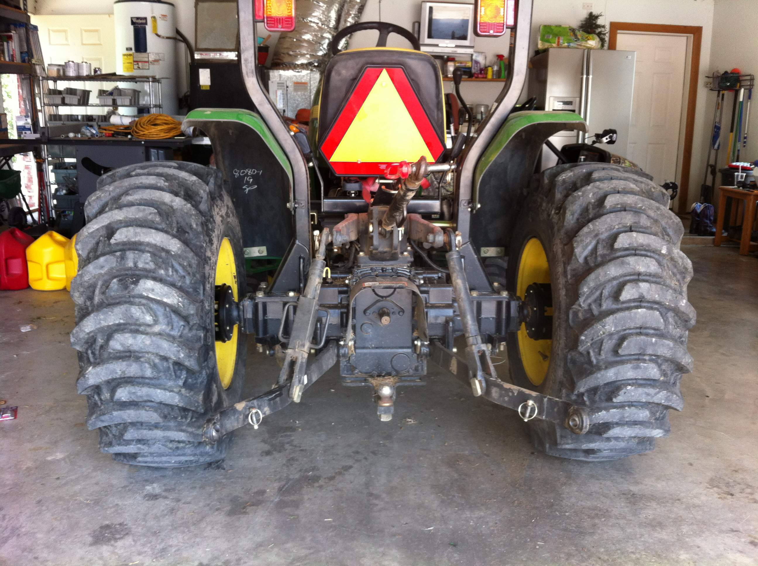

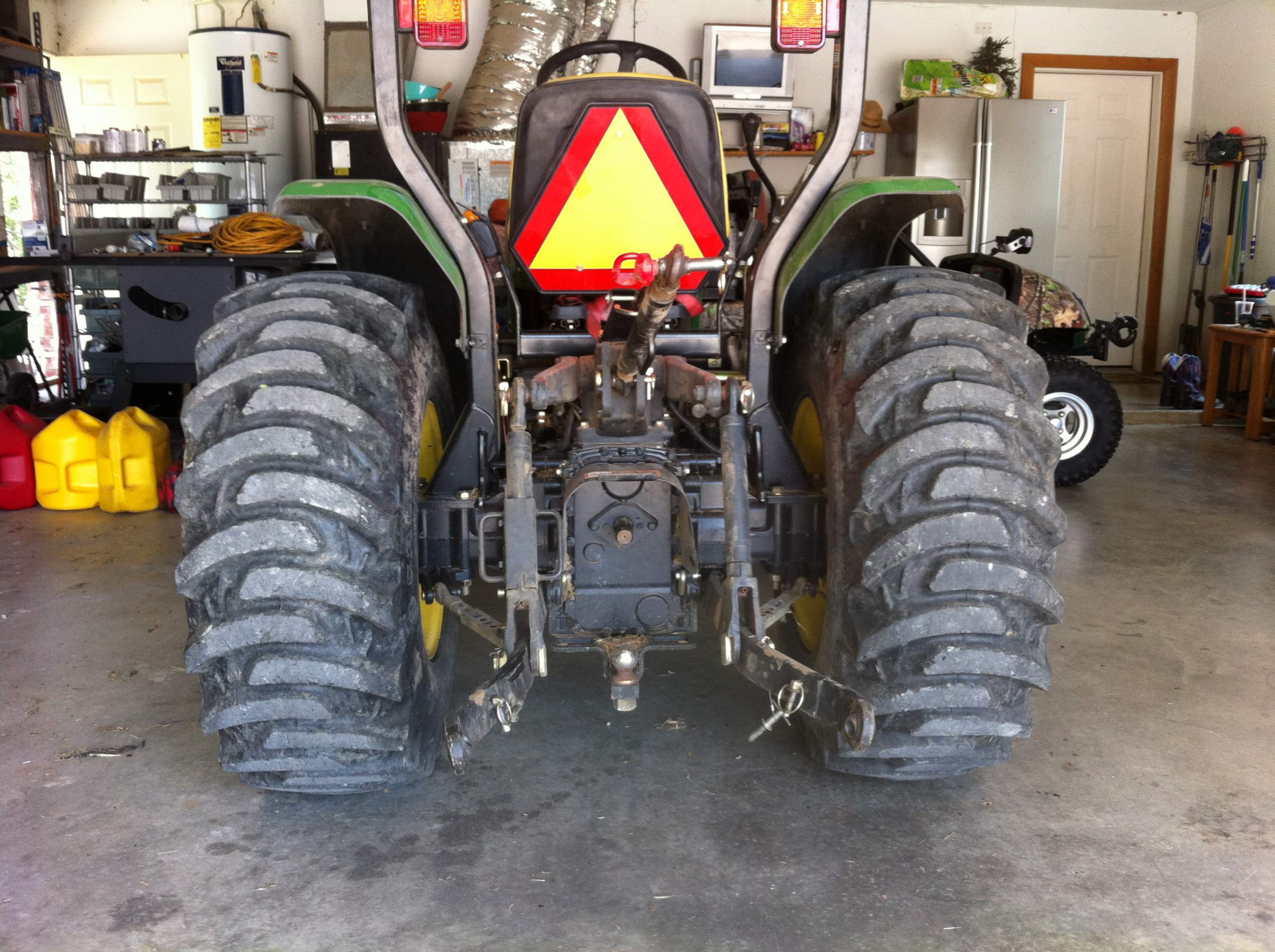

Well, I've had my JD 3203 on 3 wheels quite a few times, and finally bit the bullet.

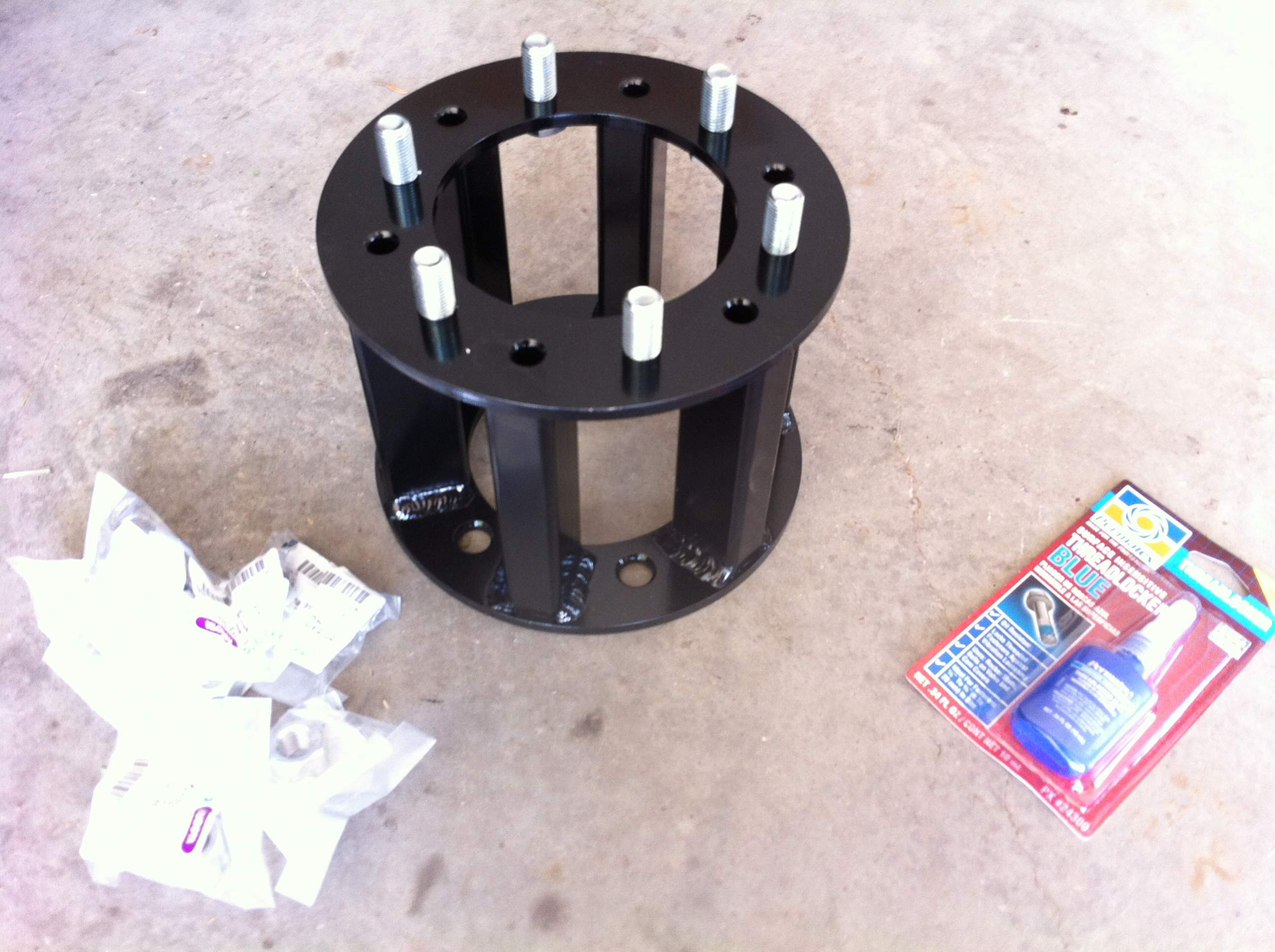

I picked up a set of 6" spacers from Kubota John Deere Compact Tractor Utility Vehicle Wheel Spacers
It took around 5 weeks or so to get them, but I was told this up front.
Christian was very easy to deal with. He also provided updates throughout the process.
They came in the mail today, and didn't take long to install. The welds are great. Paint is very nice as well. Great product!
The insides of the wheel are now lined up with each other with both front and back wheels set to the wide position. Going to try it like this for a while, but may flip the rears to the narrow position. Have to see how it does on the trails.
Took a ride across one of my hills and there is a huge difference in stability.
Makes the center of gravity feel much lower.
I would highly recommend to anyone with hills.
