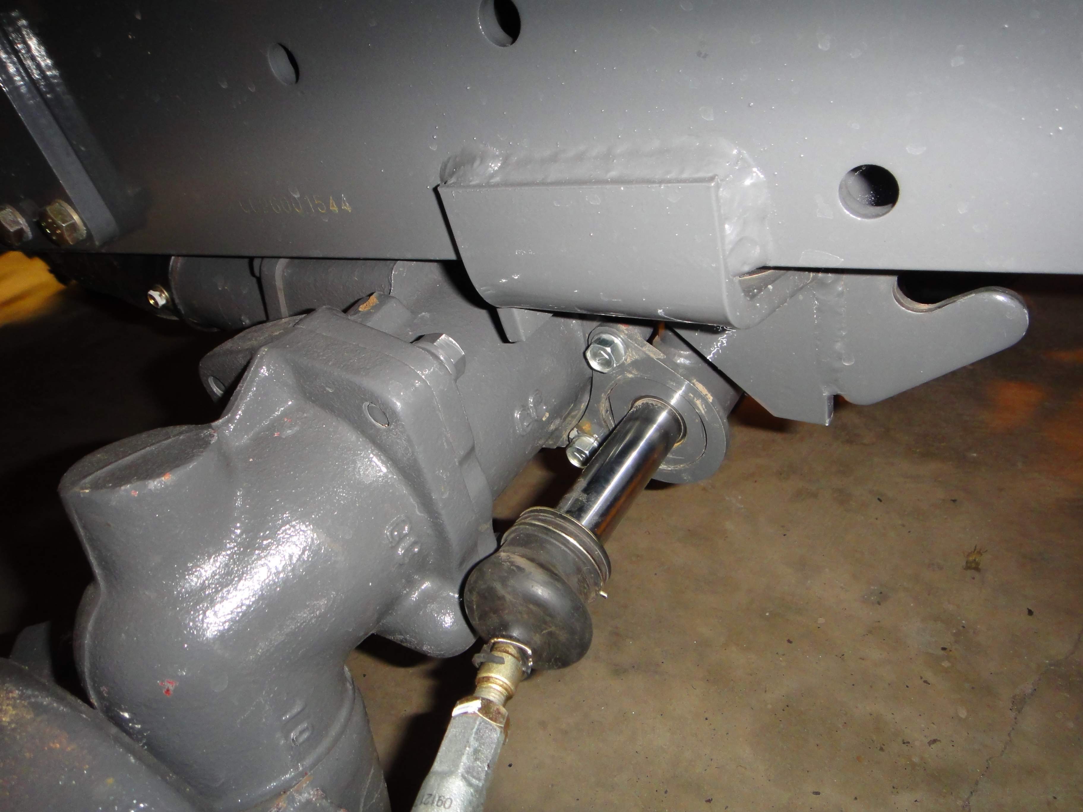

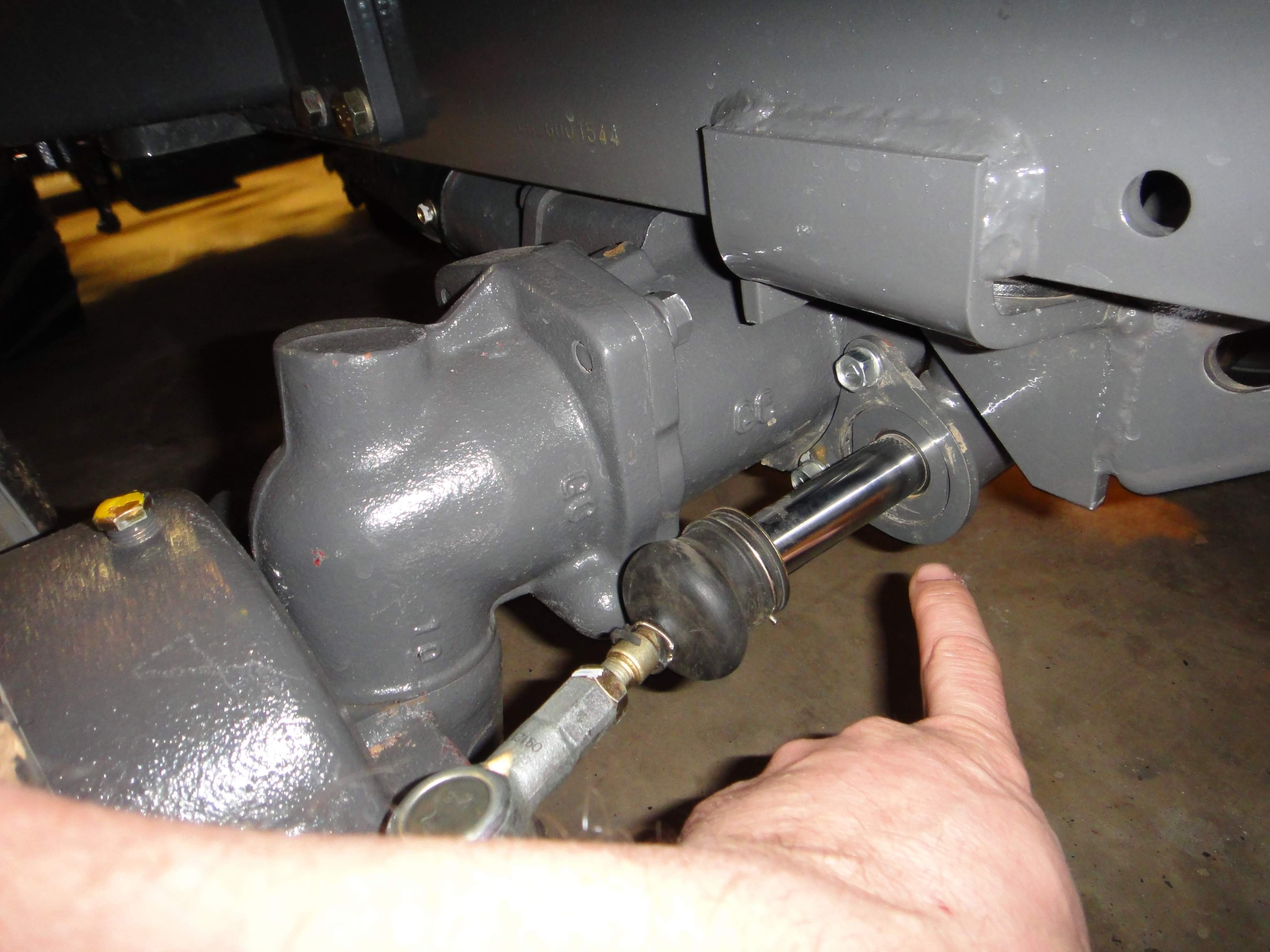

   / Update campaign FC6192 Steering cylinder mount #17
Looking at mine both sides of the brackets look the same. I can't see a difference in the outside or inside of the bracket ? Are the pic's posted a before or after shot , or correct or not ??
#18
Those pics are after the correction. If you look at your machine from the front, you will notice that the left side of the cylinder looks slightly down from the right, if it needs taken off an turned over.

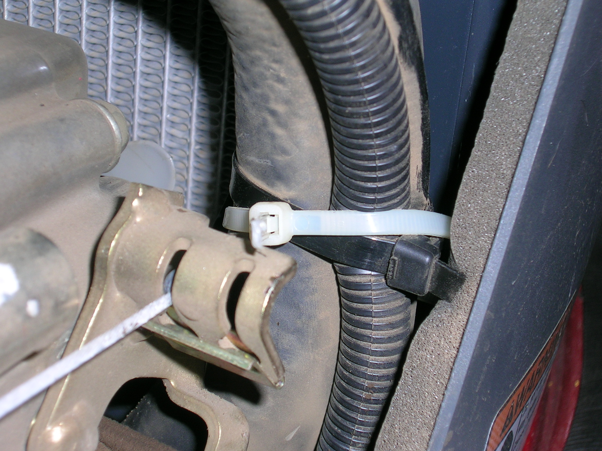

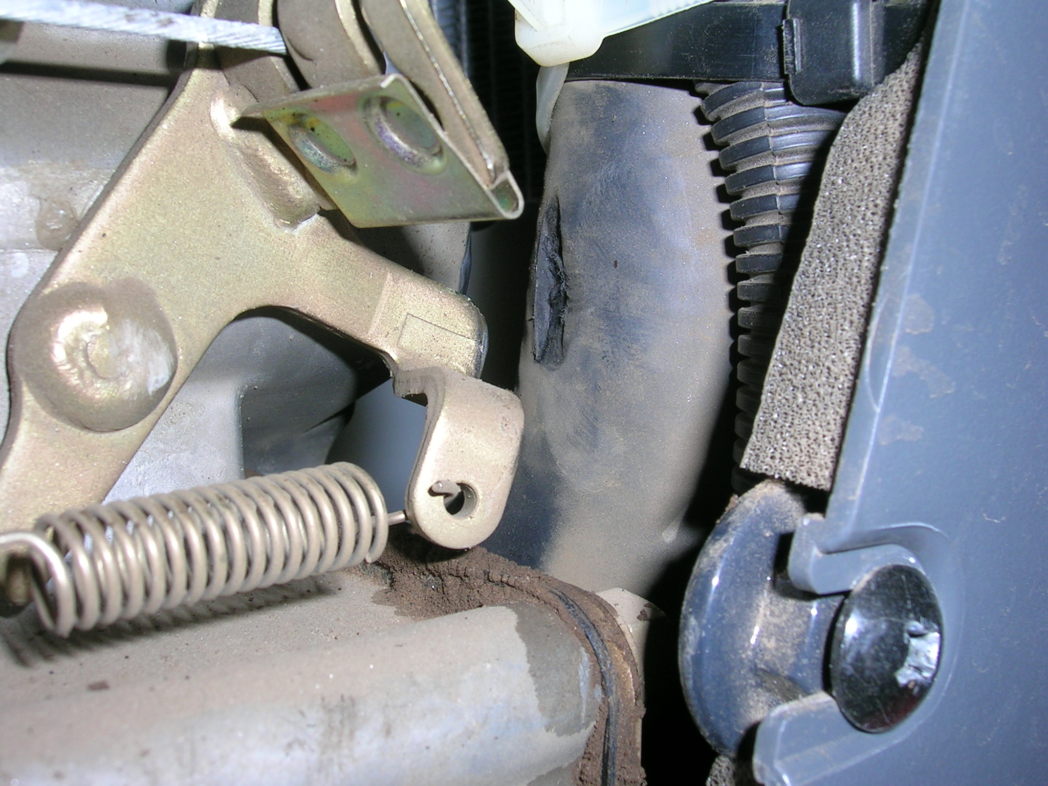

My steering brackets are OK, but I have the lower radiator hose run issue. I have about 135hrs. Here is a pic of the damaged hose and a pic of the tieback job I did with the white zip tie. This hose will need replacement and the zip tie is temporary until the correct update can be done.
Actually, that IS the update. They zip-tie the hose like you did, but they run the zip-tie through a clear tube. I guess to keep the tie from rubbing through the hose??
