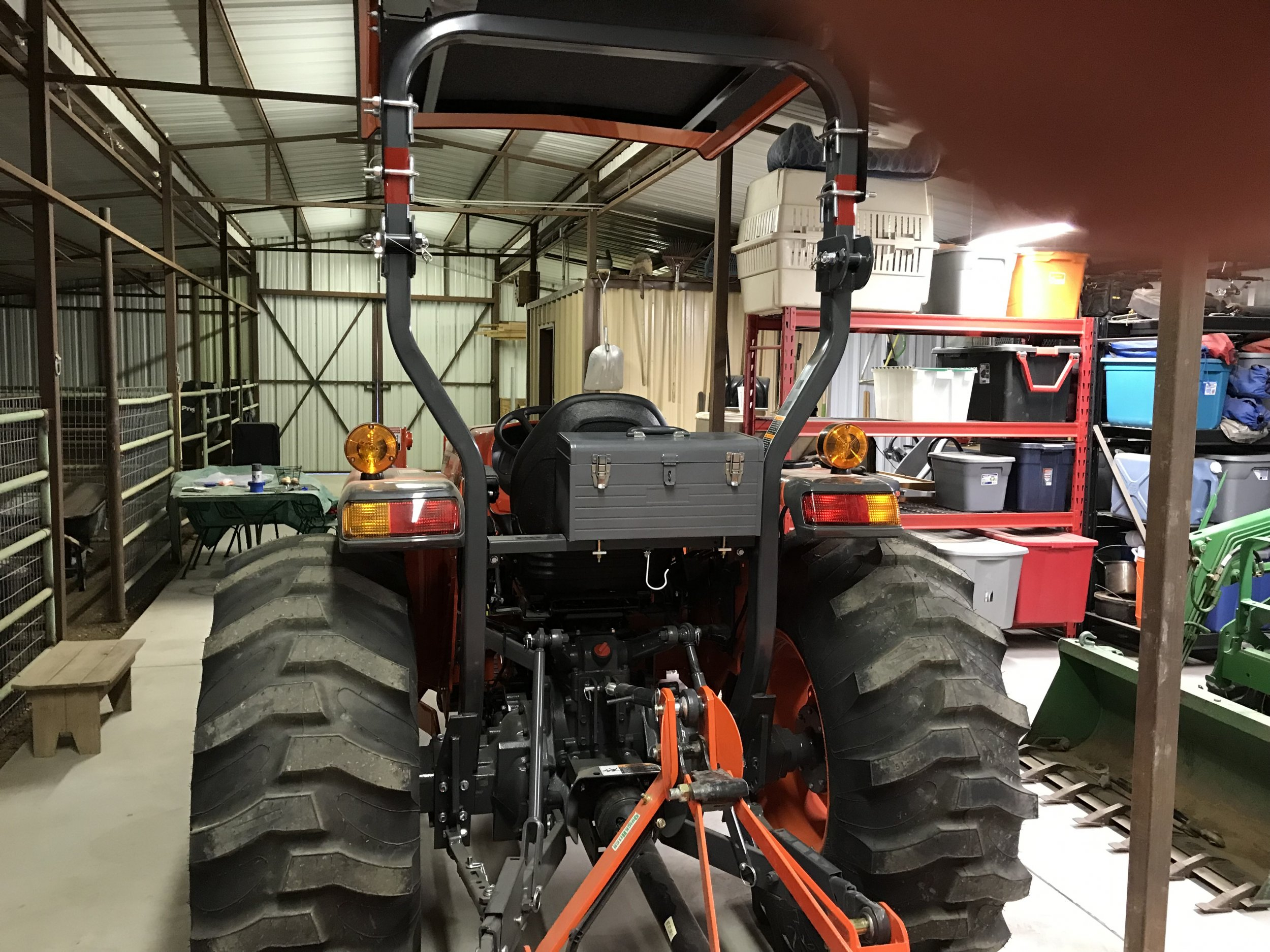

I bought a USB charger on Amazon for $12 and installed it. But make sure that you connect to a circuit that is only hot when the ignition is on. Otherwise it will drain your battery. For my phone, I bought a small clip case that works well connected to the rops or seat. For fueling, buy a small pump with a hose to attach to your can and forget about lifting and spilling. Or a fuel caddy with a hose. For a toolbox, see my photo.
