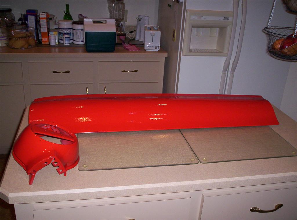

Tractor's looking great. What kind of primer/top coat are you using? I'm working on a couple of trucks that will need painting. I probably will use a body shop for the cabs but I may paint the frames myself.
/ update on the 951
#22
For primer I'm using valspar heavy duty / high solids oil based metal primer.
For a top coat I'm using the valspar BPS tractor paint. I'm sure it is an alkyd or at most, and acrilic modified enamil, depending on what version of their paint you get.

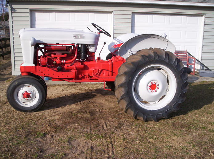

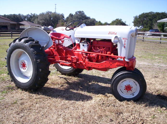

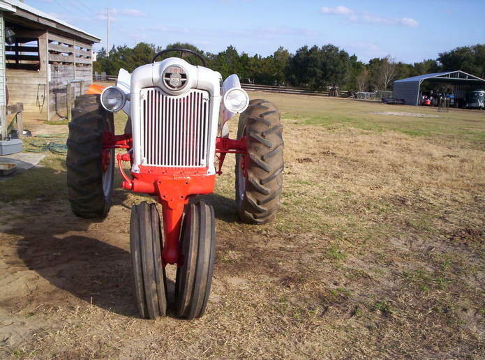

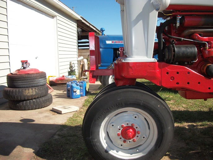

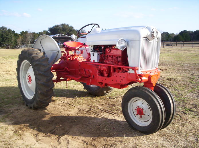

/ update on the 951 #23
Soundguy said:
Some near finished shots... still have plenty of work left.. plus more sheet metal
soundguy

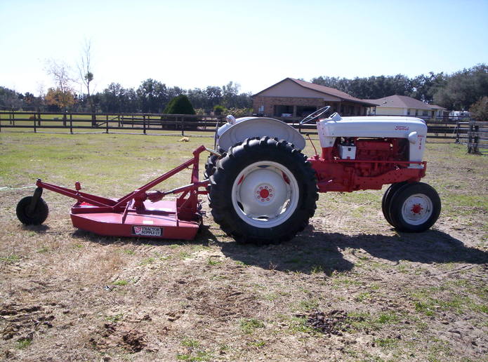

SG: that's one handsome 951. You really hustle on these refurbs.

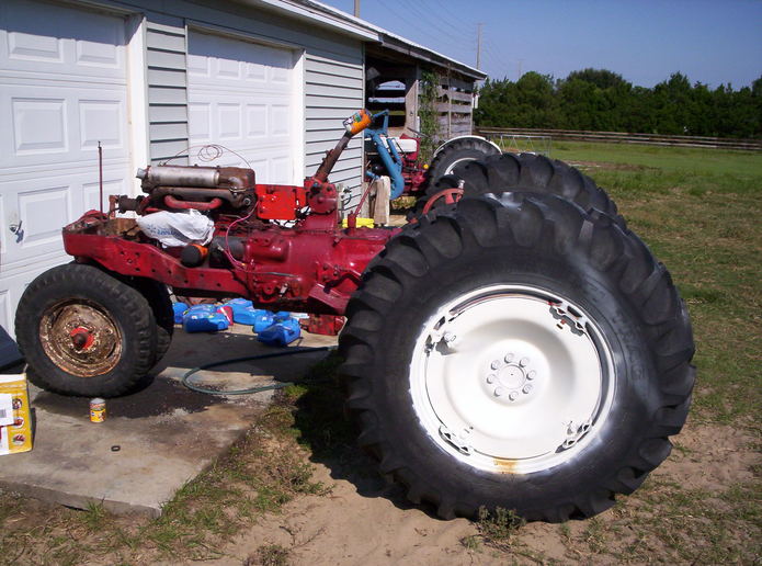

Soundguy--I realize this is a three year old thread but I'm on a similar quest to find and (hopefully minimally) refurbish a 941, 951 or 961 Ford. Wide end for me, however.
Are there any pointers you learned in the rebuild process that might be helpful or any advice to offer about that series tractor? Also, any finished photos with the decals on it?
Any advice or info appreciated.
/ update on the 951
#29

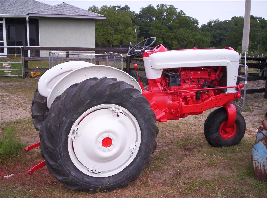

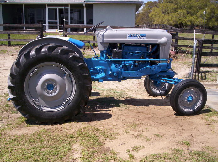

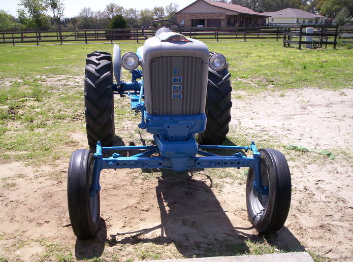

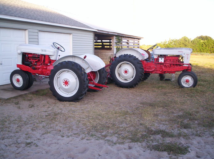

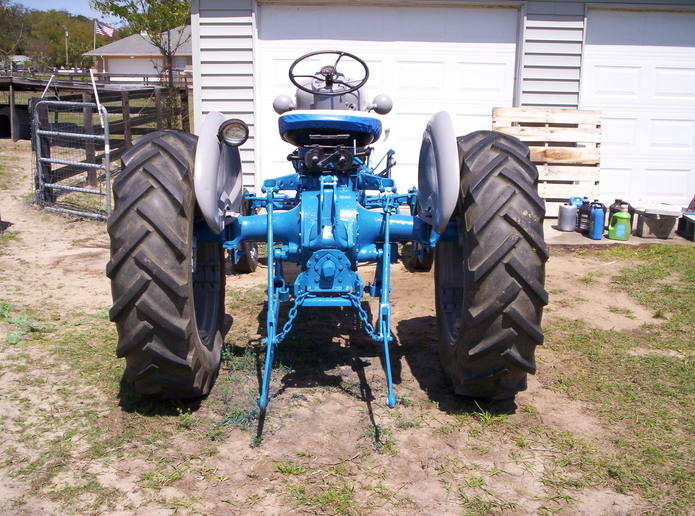

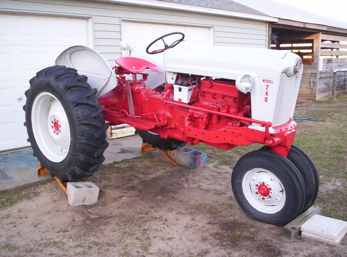

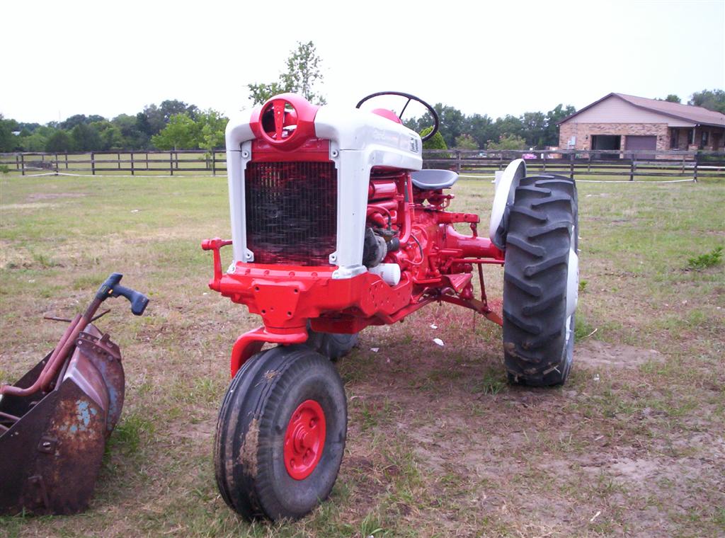

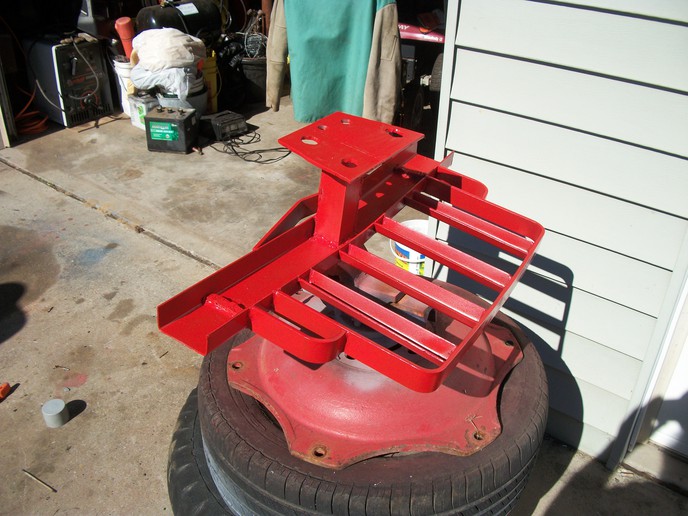

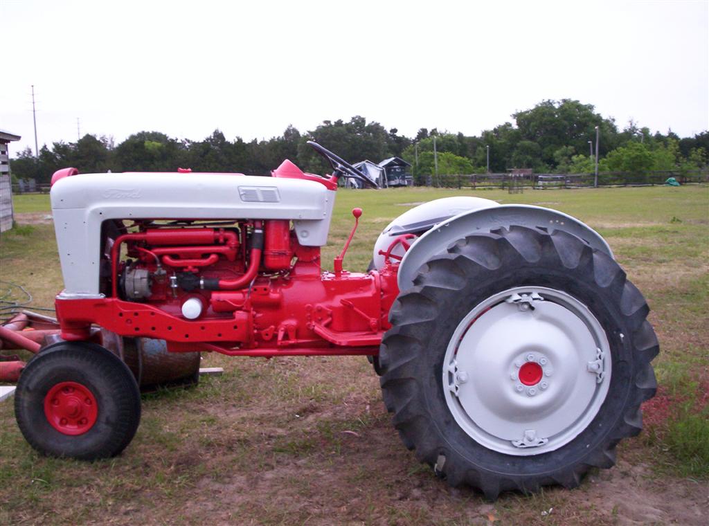

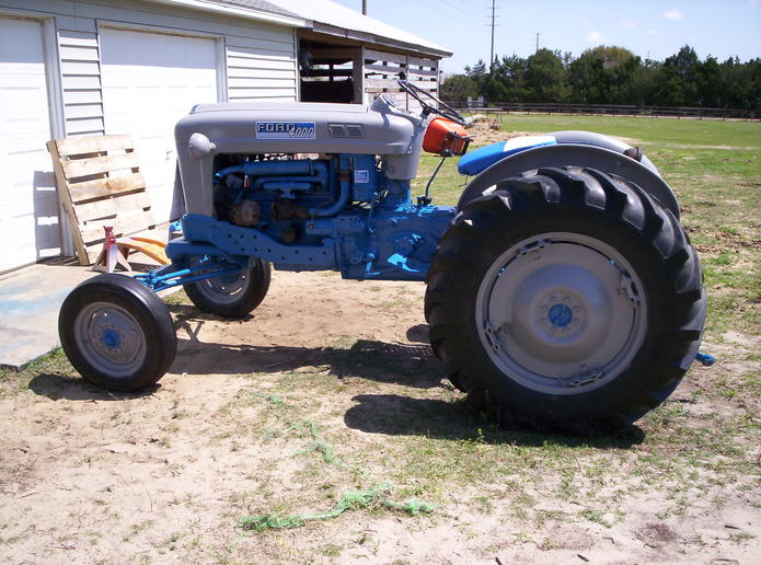

since that last posting I've probably done a half dozen more rowcrops.. :) wide front ends and narrow fronts, dual wheel and single wheel.
i can post some pics of a 4000 I did with ford factory wide front to gige you an idea of what it looks like. I also did a 950 narrow front and a 740 narrow front.
if you have any specific questions, ask em.. probbaly easier to answer specific, than talk in general.

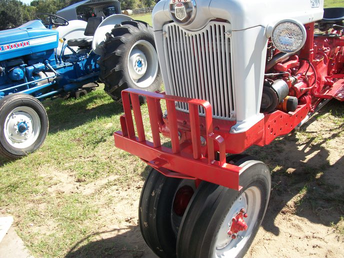

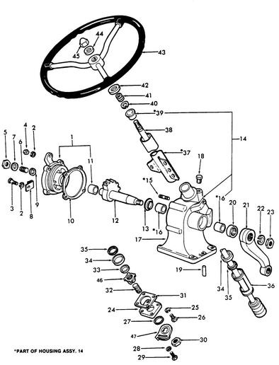

I will say that if you have play in the steering box at the op platform.. get it all adjusted and worked on before putting the tin back on and air cleaner and battery box, etc.. as the row crop steering box at the op platform ( there is a sterring box int he front pedistal too ), is very different from the ag model. it actually has an external thrust bearing adjustment for one thing.. but to get at it.. the bat/tray is in the way.. :)
I find the extra height on the row crops makes them easier to work on, for me anyway. with frame rails you have more to support hem with if you work on the front end..e tc..
also.. just the regular stuff.. make sure you have the fuel system in order, and resist the urge to go to a rubber line for fuel near the manifold.. .. brake line is easy to bend up and cheap.. etc.

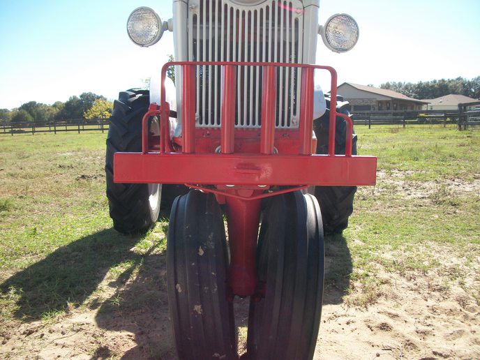

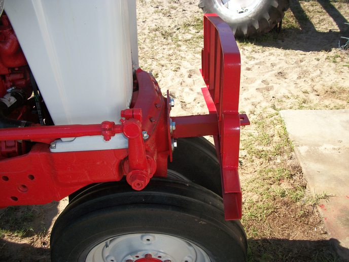

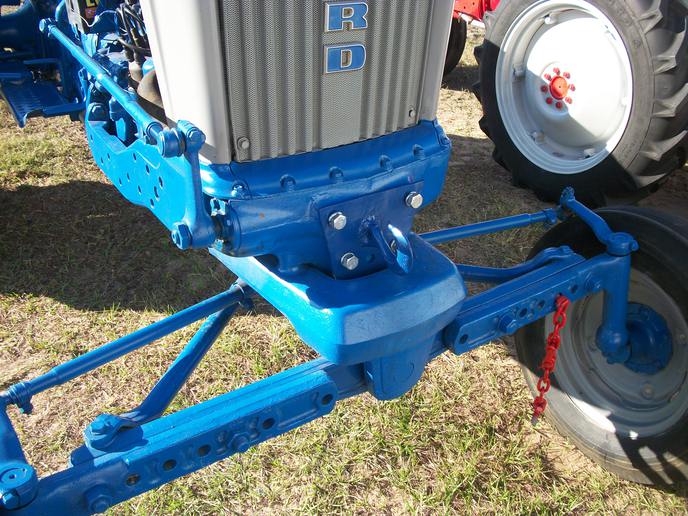

here are a bunch of pics. i do reccomend a bumper.. I made one from a repop ag model bumper, and welded a mount palte on it to mount to the front bolt pattern on the pedistal.. ther eis an oil drain plug on the bedistal.. so leave an access hole for it. also.. the drain plug will be an inverted plug usually.. i hate em and convert to a square headed plug... otherwise once they wear.. they are hard to remove.
ditto on thelil plugs on the rear drop box oil pans on the bull gears.. save yerself some grief and go with new plugs.. and put thread goop on them so you don't have to overtightent hem to stop leaks... saves hassel next time you service them.
ask any question ya got.. if I know the answer I'll post it.. :)

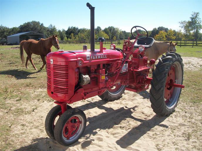

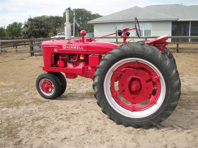

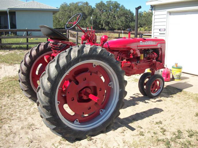

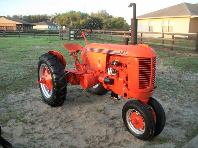

yeah, a few of them have remotes... various.. some have tisco dual ports.. one is an aico dual.. one is some ? unknown single.. and I know for sure my 951 has a selec trol valve on it..
rowcrop trikes are my favorite. (ford especially )

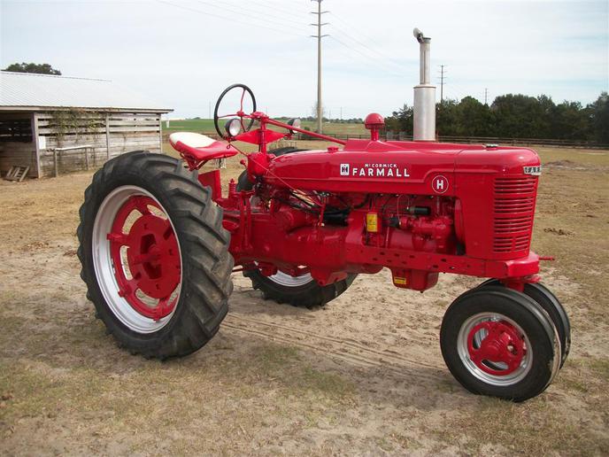

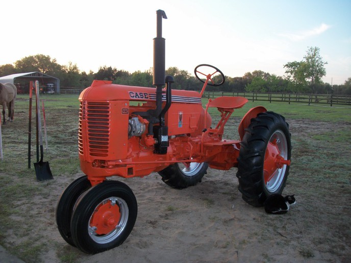

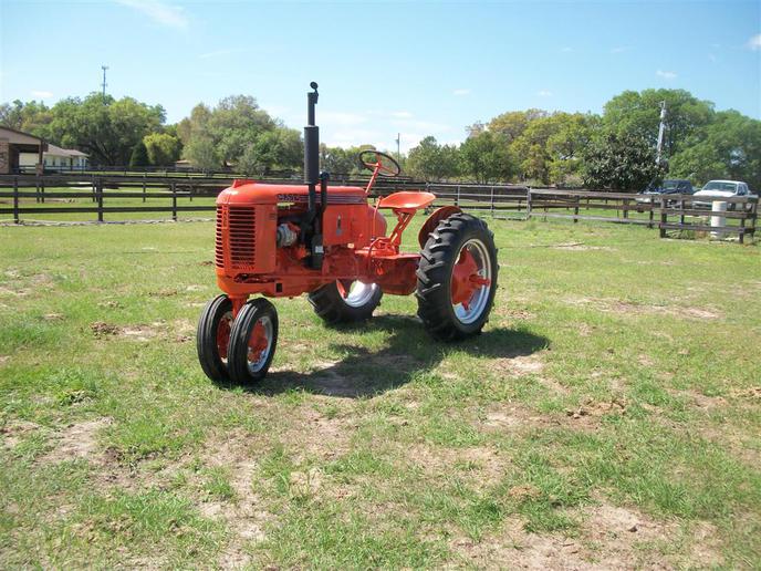

here are some other flavors I have.. did these last summer and winter :) a case VAC.. 49 I think.. a farmall C a 48, and a 44 farmall H
