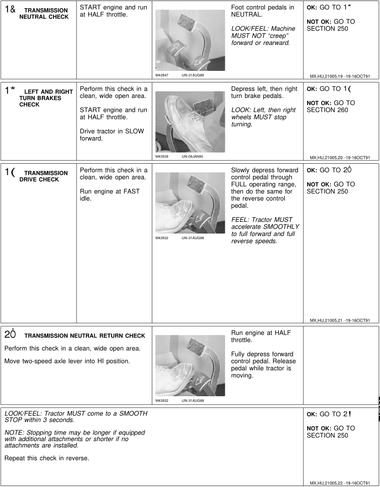

Still more issues to tackle. I hope these are minor, and just the result of needing a little adjustment. The worst issue i still have that i am aware of is hydrostatic creep. Fortunately, my park brake works very well. But my machine will always creep forward or reverse, depending on where the pedals are. They never seem to return all the way to "zero". I have checked all linkage, and lubricated all points. I even tightened the return spring, but still no luck. I am a bit reluctant to go moving/adjusting settings because everything does work; it just creeps a bit. Is there a procedure somewhere that illustrates how to set/reset linkages? I have not found one in my searches, and the manual is not very helpful.

Can't remember which you have? Operator manual and/or service manual TM1360 has the Machine Operation Checkout procedure, lists reasons if some operation is not correct and the remedy. Operator manual has "Driving/operating the tractor" levers etc, section.
Search TM1360, first search item, Golftech.us link has pdf service manual FREE

That's got to be one of the biggest piles of horse crap I've ever heard. The mechanic obviously know nothing about the 755. The drive shaft is bolted solid to the flywheel, so you could polish the darn thing and still wouldn't do any good. The creeping has to do with the linkage to the swash-plate being out of adjustment or worn and sloppy. Proper control of the swash plate will control the creeping.
