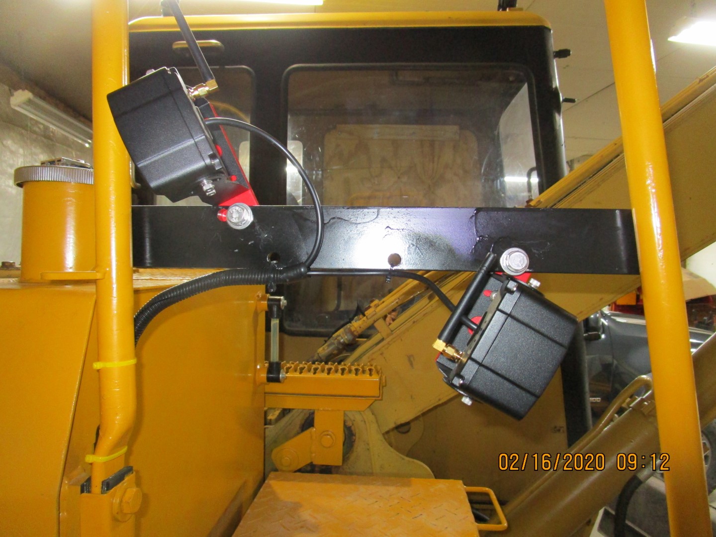

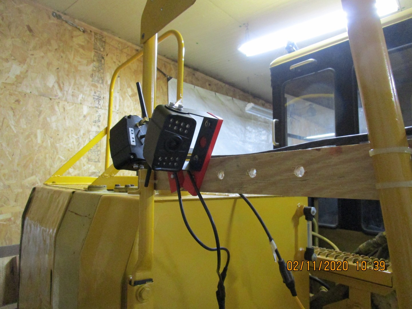

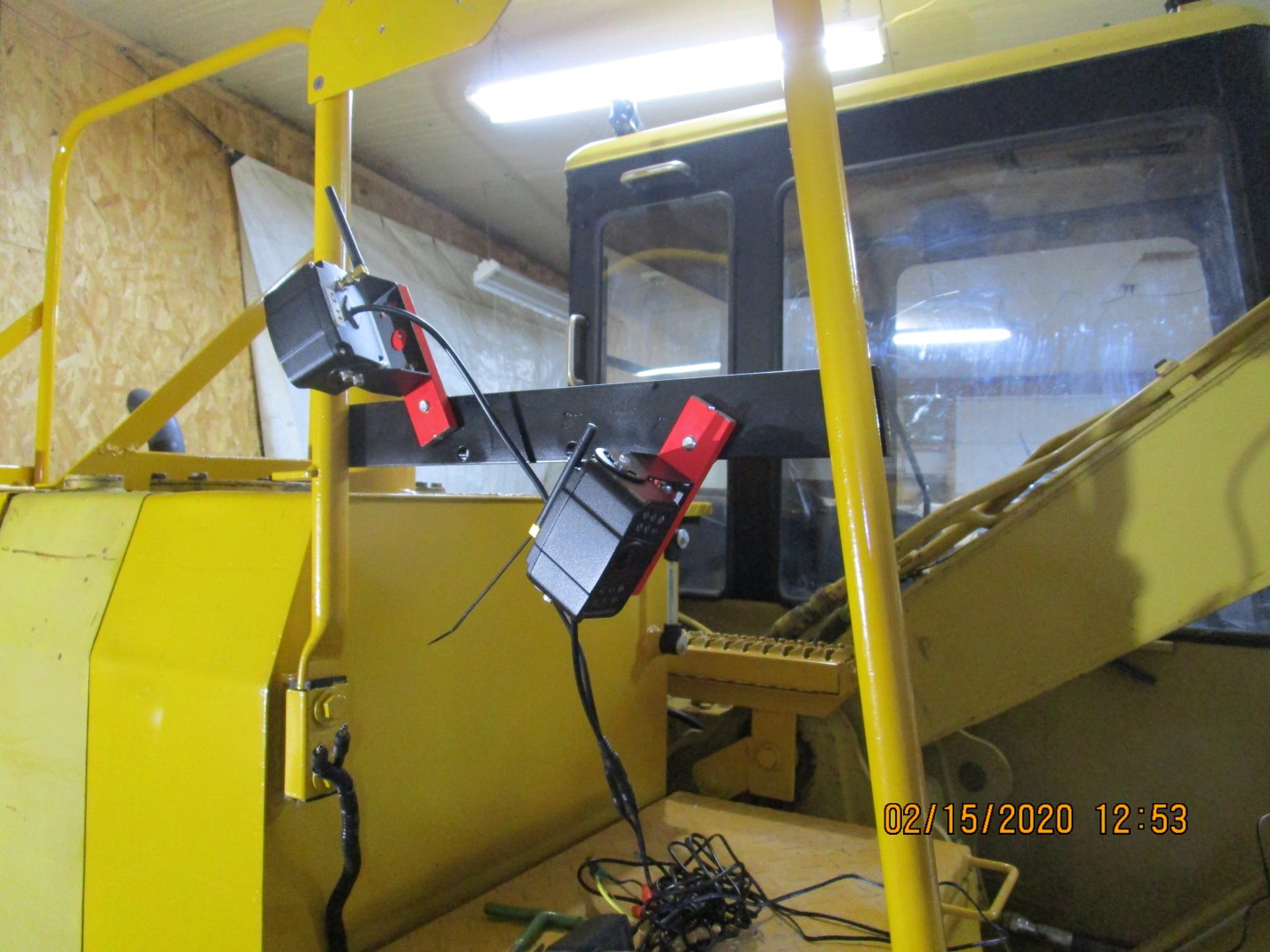

In the process of replacing my old 720P wireless cameras with a new 1080p HD system. Just hay wired with prelim brackets to hold the cameras. Cameras are on the pricey side, but the new versions also seem to have zero interference/noise on the pictures. Really a noticeably clearer picture. Good winter project since I am stuck inside the barn.... Plate on the handrail above the new cameras is where the old 720 cameras were mounted, will come off soon.
Amazon.com: FHD 18P Digital Wireless Dual Backup Camera 7'' DVR Monitor Kit Split Screen for Trailer/RV/Truck/Camper Rear/Side/Front View Camera Night Vision IP69K Waterproof Driving/Reversing Use: Car Electronics

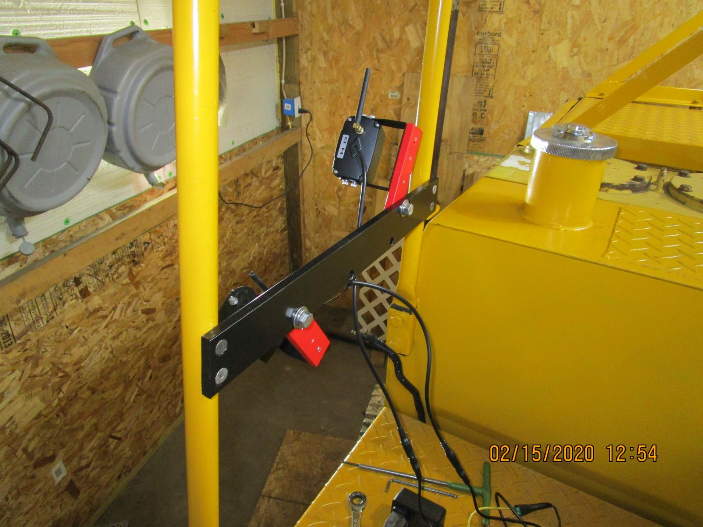

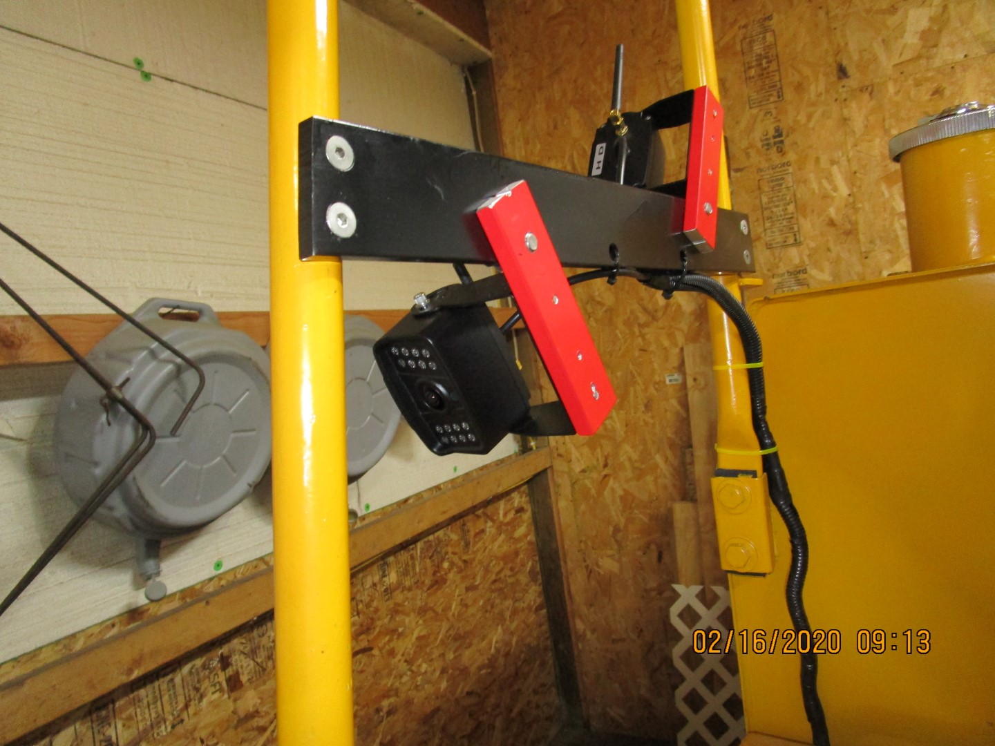

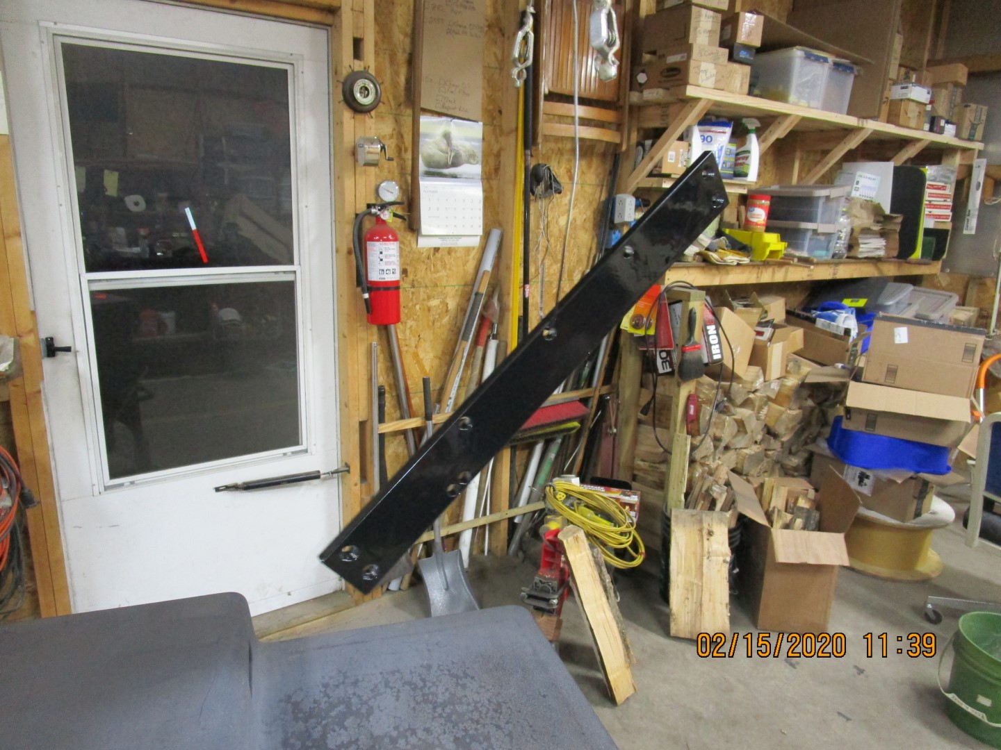

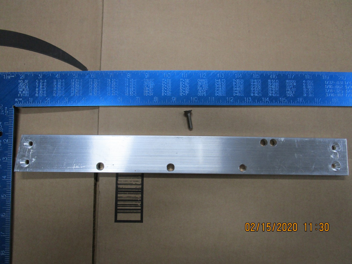

Made/installed a bar to mount the cameras on this morning. Just need to do the wiring.

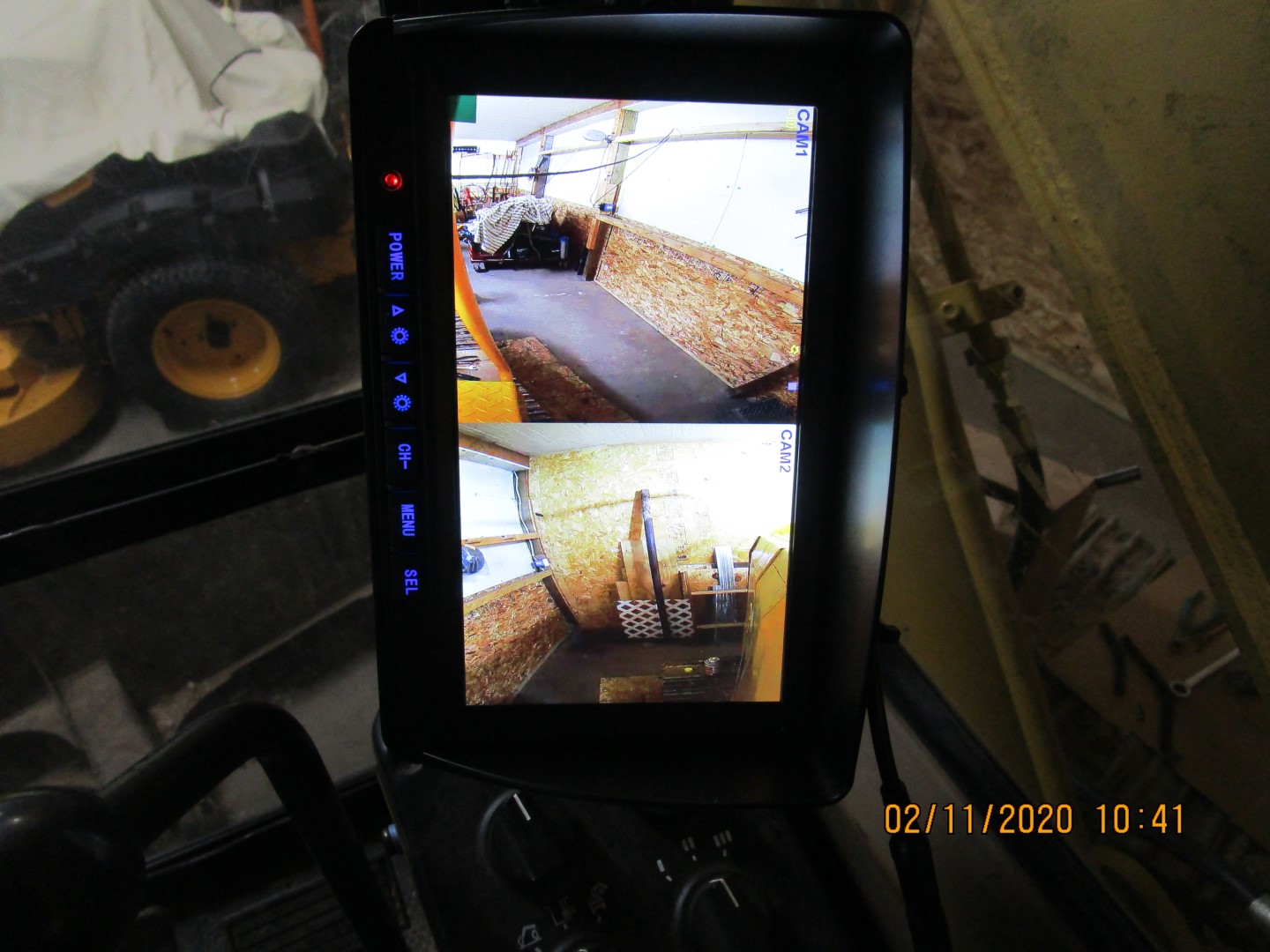

Cameras are actually a boot $60 a piece. With one camera, you have a full screen picture in high def. When you use two, you get a half sized picture from the one camera setup. If you show all four cameras, then you get 4 little pictures. You also have the option of pushing a button to scroll between each of the cameras. But I basically just wanted something to watch forward and rearward on that blind side. Most older excavators are all beat to heck. Partly because the OP looses touch of his clear work area, partly idiot OP, and maybe partly because he does not care. My barn doors are only 10' wide, and this unit is almost 8-1/2' wide, so it really helps in close quarters. I put a OEM like mirror on the driver side, and that sort of takes care of the left side. 4 cameras would work, but two is enough for what I need. I would like to stress that the new HD cameras are really a lot better than the old ones, even if they are more spensive.

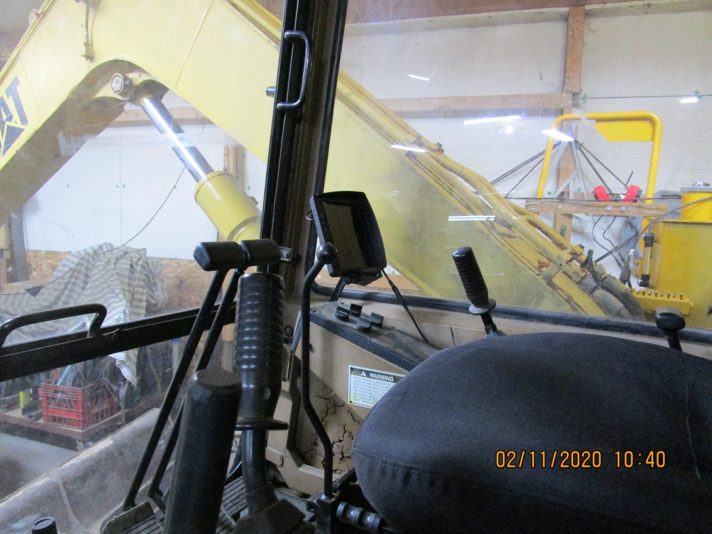

My 1080p cams are wired, I think that's more foolproof than wireless. I started to make a guard for the cams but the flat bar I was bending was too thick (I have a 50 ton press) for a guard - need to pick up some thinner stock. I have a fairly good idea of clearances when I'm operating but sometimes I get really close to an object and a cam would be really valuable. The real challenge is finding a good place for the monitor.
