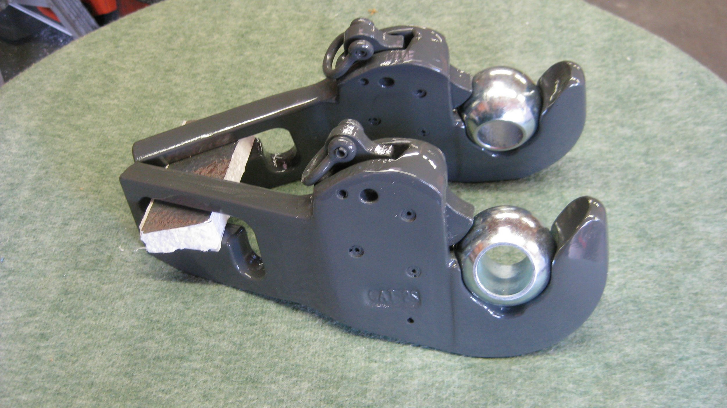

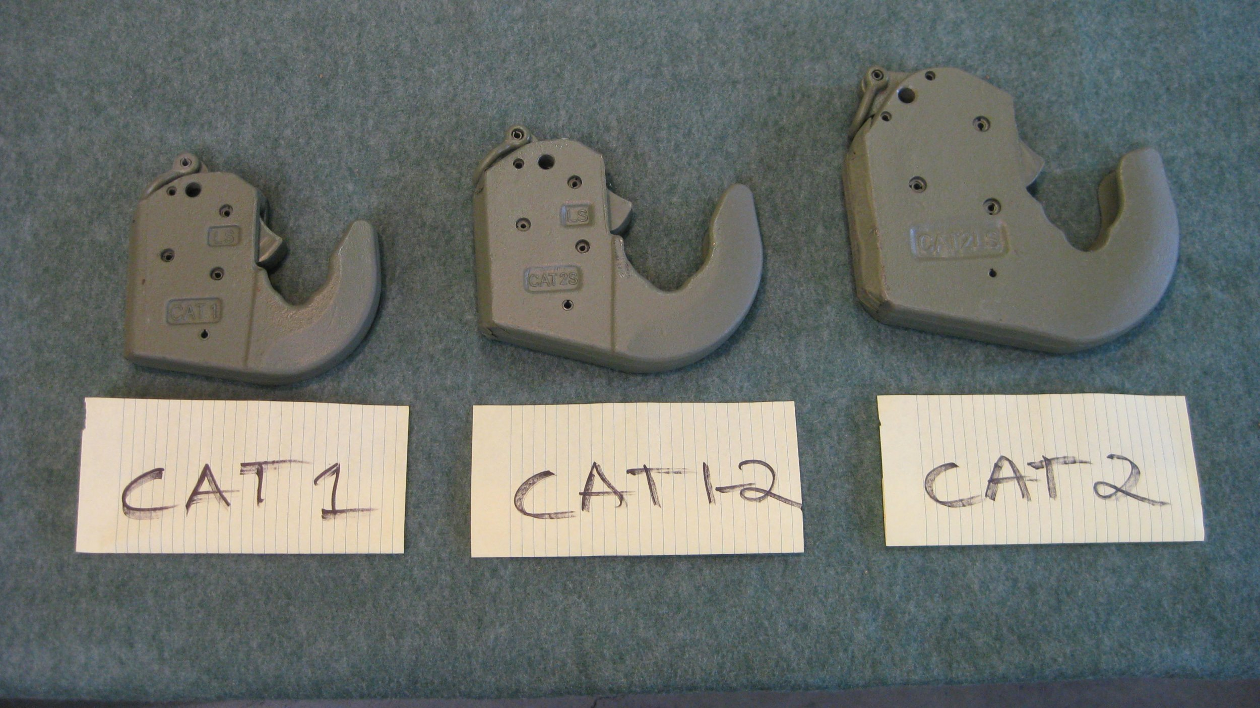

   / Upgrade Kioti DK6010SE 3-point Hitch #12
Pat's Easy Change. Same thing right?
Several issues with the Pat's system, they do not allow smooth articulation of the implements. Meaning when you tilt the implement side-side, the implement pin rides up on the edge of the Pat's hooks where as with the Euro hooks, there is a ball on the implement pin and it rotates and has 100% contact-support at all times.
The Pat's system adds 3 3/4" in length to the draft link.
The Euro hooks typically add 2 1/8" to the draft link length when the original ends are cut off at the weld joint.
The other issue is with the bolts that keep the Pat's hooks tight on the draft arms, there are many instances reported that they do not stay tight and that keeping them tight, even with lock tight is a constant issue.
If you do the research on them, you will find that the larger the tractor, the more issues there are. People with 35hp and down are generally happy with the Pat's system. But as the tractor size gets larger, that satisfaction wains.
Don't get me wrong, they definitely have their place in the market.
Lastly, the Pat's system provides either cat 1 or cat 2 ends.
The Euro hooks are available in straight cat 1 size, a cat 1-2 combo size , or a cat 2 size, which still accepts the cat 1-2 size balls but is generally to large for many cat 1 implements.

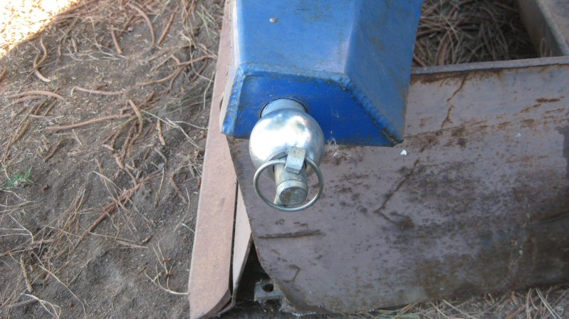

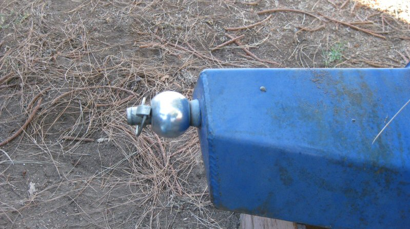

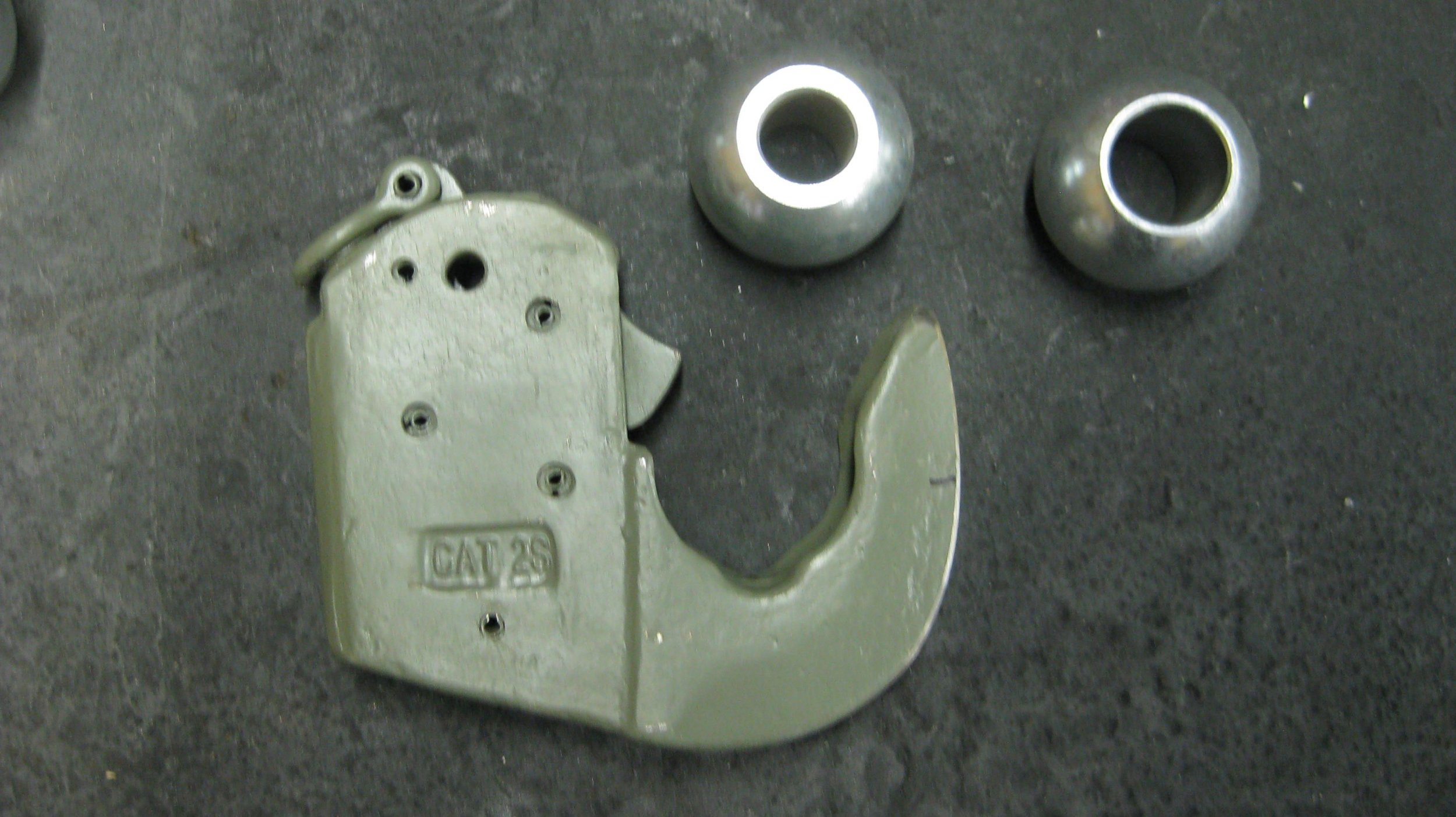

Thanks for the info. This is very helpful. Is there a particular go-to brand of these or a particular store to buy them from? The only potential issue I might have is....no welder or welding experience.
   / Upgrade Kioti DK6010SE 3-point Hitch #15
Typically it is either me (Fit Rite Hydraulics) or Agristore USA. AMA is based in Europe and is where these parts come from for both of us. We are both out of the cat 1-2 Euro hook ends. 😞
Hopefully we both will have parts in later next month.
Agristore sells the parts only, I will do the fabrication besides selling the hooks for less money.
I currently have a few customers that have paid for their ends and are waiting for me to notify them to ship the draft links, or extendable ends to me for fabrication.
Fill out the Fit Rite contact page to get an accurate quote. Best to make a count of implements to get a cost on implement balls needed also.:)

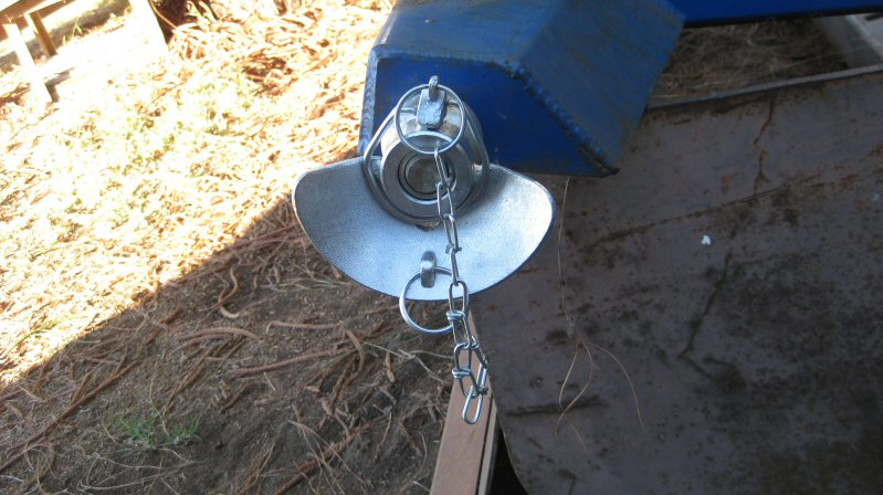

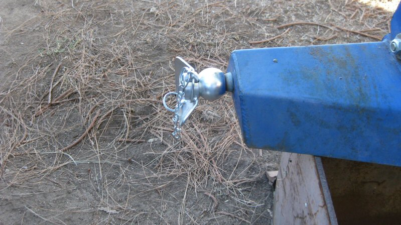

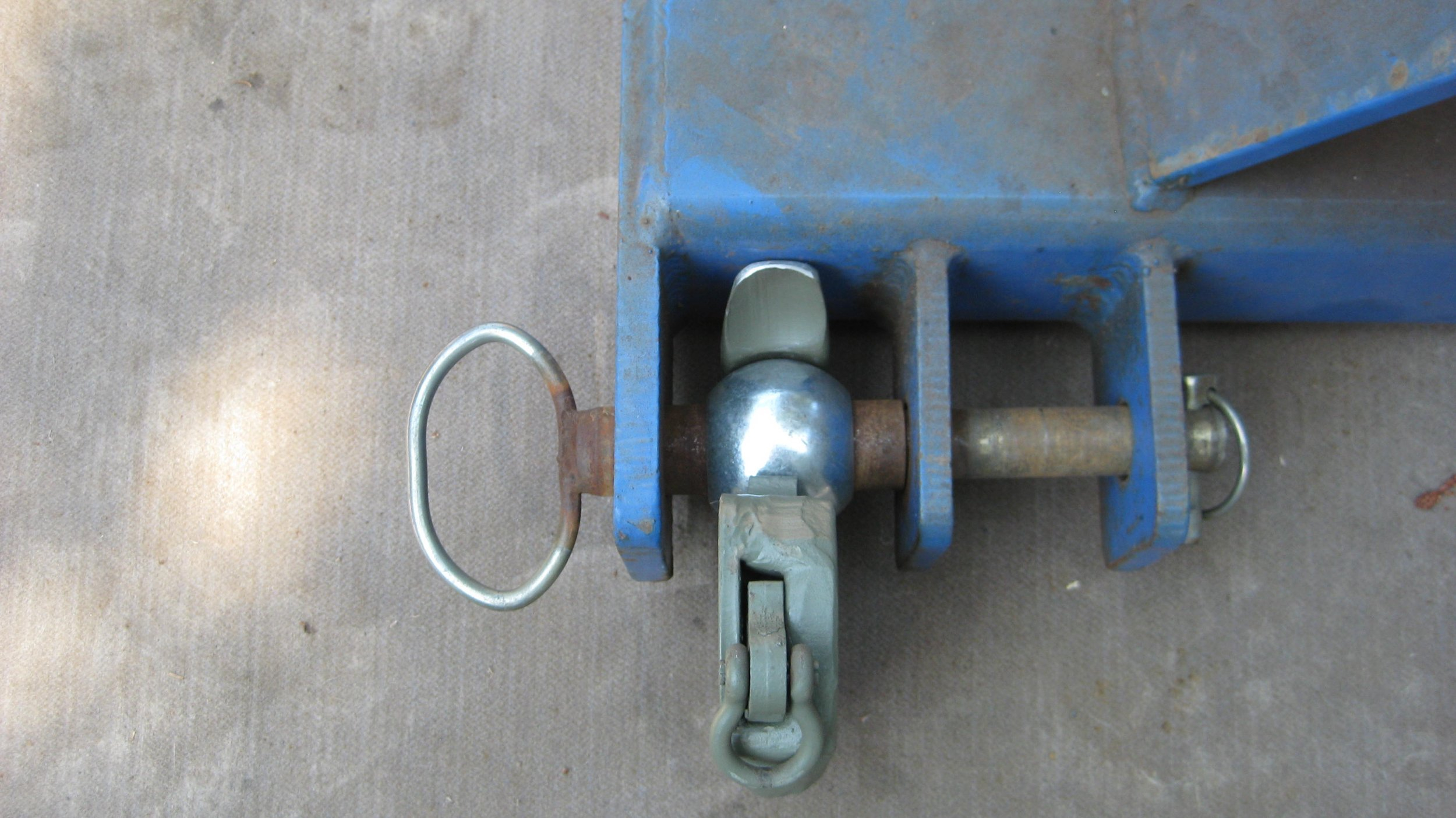

I took a closer at this image. Did you modify them to include the "L" slot?
   / Upgrade Kioti DK6010SE 3-point Hitch #19
As far as having them list on the website when they are in stock, no. I don't even have them listed on the website.
simply not enough time to do everything and the Euro hooks are way down the list as far as getting info about them on the website.
As far as the slots for the extendable draft link ends, these are simply reworked OEM extendable draft link ends that the customer sent me. In your case you would ship me the your draft links and I would rework the implement ends.
This is typically less than a 2 week turn around time. You ship the links to me on a Monday, I get them, rework them and return ship the following Monday.

Here is cat1
Only balls to attachments are different by hole diameter.
