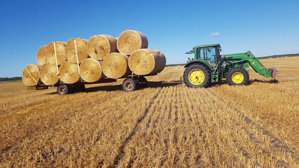

I own a JD 6430 and loading/unloading bales is real fun. The premium cab and upgraded hydraulics makes it really easy. Put buying a new comparable unit would be way off the limits.
If I were in your situation, I'd look at the Kioti PX series. I test drove one on the dealer's lot and I found it to be fair unit. Check out the dealer support in your area. IMG-20200829-WA0001.jpeg
If I were in your situation, I'd look at the Kioti PX series. I test drove one on the dealer's lot and I found it to be fair unit. Check out the dealer support in your area.View attachment 672813
I have never seen a PX in person, but they look like what I am looking for, IF they are reliable since they use urea to clean the exhaust gases. There is a local dealer for kioti that should at least be able to order a PX, but they don't seem to be many of them sold in this area. Yes, I want a JD6430 for 60% of the price. Seriously, the PX looks like it could fill the bill for the budget available.
