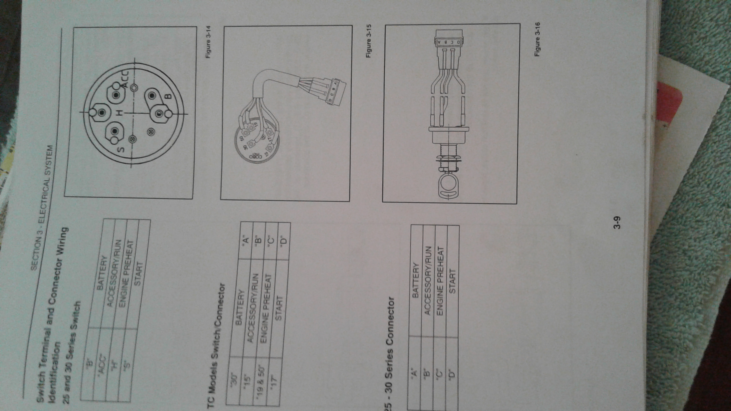

The starter switch seems to be a popular topic on these boards and mine is not working either.
I was wondering if anyone had any experience with either replacing the OEM ignition switch with a third party that was more solid, or perhaps modified it with a push button starter. The OEM switches are incredibly overpriced junk. I had mine replaced and at one point ended up putting an SS hose clamp around it so it would not vibrate apart. Pretty sorry for almost $70.
Here is a wiring diagram for the switch. I'm having a starting problem as well. I removed the starter/solenoid and took it to a battery shop; it checked out. Fuses are good. Battery is good. Relays are fairly new. I believe the other safety switches to be good.

I bought a switch that worked for my 1700 on ebay. It was about the same price as I remember. Changing to a push button is probably a waste of time and money because the switch has to run the dash, preheater starter and the heater while the starter is turning. I opened up my old switch and there are four different contact points that have to make a good contact to preform all the functions of the switch. I recommend a same type of switch replacement. It could be an after market one though instead of a New Holland brand. I posted a picture of the inside of my switch in the 1700 forum a couple years ago.

My tractor is a 1700 from around 1981. The ignition switch went bad and I replaced it with one bought on ebay. I took a hacksaw to the old switch and cut it in half to see why it quit working. This is a picture of both sides of the switch after cutting it apart. (correct picture will post later)
Numbers from wiring diagram above: #30 hot wire from battery is always "hot". #15 "ACC" is hot in all positions except "off". #17 starter and #50 glo-plugs are hot in start position. #19 goes to preheat only.
