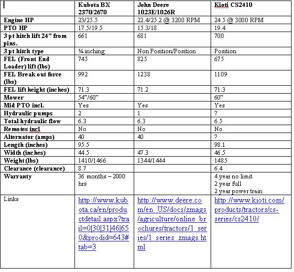

Your main goal is to save time on mowing and snow removal. I don't think any SCUT is going to save you a significant amount of time cutting grass. A ZTR or other commercial mower will cut mowing time down to roughly 1/3 of the time it's currently taking. If you don't have any other tasks that require a FEL, PTO and 3pt hitch, I'd keep the JD lawn tractor and put a snowblower attachment on it, that set up works very well and isn't overly pricey and I'd get a good used commercial ZTR or mower for the grass.
If you have other jobs for a tractor or you're convinced it's the way you want to go, I'd say I'm not a big fan of the 1/4" valve on the Kubota 3pt hitch, JD 1026R is a really nice SCUT with some great options, but really spendy, and the Kioti CS2410 seems like a good little tractor at a good price.
Here's a little comparison I put together for a friend of mine.
<img src="http://www.tractorbynet.com/forums/attachment.php?attachmentid=324738"/>
I guess I never paid attention but it is surprising to see a higher fel capacity than 3-point on those small tractors
