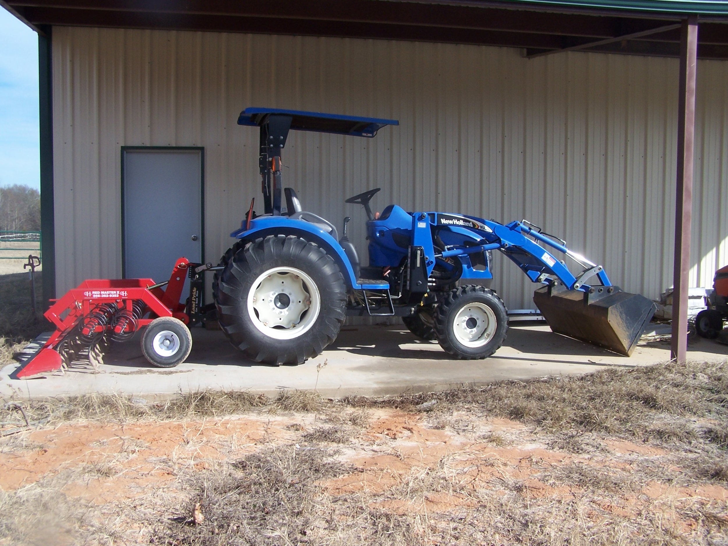

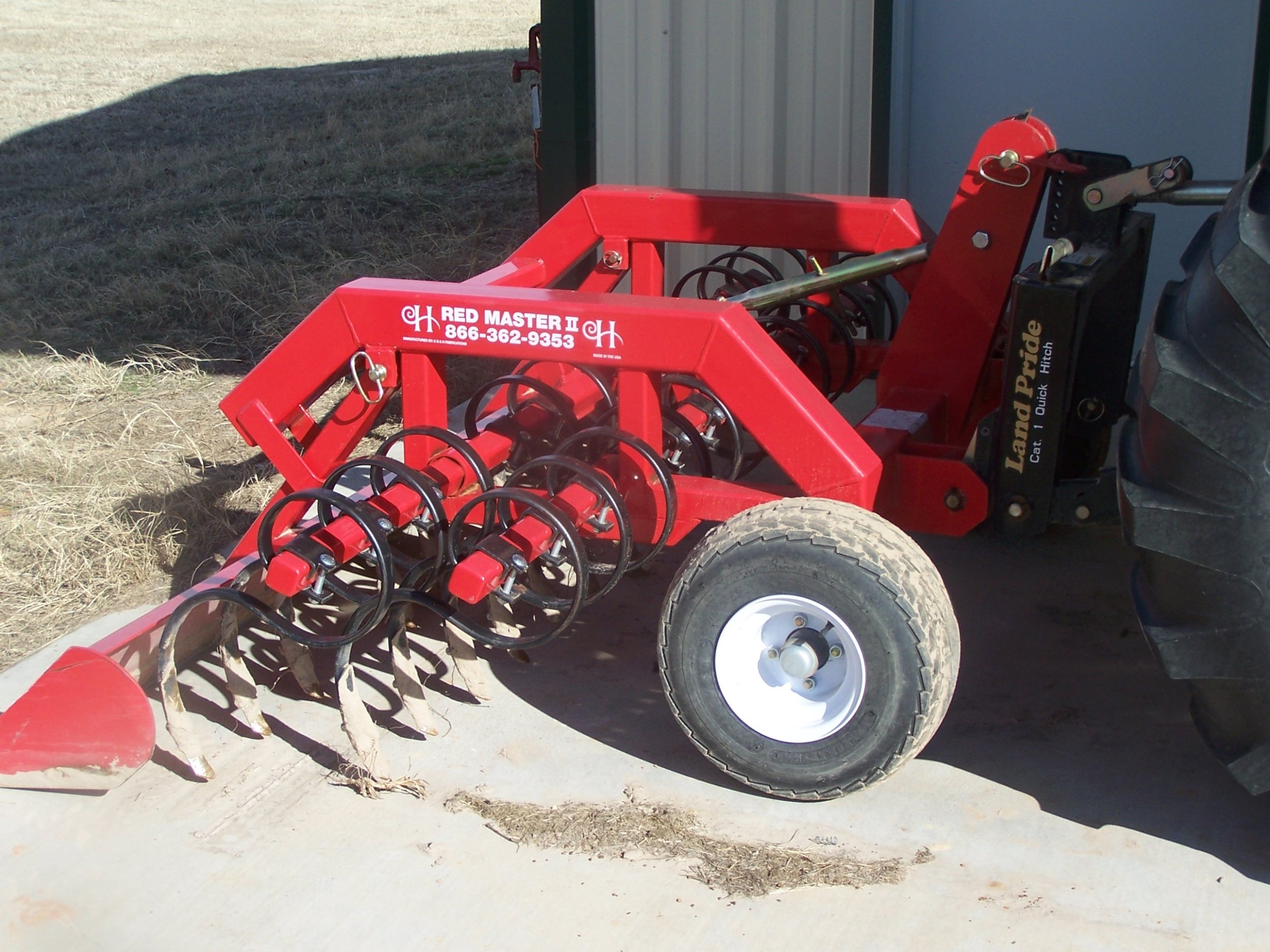

We use an 8' Red Master II harrow for our dressage arena. They make a roller that can be interchanged for the rear blade but we don't need the fluff it provides. We pull it with the NH TC40DA 40HP HST.
Funny, thats the same tractor(TC40a actually) I am replacing. I inheritted it when i purchased the farm next door. It pulls great, but cosmetically was treated very very poorly. Fenders are trashed, hood is so smashed up it just bounces around, bucket rotted out, every light busted, etc. We produce horse shows at our farm, I didnt feel comfortable relying on this tractor to do the job without the chance of a breakdown.
How do you like the Redmaster Harrow? A local farm was selling one set up for synthetic, and I was contemplating getting a price from the manufacture to purchase the S-tines and grader to convert it over to a sand arena drag.
   / Upgrading tractor for dragging horseback riding arenas #46
We like it. We were glad we went with the grader blade. Considered getting the roller but didn't need the fluff, wanted the smoother surface. With the 8' model making tight turns in the dressage arena will leave a little windrow of dirt at the end due to the end wings on the blade going sideways. The roller probably wouldn't do that.
