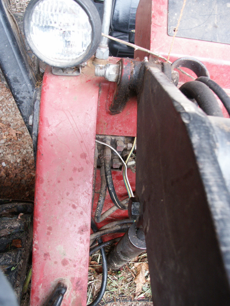

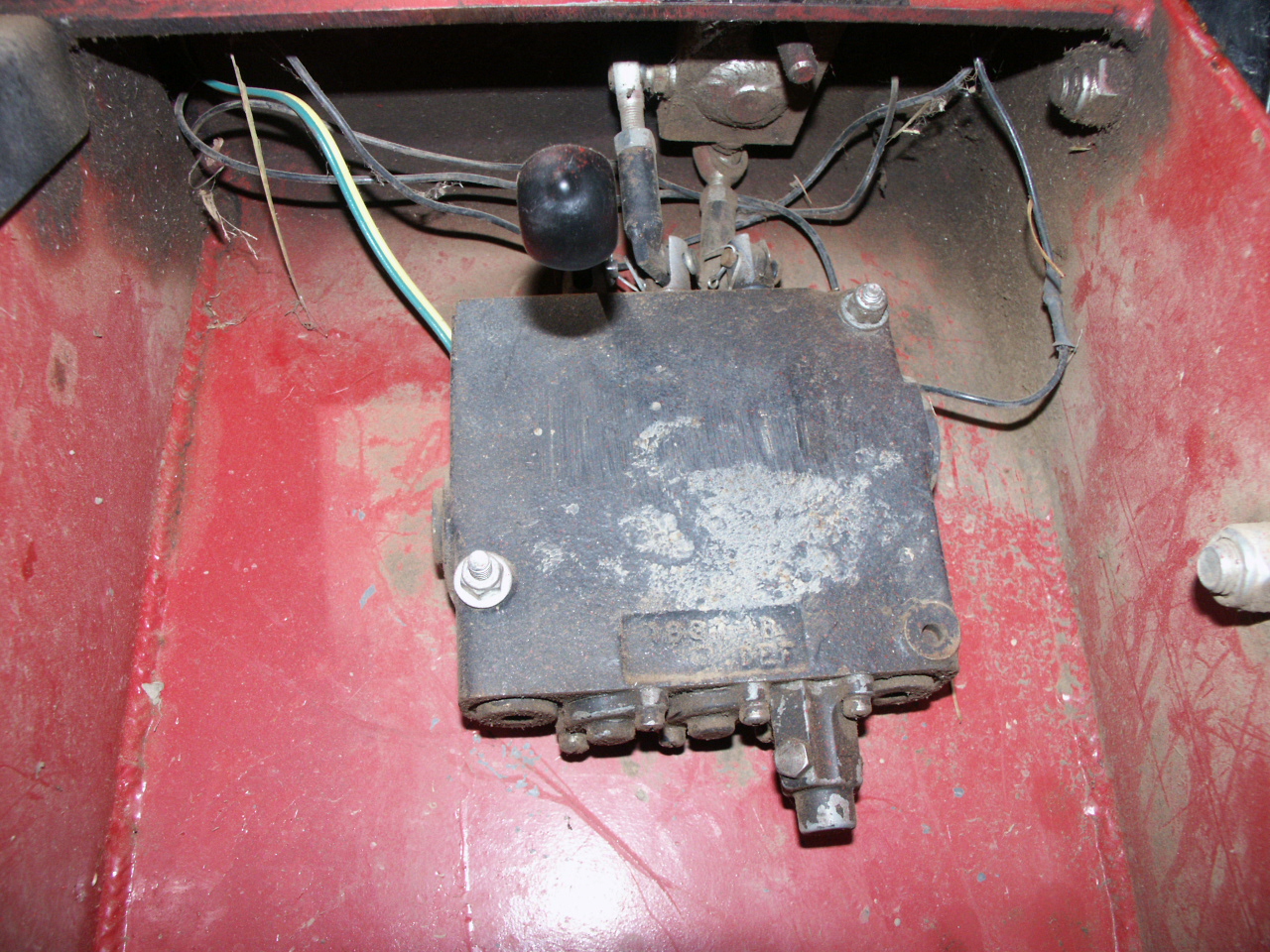

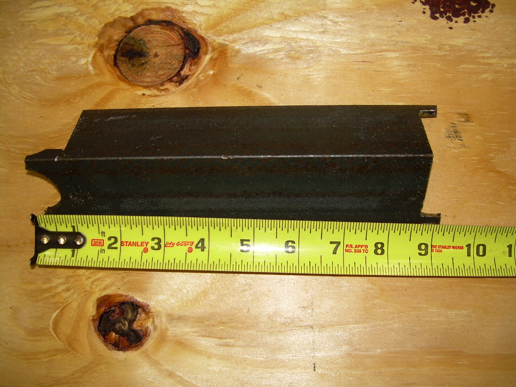

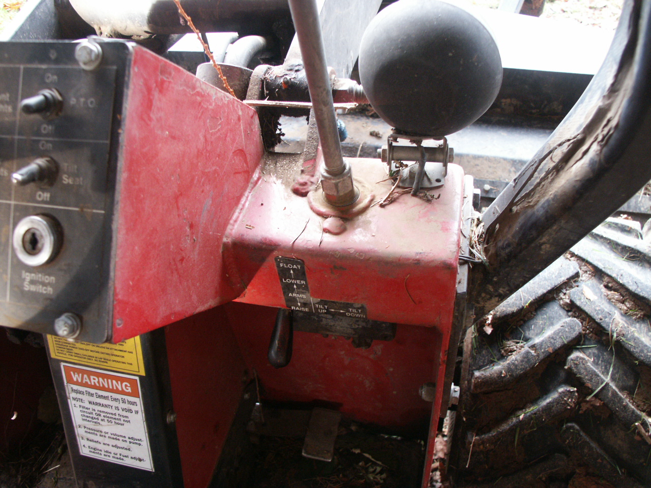

Just FYI, the leak down does not really cause me any problems. Using the PT as a man lift seems a little to dangerous for my taste, other than for say less than a minute. I would say as a minimum use some kind of mechanical cylinder block that cannot be removed while there is weight on it. I have attached pictures of mine. Please note, I did not do this for a manlift, but to work under. Edit: Of course working under it is just as dangerous. But I think using two of these brackets, one for each lift cylinder, would be reasonably safe.
