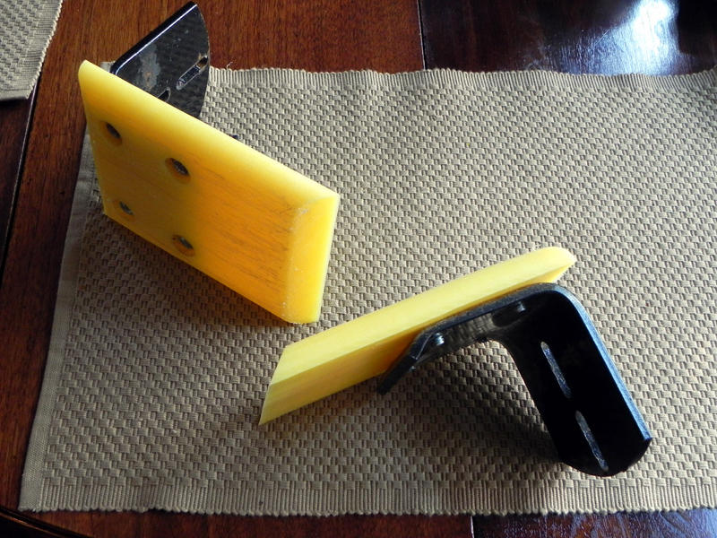

I made non-marking skid shoes for my B2782B blower using 3/4" thick UHMW. Made new steel mounts as I didn't want to modify the originals. UHMW is mounted using countersunk 1/4-20 bolts. Skid footprint is larger than original.

My driveways and my road are gravel and I sheared a lot of pins before adding these UHMW skids to my BX2750D blower. I had the material but it can be purchased at places like McMaster-Carr. While I didn't change my cutting edge I think it would work fine there also. It works like wood and is very abrasion resistant.

I made those skids for 2 reasons. I wanted to put some distance between the rocks and cutting edge so I would shear fewer bolts and because no matter what I did to the OEM shoes the adjustment would change on me. So by making these and having them go beyond the cutting edge, the distance between the cutting edge and ground (in this case 5/8") would always be the same. Your shoe adjustment may work better than mine did so it may not be an issue for you anyway, especially if all of your blowing is on pavement. If it is, I wouldn't bother with it.
